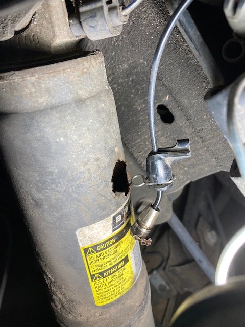

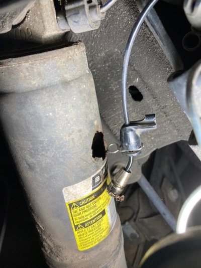

Any suggestions?...The air port came off the old shock and the line won't come out of the port...

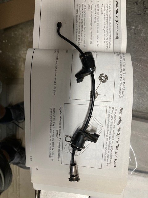

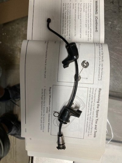

I managed to disconnect the hose at the compressor. I then put the end with the broken port in boiling water for a few minutes and was able to pull the port off the hose. The hose is clogged though. I tried running fishing line through it and couldn't get it to go more than 1/4" into the hose(both ends). Also the compressor is spitting out rust water when it kicks on now. So...I don't have high hopes for the compressor or the air lines.
That sucks but good thing you noticed before you replaced the shocks!
10,564
15,346
Replace the compressor and air lines, and you'll be back in business.
