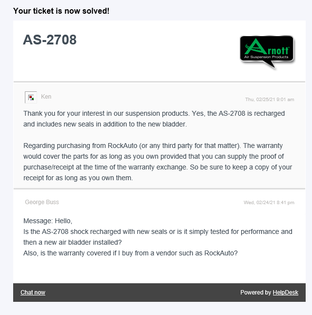

Thats just really weird... All they do with the rebuilt units, from what I was told by Arnott, is verify the function of the shock itself, make sure it meets factory specs, paint it, and replace the bladder. Maybe they are actually rebuilding the internal valving, and oils.. If so, the price they are selling them is a huge savings!

When did you get yours? I called and talked to them February 2021 and they indicated that they were rebuilding them with new seals and bladders. When mine came I could see that they had blasted and painted the body of the shock but they had a new rod end and connector as well as a new bladder and plastic bladder cap. Here is what they told me via email and that backs up a phone call I had with them.
https://www.tahoeyukonforum.com/attachments/upload_2021-2-25_11-0-11-png.271811/
