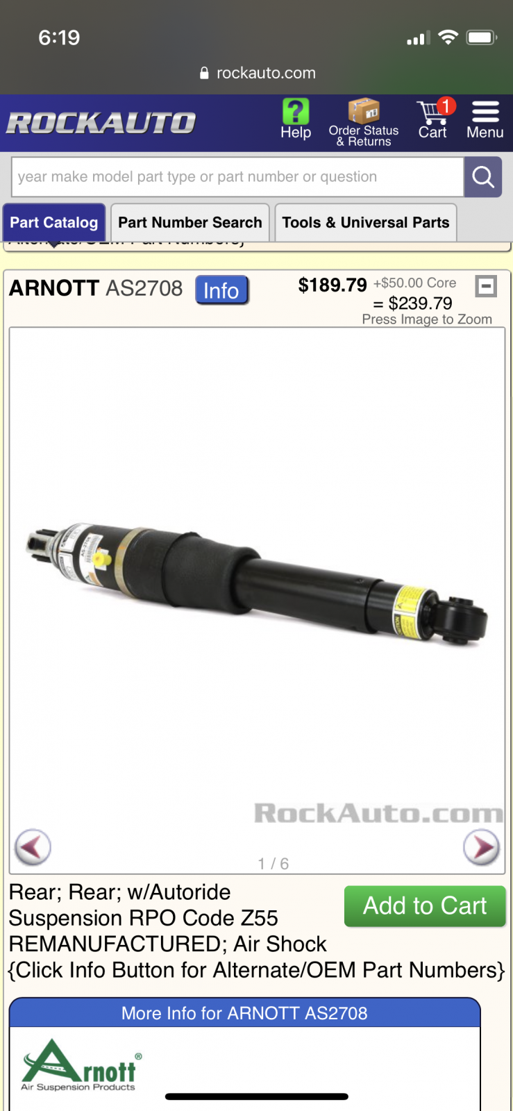

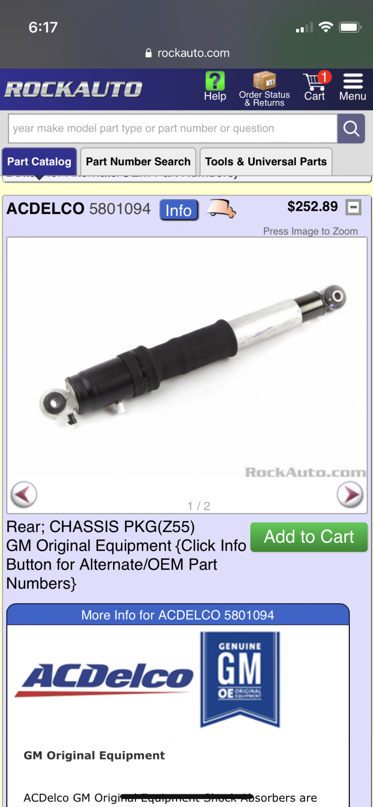

If you plan to keep this truck, buy the OEM shocks. I'm in the minority here that thinks Arnott is not good quality but I've seen some of them fail in ways that the OEM shocks cannot fail. Some of the shocks aren't attached properly at the top and any time the truck is lifted the airbag doesn't move and it'll rip the connectors out of the shocks and damage them. Looking at Rock Auto the OEM shocks don't even cost that much more than their rebuild shocks which all they do is replace the airbag and don't do anything with the internals. Spend $100 more and get a completely new shock.

Arnott has a lifetime warranty, so it probably doesn't matter to some. It's not like the rear shocks are hard to replace and take hours to do them if one needs to be replaced.
George B's email from Arnott in post #15 above says that there is more done than just replacing the air bladder.

Still, if a whole brand new shock is only ~$50 a side, why even bother? They’ll last another 10 years.
Looks like now the OE shocks are $63.10 each more expensive than the Arnott units.

I guess it all depends on if you want to spend $380 or $500 on a set of rear shocks. They both have lifetime warranties

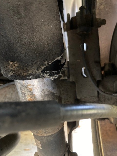

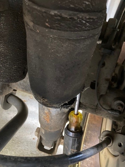

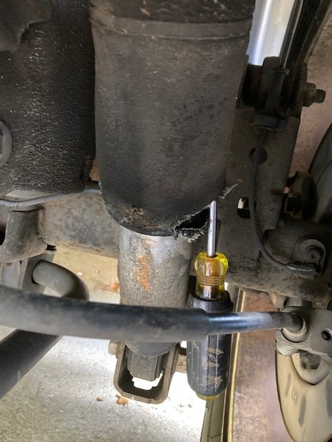

Thanks. Good to know I won't have to do the re-calibration. I had the truck parked so it was leaning a bit(my driveway isn't level) and the passenger shock was extended. See below. I think this verifies that this shock is shot!
