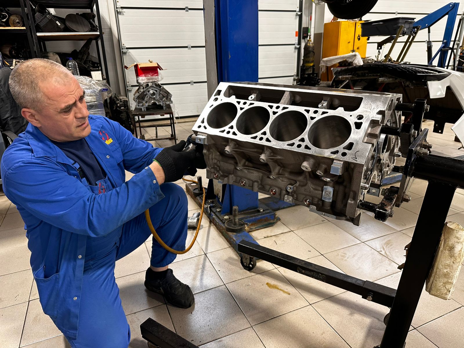

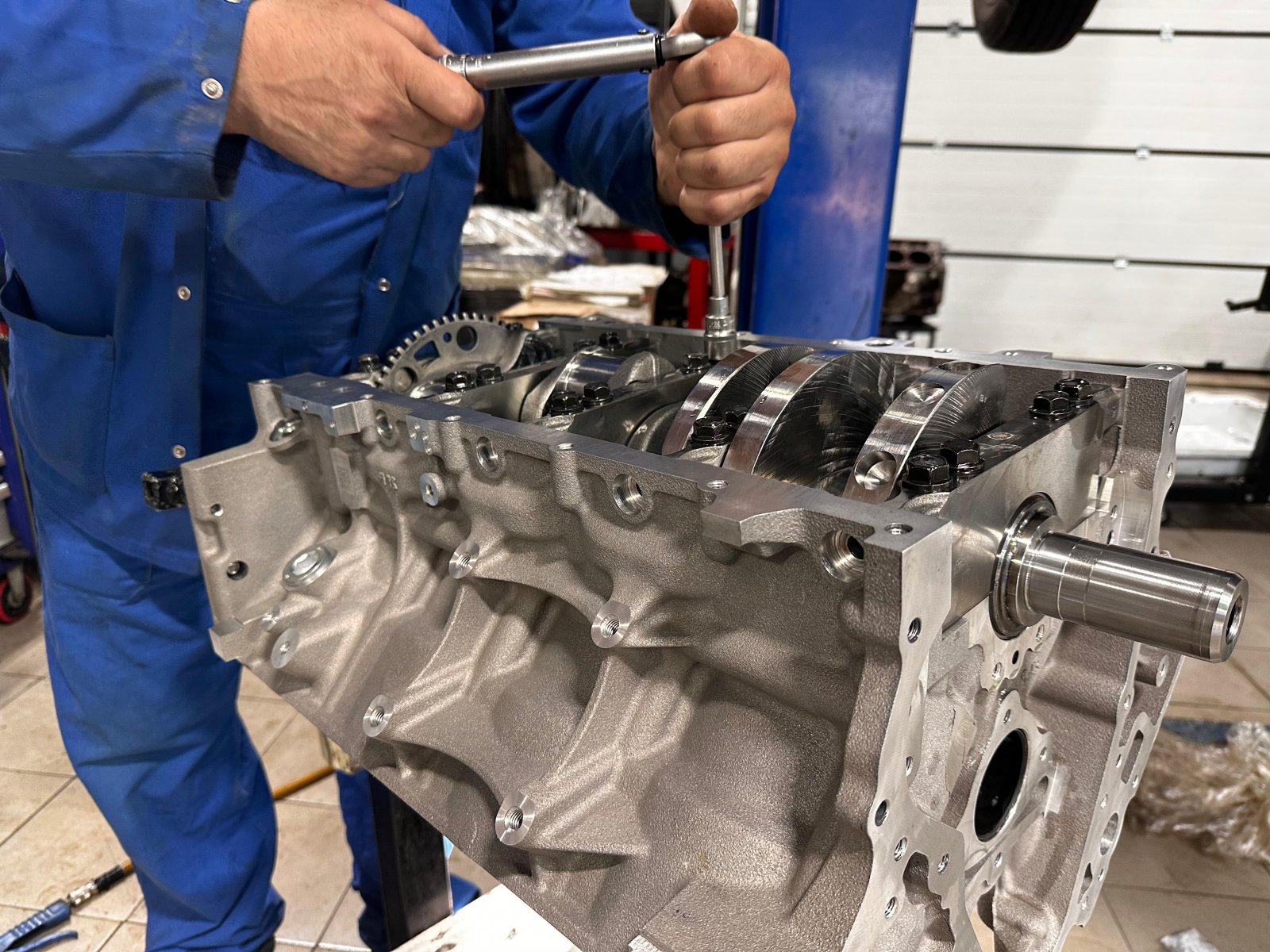

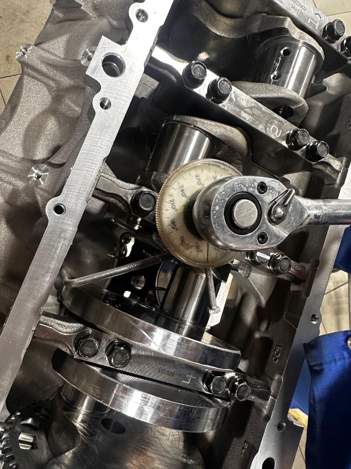

A new day has come, the engine has come from processing, now they have begun to assemble it, having previously replaced the liners with red ones from the 4th generation, checking the gaps and observing the standards for tightening the joints.
