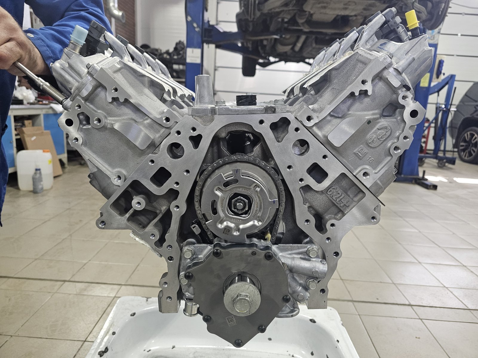

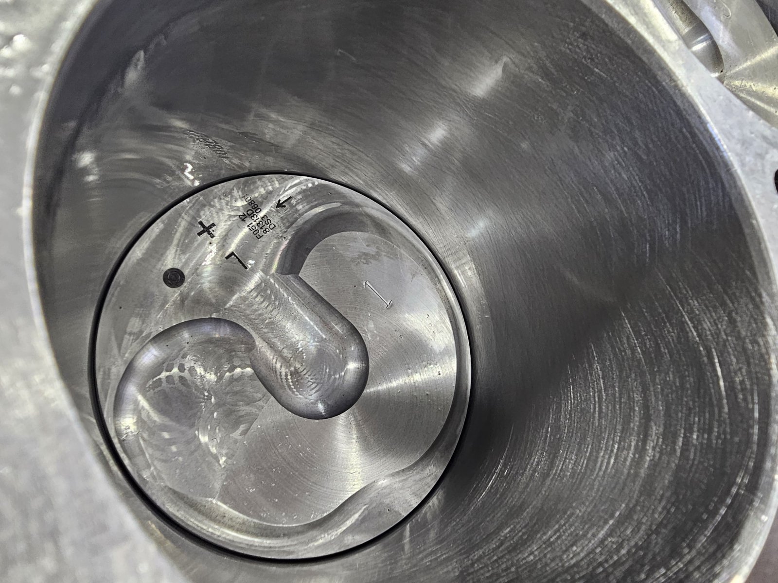

Well, are you ready for new horrors?))) The oil is to blame?) or fuel pollution?)) My new engine was disassembled, and there was this. Its mileage is 0 miles

No, the recall action will concern the repair or replacement of the engine, and the transfer to 0-40 oil is just so that the cars reach the end of the warranty. But, just today we discussed with the service that the transition to 5-30 or 0-40 oil puts the lifters out of order, as it was on the 6.2 of the last generation on a mileage of 90-100 thousand miles

I believe that the reason is not in the oil or liners. The reason is something else, which makes the engine work without oil at all. Some kind of error, or a malfunction of some sensor. And in these conditions, it does not matter what kind of oil it will be 0-20, 0-40 or 75-90

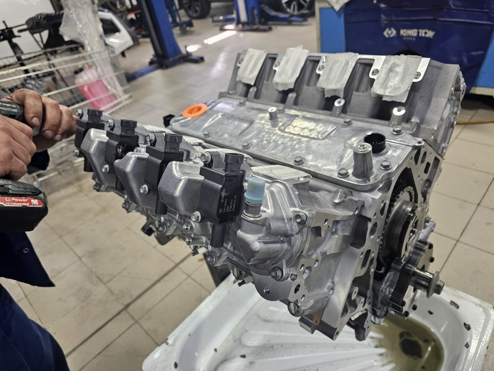

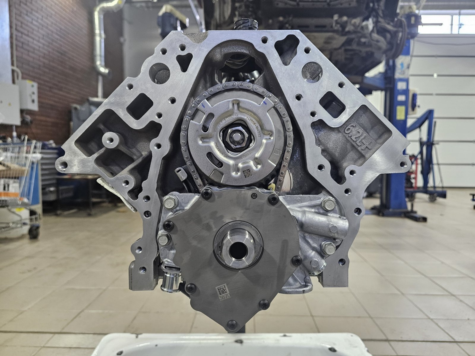

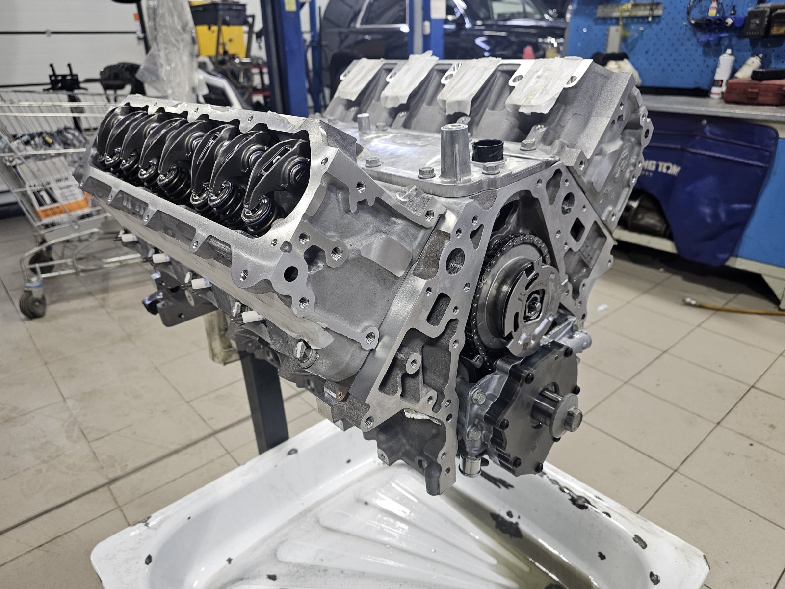

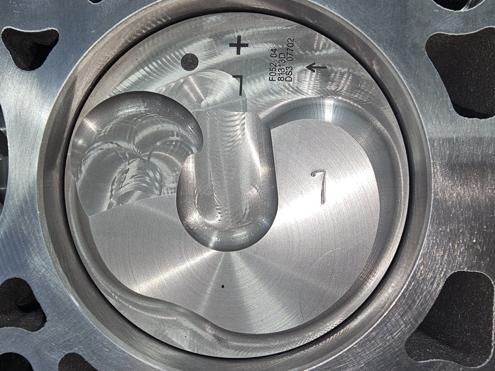

No, we have already moved over this engine, the main defect is small temperature gaps. With a norm of 0.048, they are actually 0.02-0.03. The piston jams in the cylinder. And the connecting rod liners simply take on shock loads and fail
Ah. So bearings too tight? Just don’t want to see your engine go down again when you might be able to avoid it by fixing now while engine open. Looks like you have really good mechanics though. Thanks for sharing and keep the pictures coming! Really helpful.

I don't know if they will handle old engines. In our experience, 9 engines out of 10 need to be improved, such as we are doing with my new engine

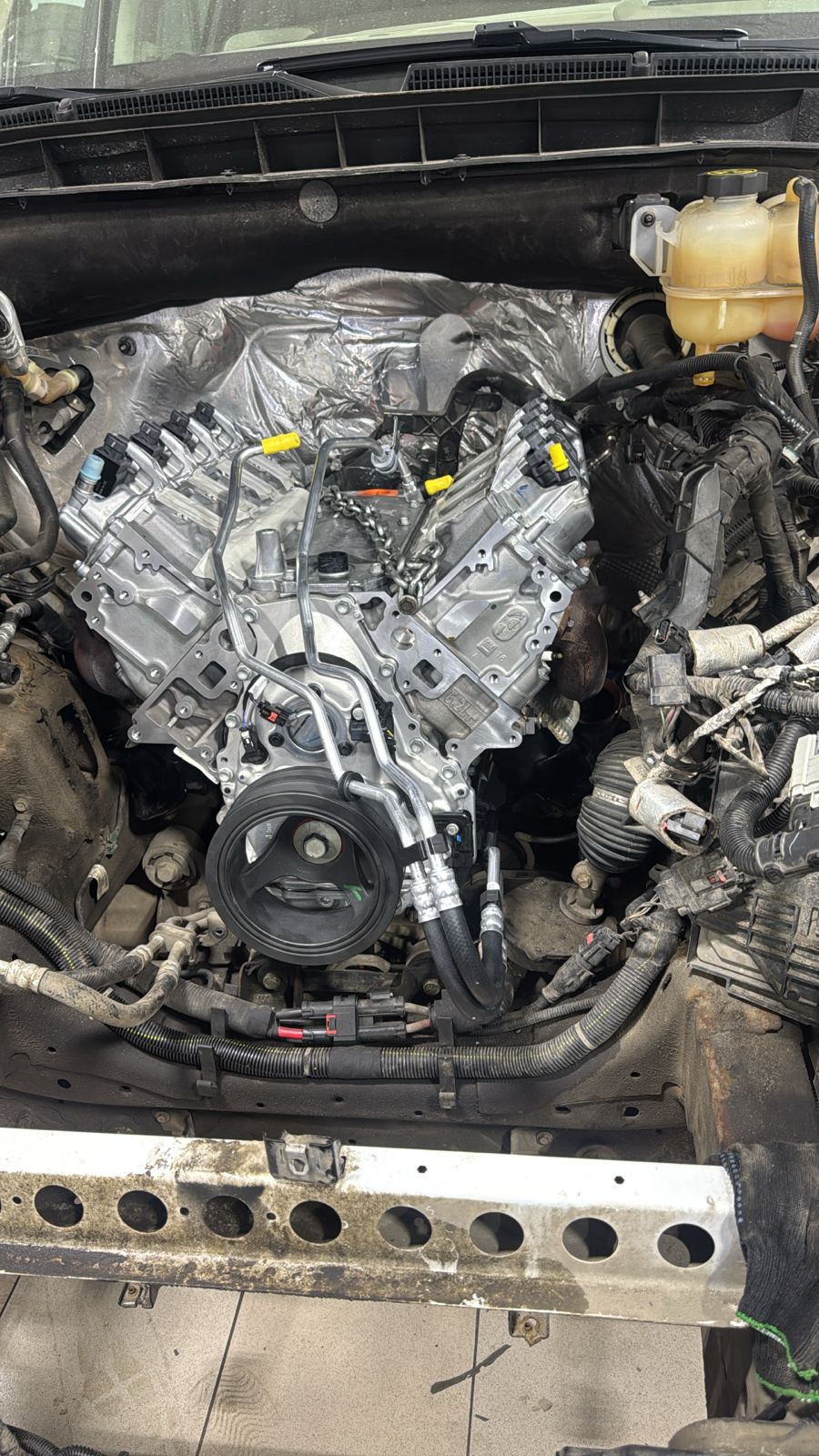

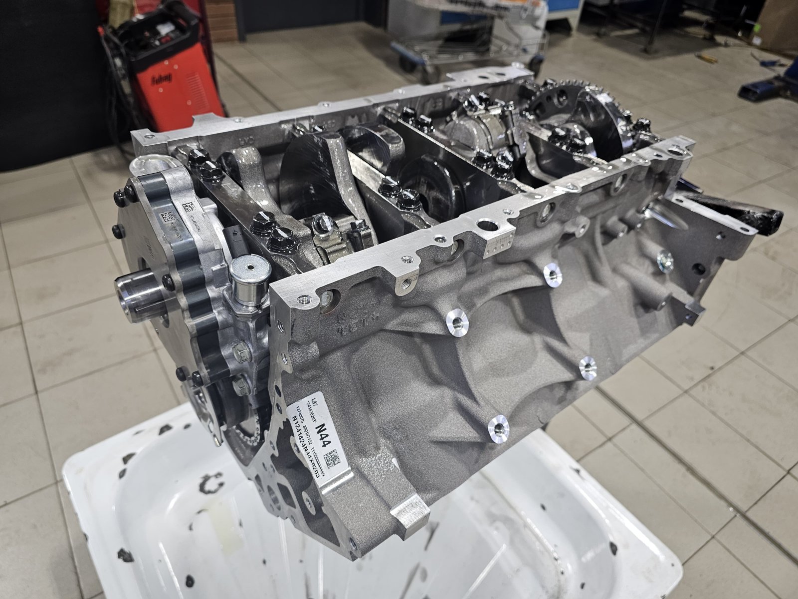

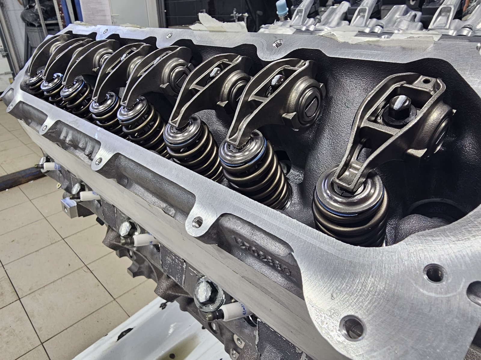

The next day, the engine was assembled and installed in the engine compartment.

And more
