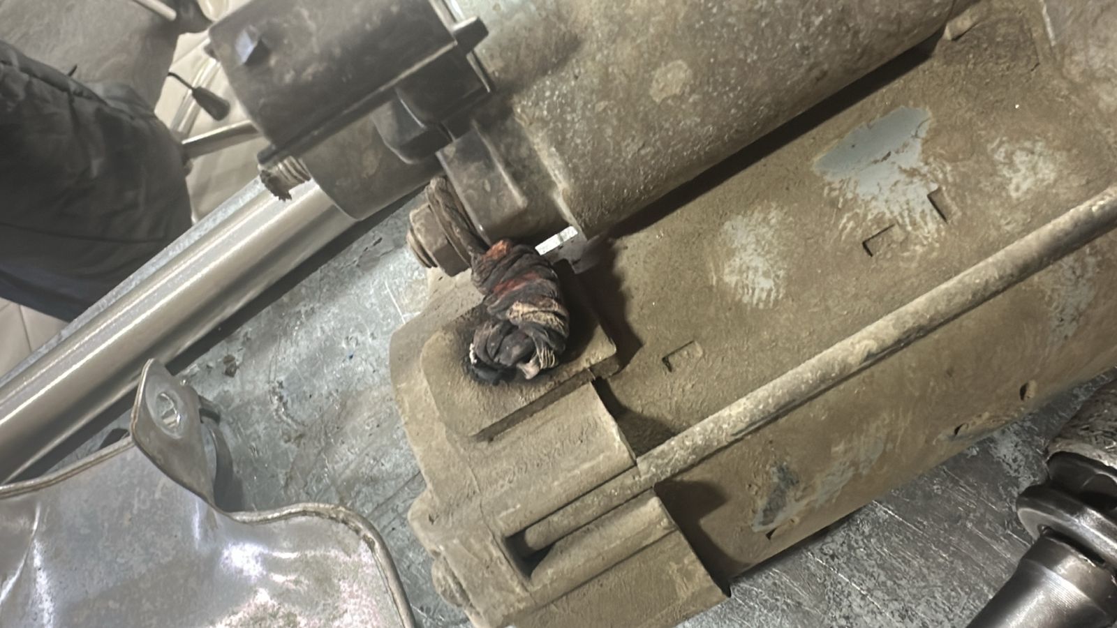

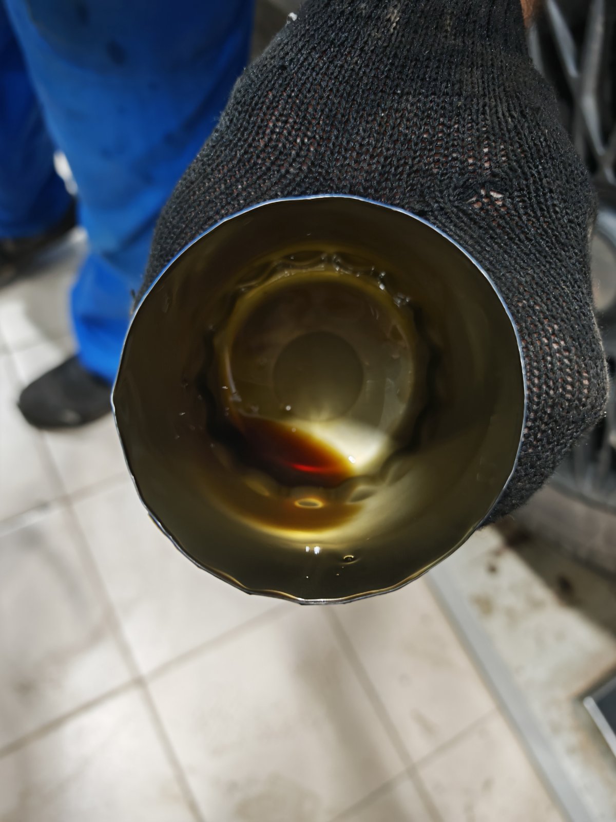

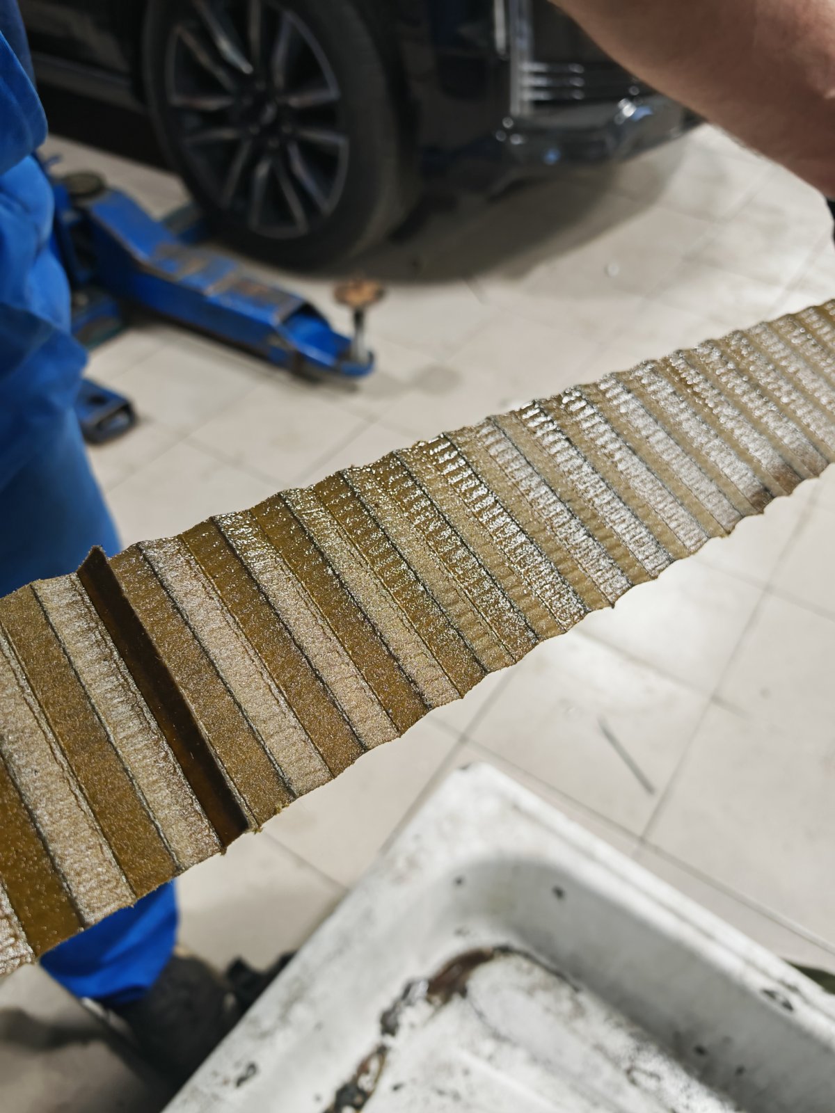

So my epic has come to an end. Yesterday the car was assembled, replacing the alternator belt, and the starter. The alternator belt is already badly worn, and I burned the starter when I tried to start the engine. Today the service has been testing the car and its settings all day. As a result, tonight I was given a car with a new engine. I immediately noticed how soft and quiet it worked. Now there are about 1000 km of break-in ahead, after which we will change the oil, cut the filter, and I hope everything will be fine there.
It took 10 days from the moment my engine broke down to the moment I was given a car with a new engine.
Impressive turnaround time.

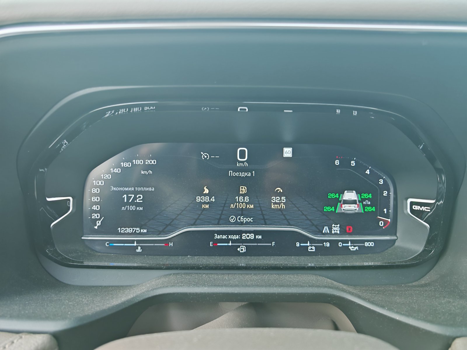

Hello everyone. Who is following my story :) And so in a week I drove about 700 miles, following all the recommendations of the service, about the running-in mode. During the run-in, Mobile 0-40 oil was poured. What I immediately noticed was the high pressure, which was clearly higher than what I had on my previous engine. We have a metric measurement system. If the full scale is 800 kPa, then the middle scale is 400 kPa. So, in my opinion, the oil pressure on the new engine is about 250-270 kPa.

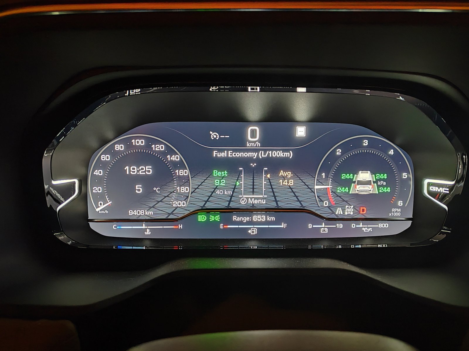

Next, I started looking for my old dashboard photos, where the oil pressure scale is visible. Here, on a run of 74 thousand miles, it would seem much lower than my current pressure, in my opinion it is about 160-170 kPa, and I found a photo from a run of about 5.5 thousand miles, the pressure there is the same as on 74 thousand miles. I asked the service, they confirmed that this is a normal pressure at idle and the engine is warmed up, about 170 kPa.

I drove 700 miles on 0-40 oil during the run-in, after which I filled 0-20. It seems that the version that it is necessary to pour oil 0-40 is confirmed, at 0-40 the pressure is high, and at 0-20 it is about twice as low. Do the photos confirm this? :) But no, fans of this movie, :) it's not that simple) after running in, I filled in exactly the same oil that I used to drive 75,000 miles on my previous engine, this is the oil from the Belgian company Wolf 0-20 dexos. Why did I fill in 0-20 anyway? I talked to the Service that made this engine for me. Everyone they made an engine for runs on 0-20 oil, and the mileage on the new engine is already high. So, they poured 0-20 oil on me, I rode a little, warmed up, drove along a small section of the highway at a speed of 70-80 miles per hour, and that's what my oil pressure is 0-20. Wonders. it is about 300 kPa. I'll even post a photo of the oil pressure 0-40 and 0-20 next to it))) at 0-20 it's just a little lower. well, about 300 kPa at 0-20 and maybe 320 kPa at 0-40. My opinion is that either the software has changed and GM has increased the oil pressure, or this is a new modification of the oil pump. But oil has practically no effect on pressure. The pressure on my new engine is clearly higher than on the previous one.
