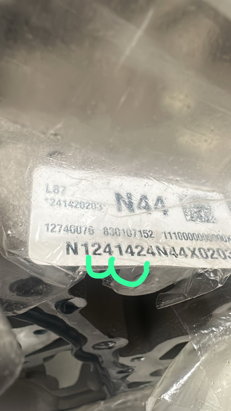

We sent the engine production date, May 2024. We almost made it to the 183rd day of 2024) but we talked to the supplier in the USA. Engines after the 183rd day of 2024 are not on free sale, most likely this is due to a shortage due to the recall

I’m a 135 and have not heard anything from the app or vin search.

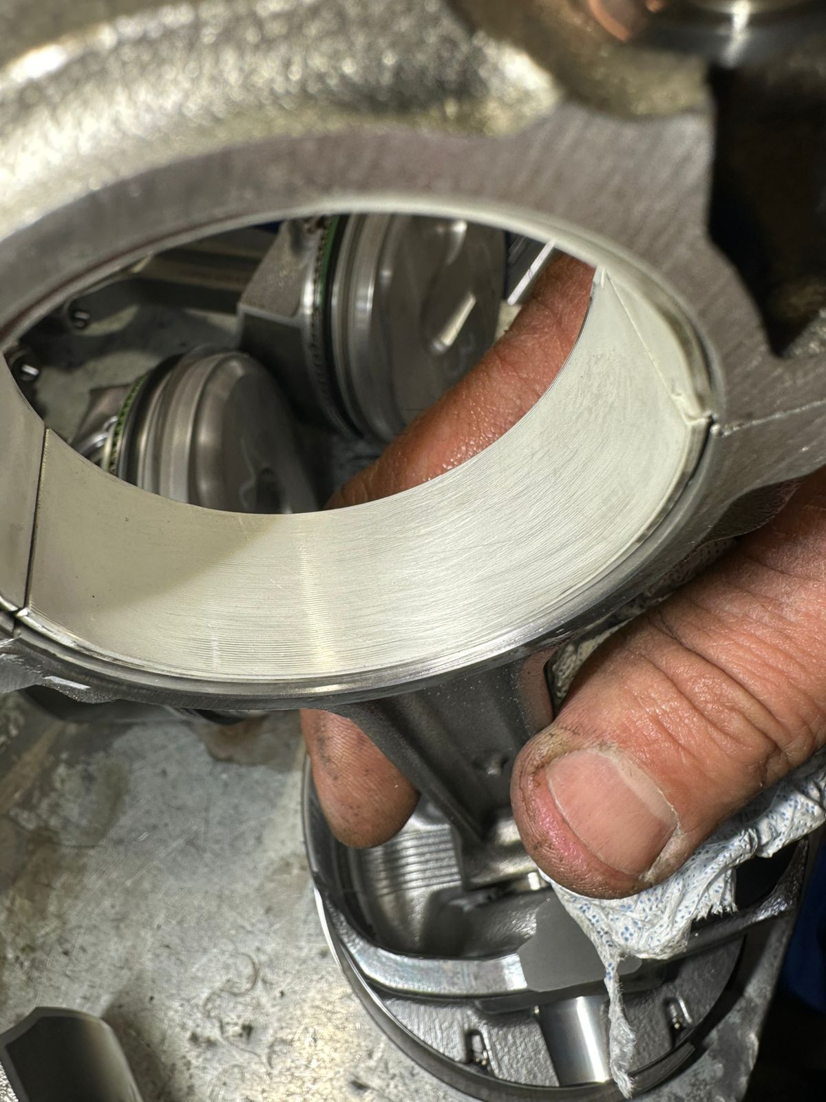

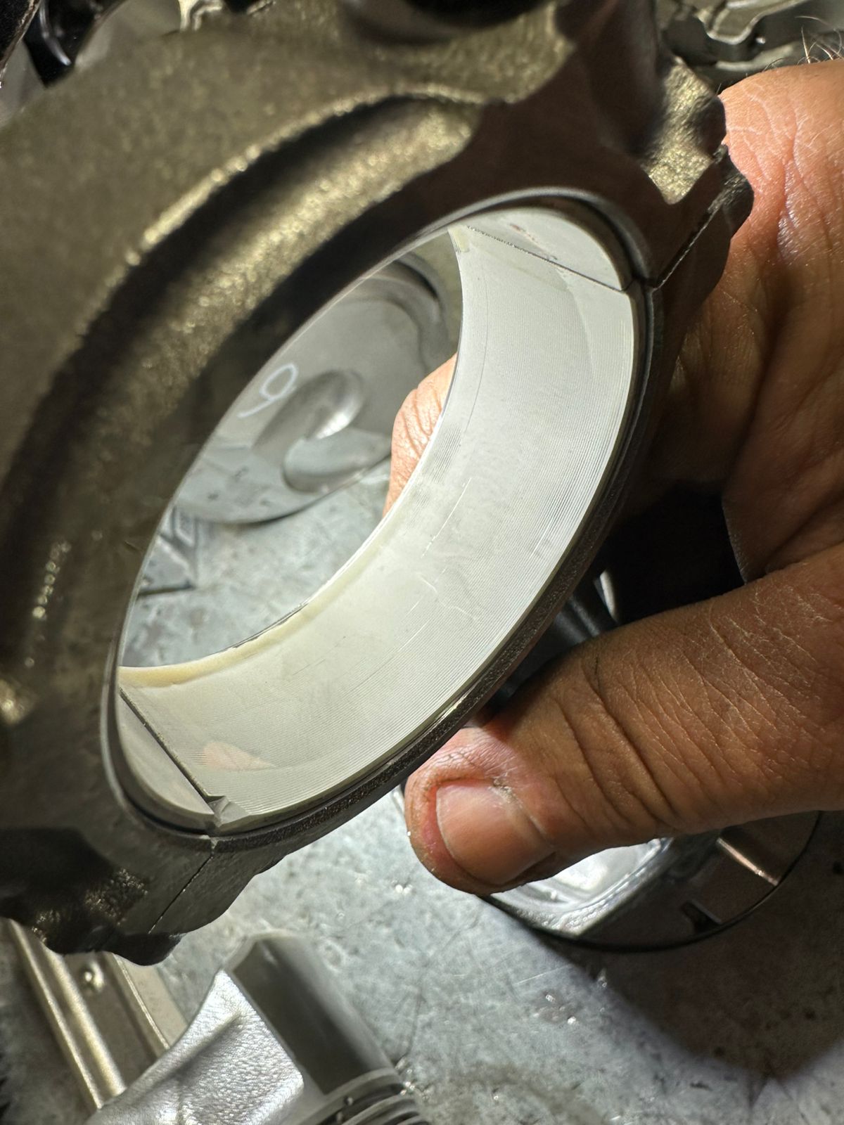

Then your engine is most likely assembled as crookedly as my new one, the photo of which I posted

No, we do not change the crankshaft and connecting rods. Our craftsmen sharpen the gaps, bringing them to the GM standard. The crankshaft will be ground because it already has signs of wear. Connecting rod liners from the 5th generation, changed to red from the 4th generation
