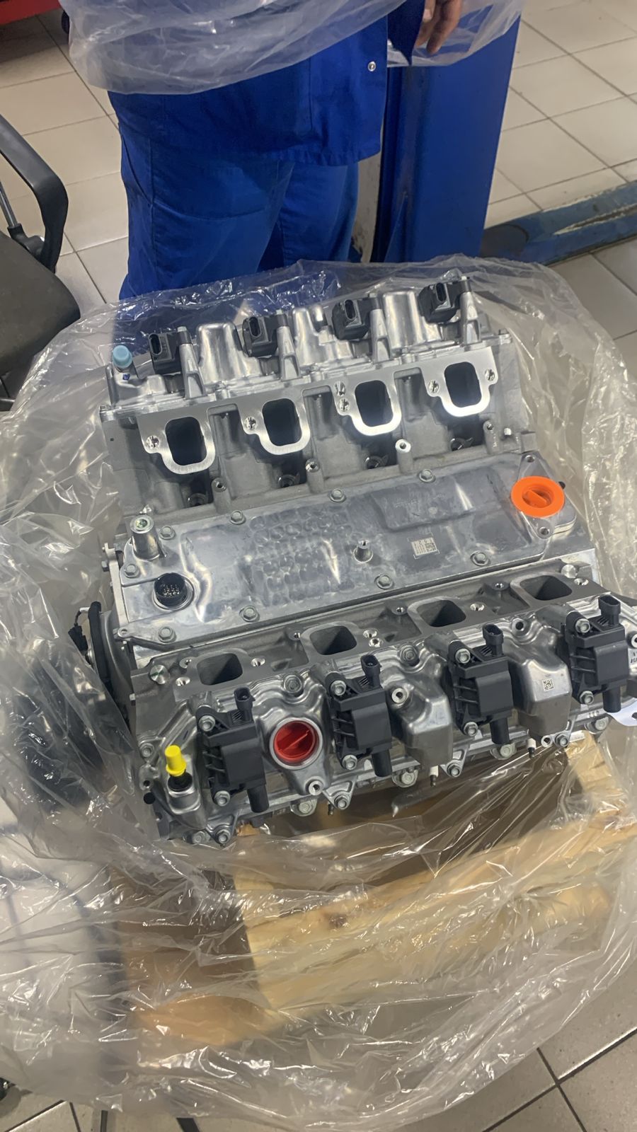

As a result, after discussing different options with the service, we came to the conclusion that it is best to install a new engine. But the engine will be disassembled, and the temperature gaps will be checked, plus the liners will be replaced with red ones from the 4th generation. Just in case
Work on the new engine has already begun today.

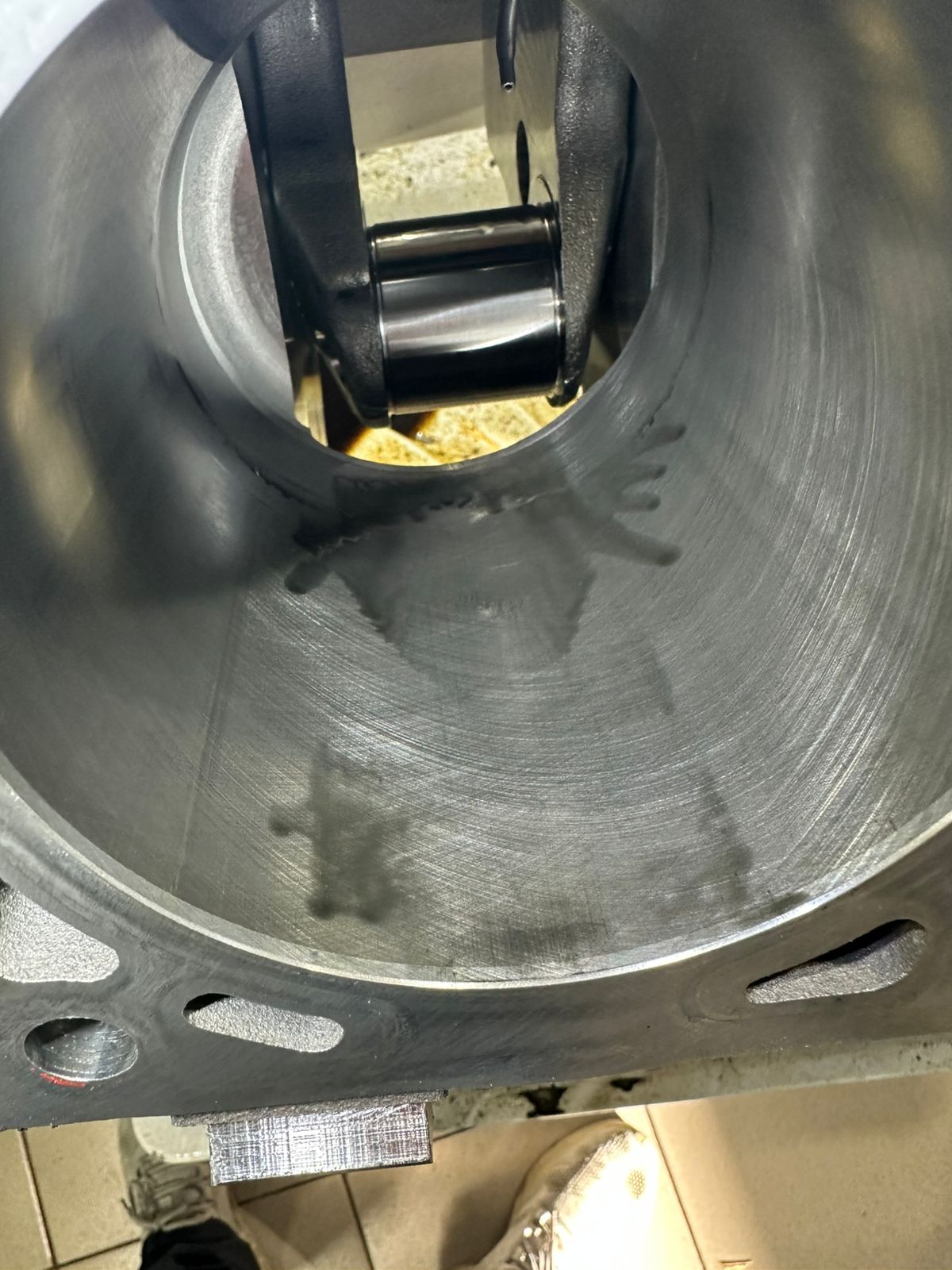

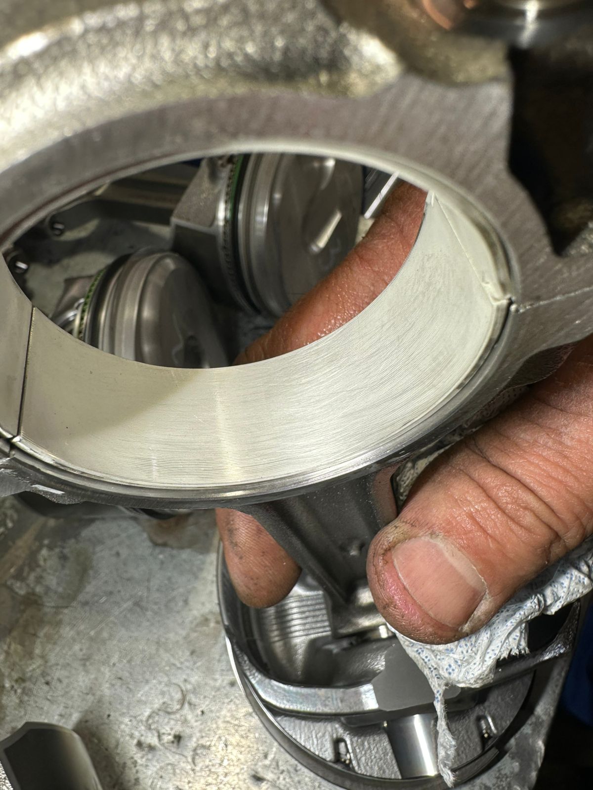

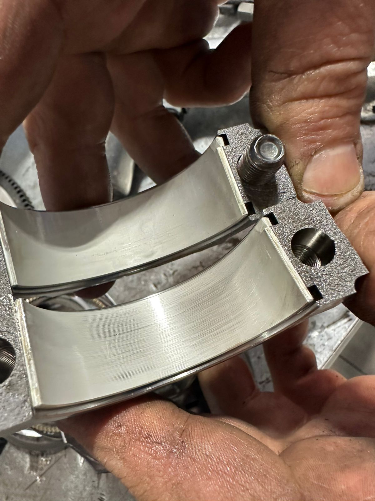

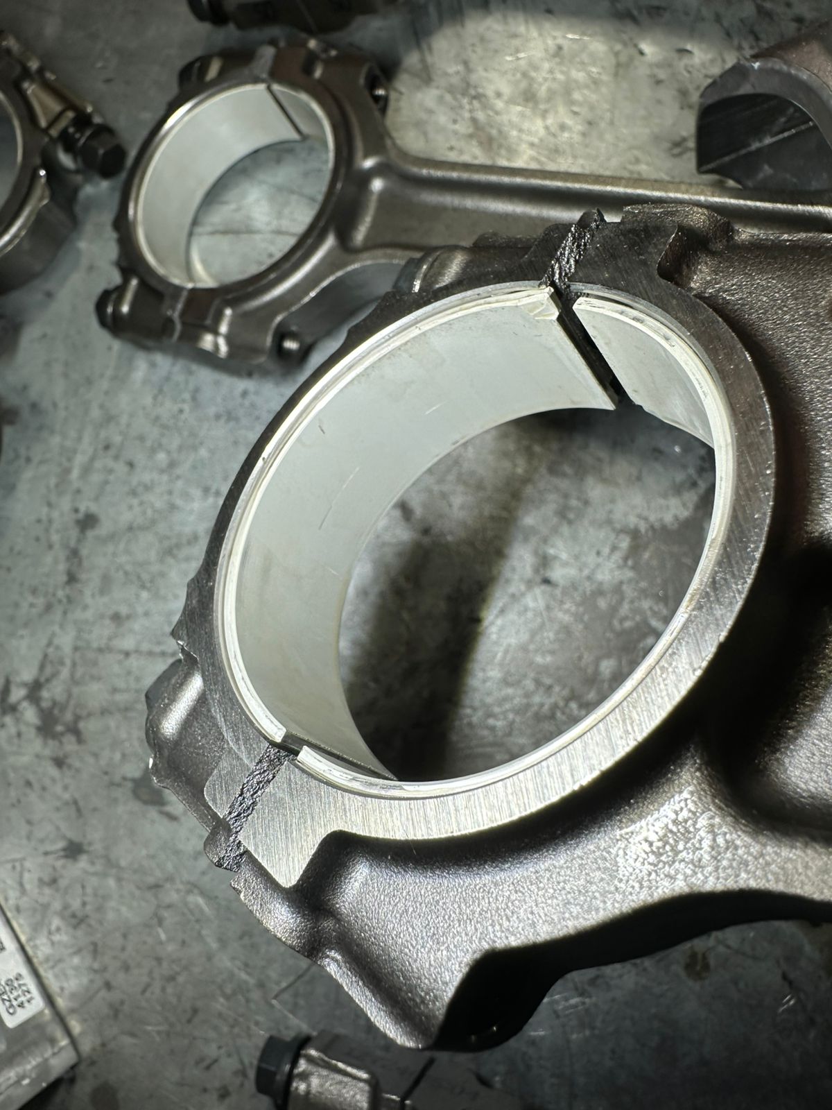

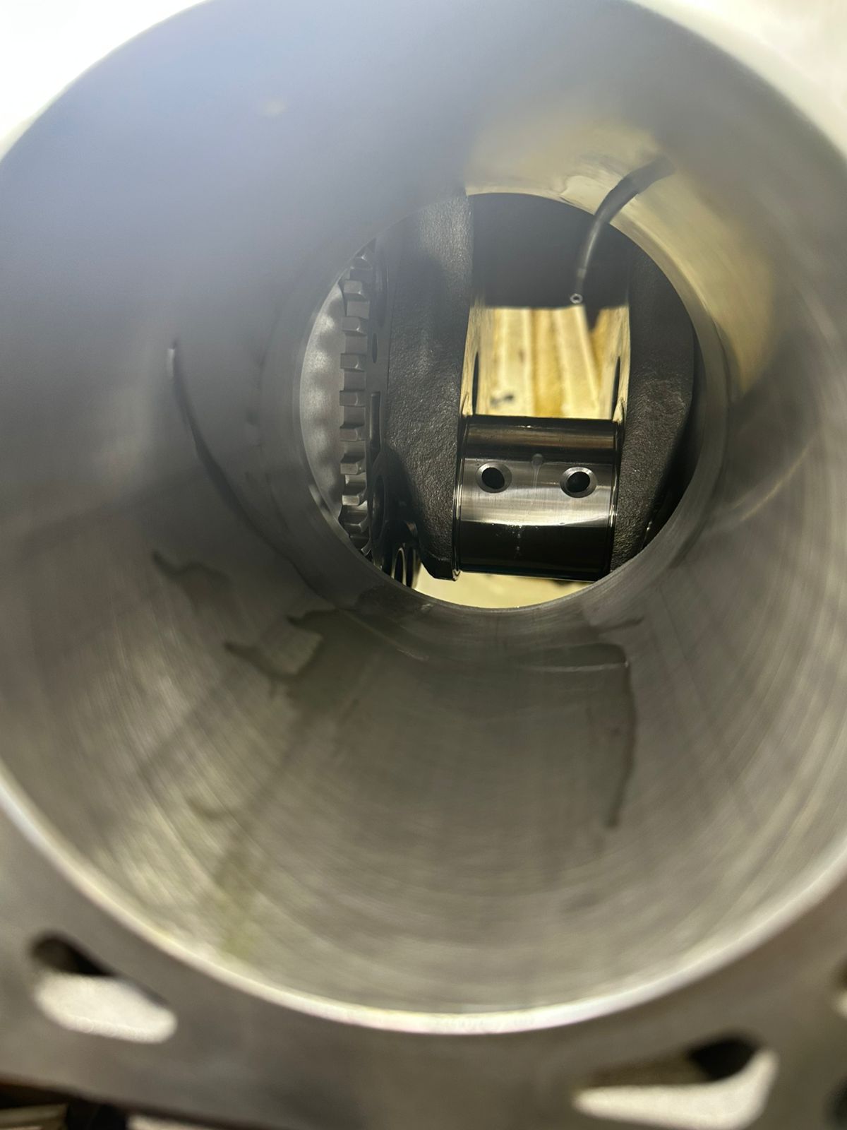

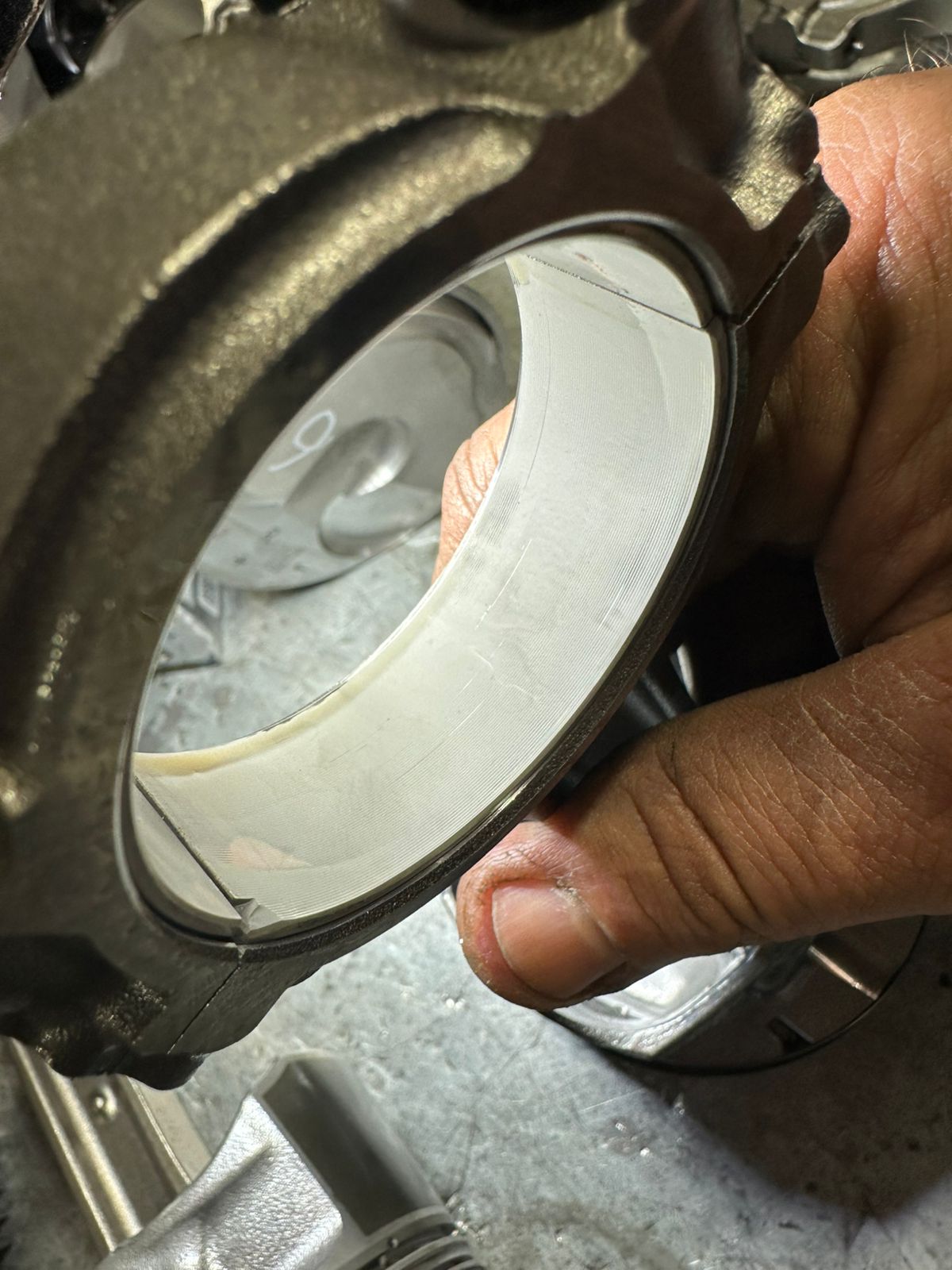

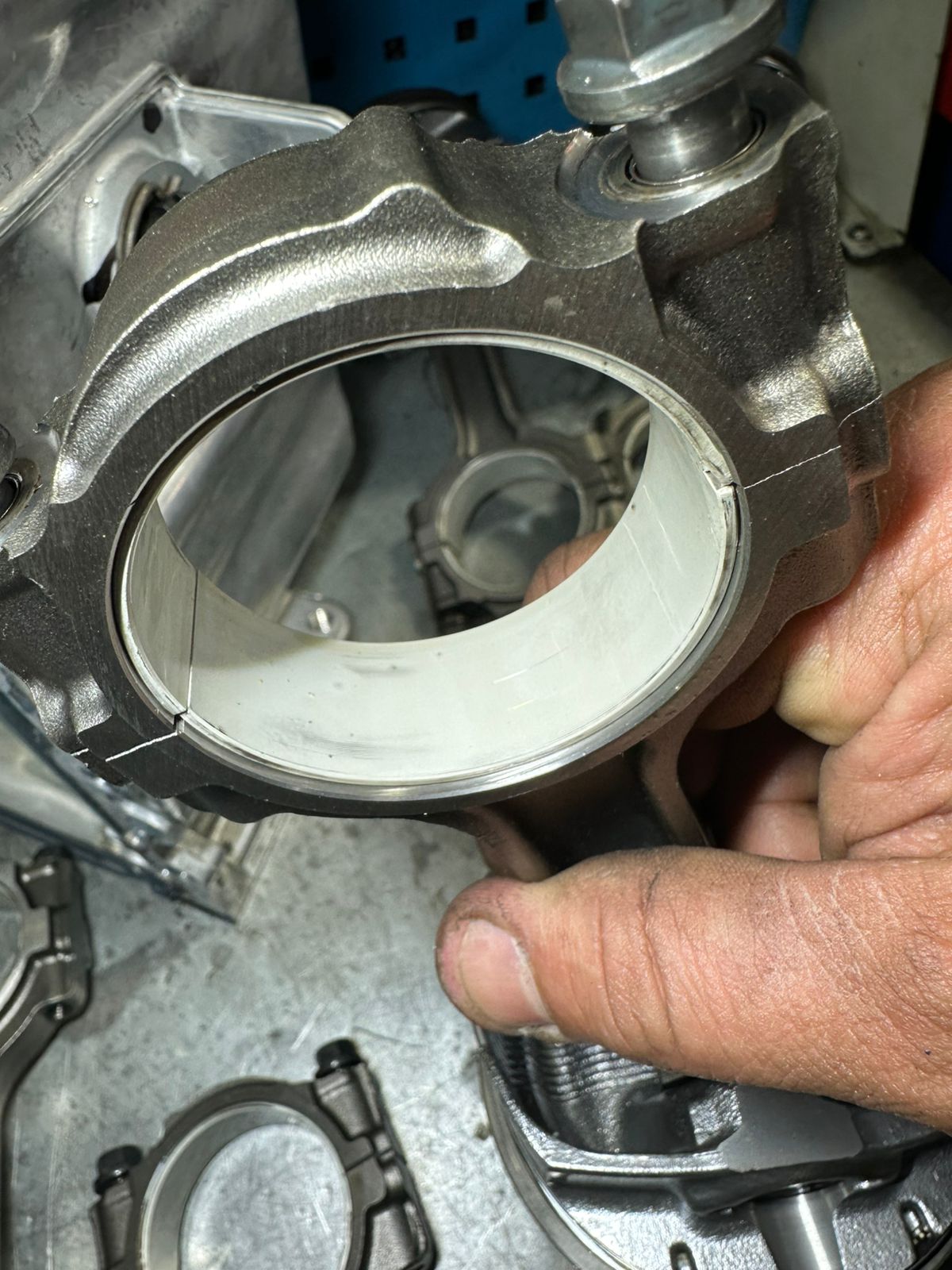

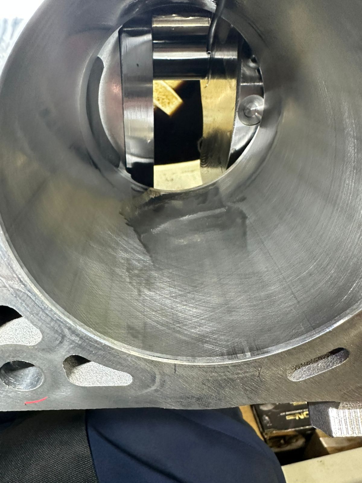

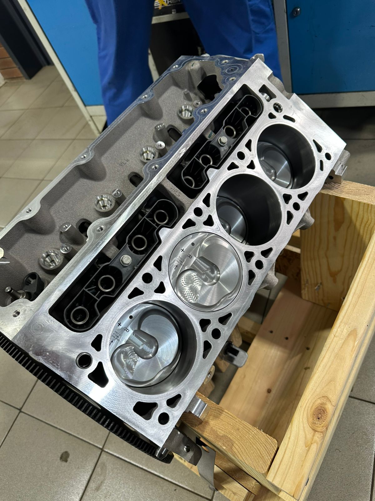

Well, are you ready for new horrors?))) The oil is to blame?) or fuel pollution?)) My new engine was disassembled, and there was this. Its mileage is 0 miles

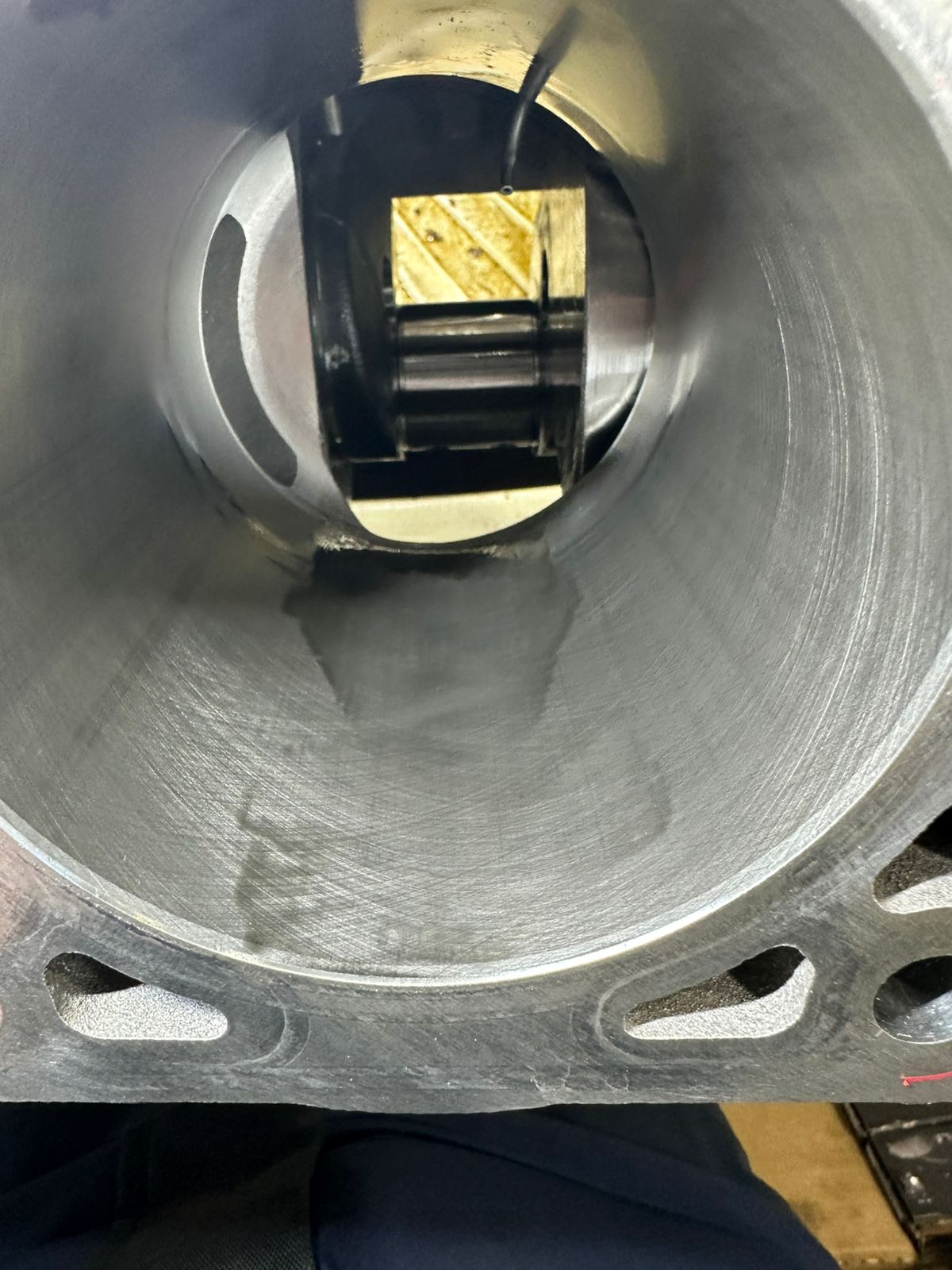

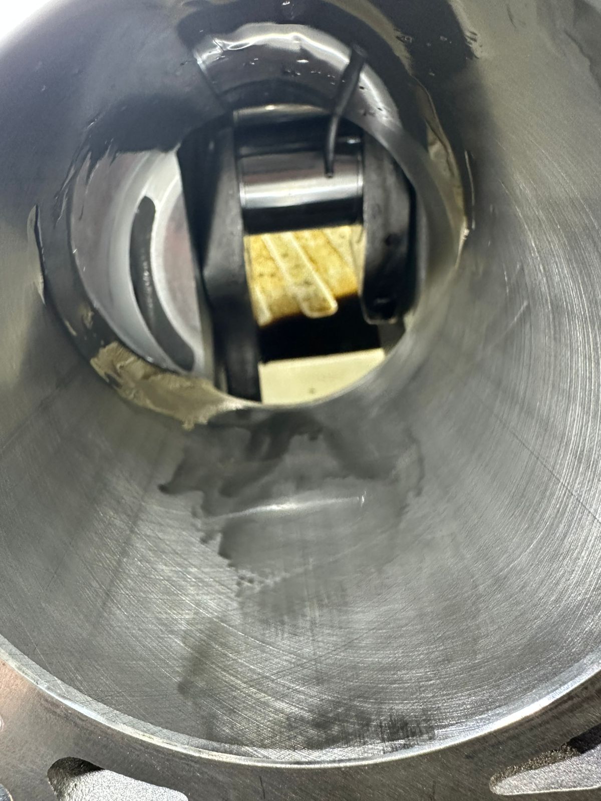

Photos of cylinders
