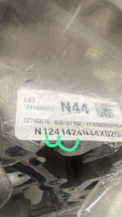

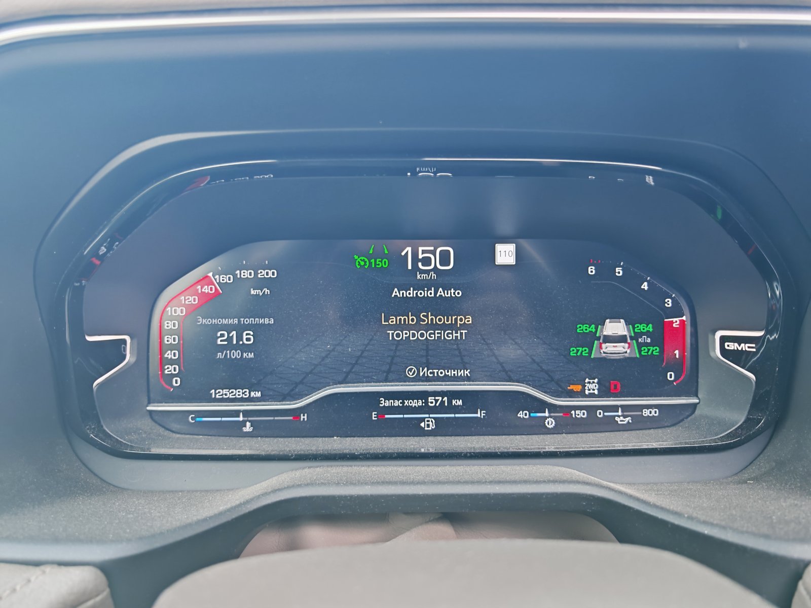

I drove 700 miles on 0-40 oil during the run-in, after which I filled 0-20. It seems that the version that it is necessary to pour oil 0-40 is confirmed, at 0-40 the pressure is high, and at 0-20 it is about twice as low. Do the photos confirm this? :) But no, fans of this movie, :) it's not that simple) after running in, I filled in exactly the same oil that I used to drive 75,000 miles on my previous engine, this is the oil from the Belgian company Wolf 0-20 dexos. Why did I fill in 0-20 anyway? I talked to the Service that made this engine for me. Everyone they made an engine for runs on 0-20 oil, and the mileage on the new engine is already high. So, they poured 0-20 oil on me, I rode a little, warmed up, drove along a small section of the highway at a speed of 70-80 miles per hour, and that's what my oil pressure is 0-20. Wonders. it is about 300 kPa. I'll even post a photo of the oil pressure 0-40 and 0-20 next to it))) at 0-20 it's just a little lower. well, about 300 kPa at 0-20 and maybe 320 kPa at 0-40. My opinion is that either the software has changed and GM has increased the oil pressure, or this is a new modification of the oil pump. But oil has practically no effect on pressure. The pressure on my new engine is clearly higher than on the previous one.

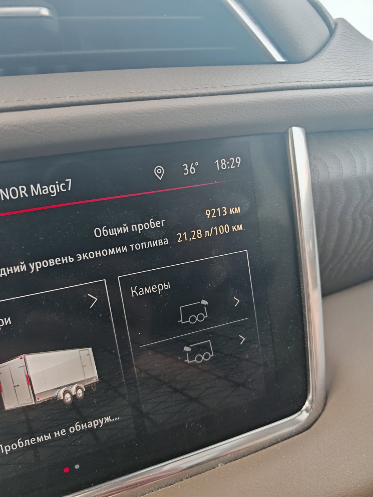

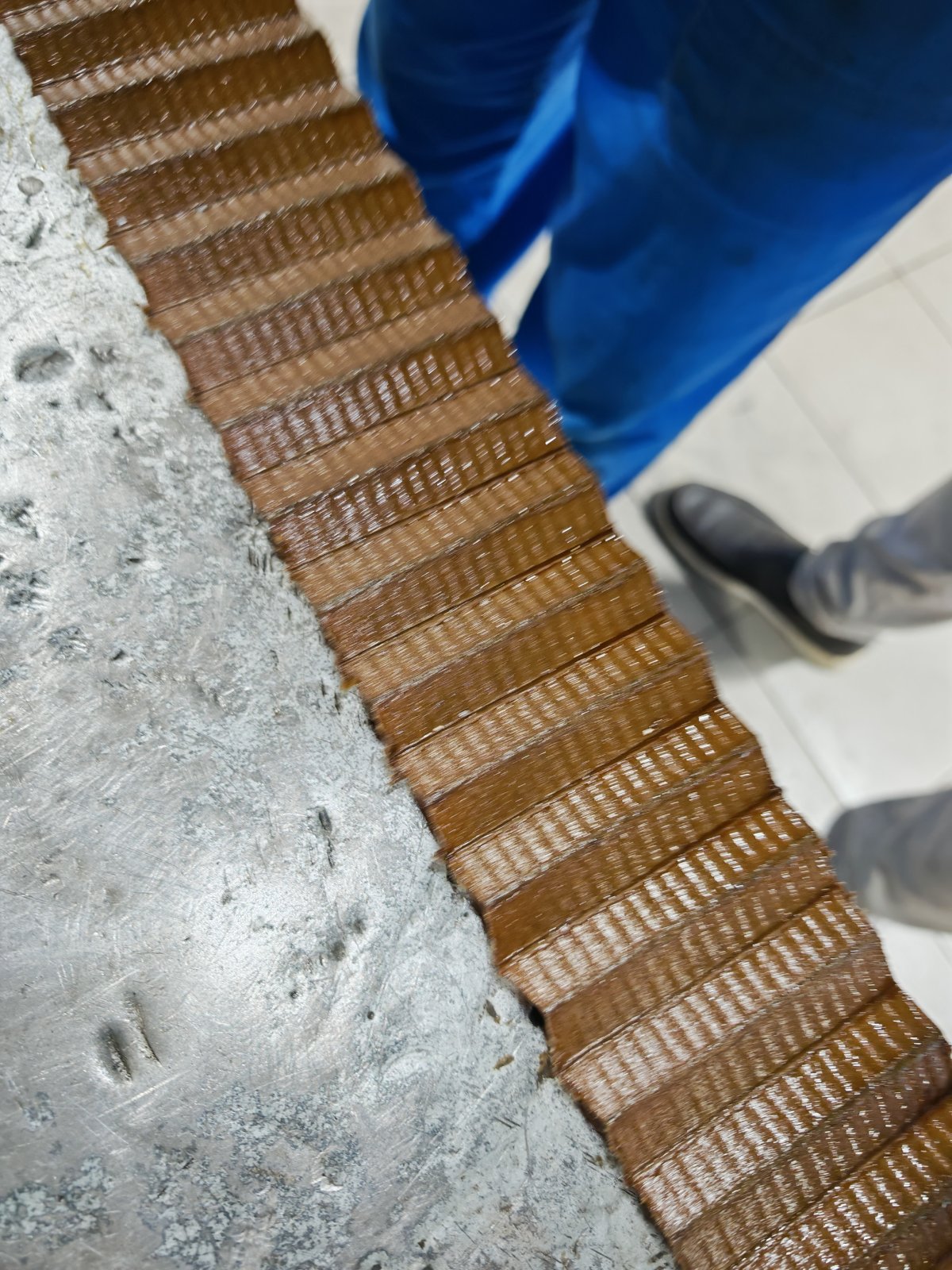

Yes, hello, everyone. Something I spun around and forgot to write further.:). We agreed with the service after the first oil change to drive another 1500 miles, already in normal mode. And then change the oil and cut the oil filter again. I drove about half of them around the city, and the other half I drove on the highway, with the trailer at 95-100 mph. Having traveled about 800 miles on the road there and back. We went rafting on jet skis with friends to a neighboring city along a beautiful river. After arriving, we changed the oil and cut the filter. Everything was fine in him. No shavings, no metal particles. Now I have been filled with new oil 0-20, and then a change after 7000-7500 miles. Now I have driven about 3000 miles, after replacing the engine
