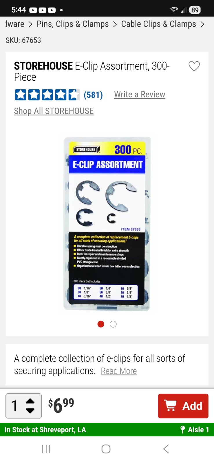

I lost one of mine as well. I bought a kit from Harbor Freight that has a bunch of different sized "E"- clips. I found one that fit, and clipped it on.
How did it work? What size was the clip? Or do you have a picture of the box that your bought?

Home Depot or Lowes in the Fasteners section, in those small pullout cardboard drawers for specialty fasteners.

Well, my glass wasn't exactly "rattling". But I did recently replace the rear glass on my 2001, with a 2005-2006 style rear glass. In the process, I dropped one of the E-clips and couldn't find it again. So I drove around for a day or so with no clip on one side, until I bought the Harbor Freight kit and popped a new clip on. I only put one clip, but I suppose I could have squeezed a second one in there.
