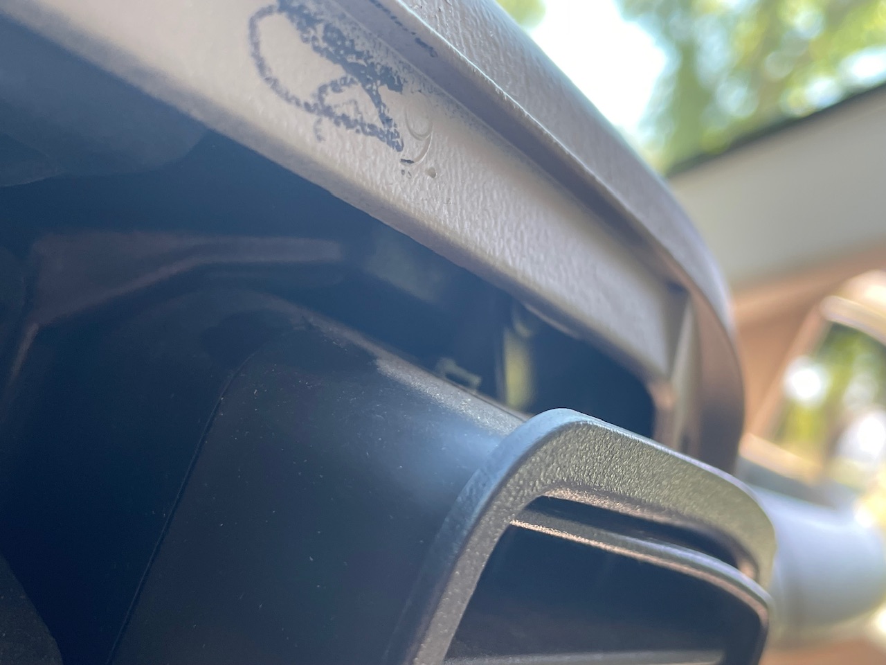

Also want to replace my broken dash vents, how do I remove the left center vent?
Top screw is obscured by dashboard edge..

That's the one. That top screw is behind the top edge of dashboard? And doesnt look look like enough space to remove a short screw, much less the long ones used..

Well, I tried it Doub.. It took a bit of prying, but now the rear half of the vent is loose.
So back to the original plan, which probably involves lifting the dashboard.
Have thought about hogging out the edge of dash that's covered anyways, but worry it might lead to a crack later..

wrong vent, it's the driver right vent.

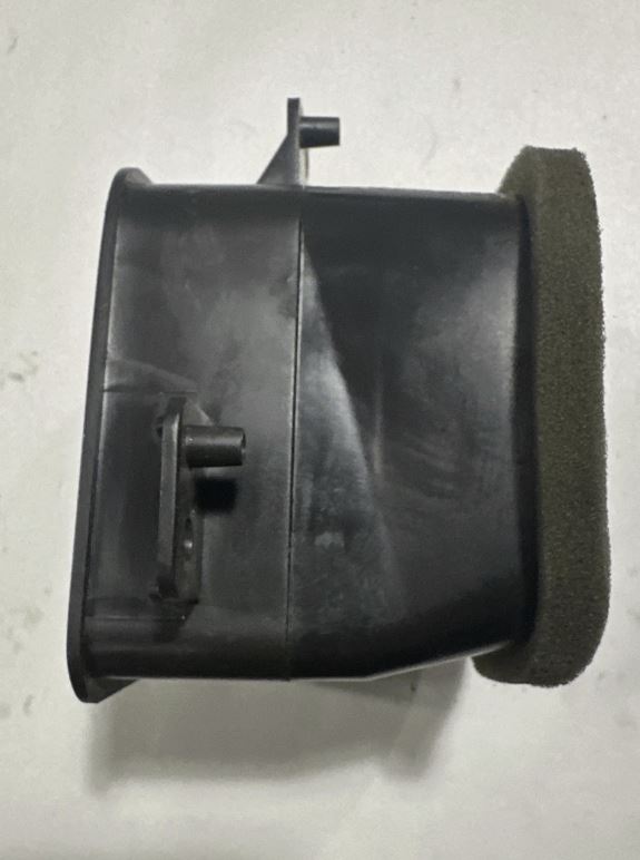

Charm.li seems to indicate that the vent comes out with the headlight switch, if I'm reading it correctly. Or am I looking at the wrong vent?
Thanks here's the right vent (center)
It says..
Remove I/P bezel
Remove I/P trim panel (dashboard?)

Rear half? you mean it's part way out?
Oh, I meant the housing part.. Apparently it's two parts.
There's some small tabs on the bottom that won't grab, so the back half of vent jiggles around.
Probably wouldn't notice anything with the vent in there, but the plastic feels loose and a little air could leak out the seam..

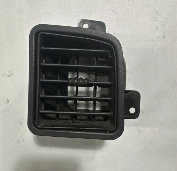

Installed new Dorman center vent.. Do NOT recommend.
It's floppy in the middle, and rubs on the edges when rotated to the sides.
I plan on jamming some adhesive felt under the vent to hopefully tighten it up.
Removing dash top was not too difficult.
After pulling the bezel off, remove about six 7mm screws along the edges. Passenger vents and grab handle come out.
A couple phillips screws on both ends and one behind each passenger vent, and you can pull cover back and up..
Spend the extra $10 on a used junkyard vent from ebay! (Dorman vent was $20)
