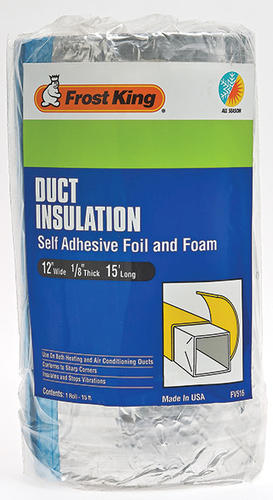

Little late to the party as usual .
I have a roll of duct insulation with adhesive on one side ($12) . I’ve sound deadened all my doors with it (about 2 rolls) and it helps a lot. I have some left over so if I have any rattles I can always cut off a piece as needed to stick in or wedge between whatever if rattling or rubbing.
