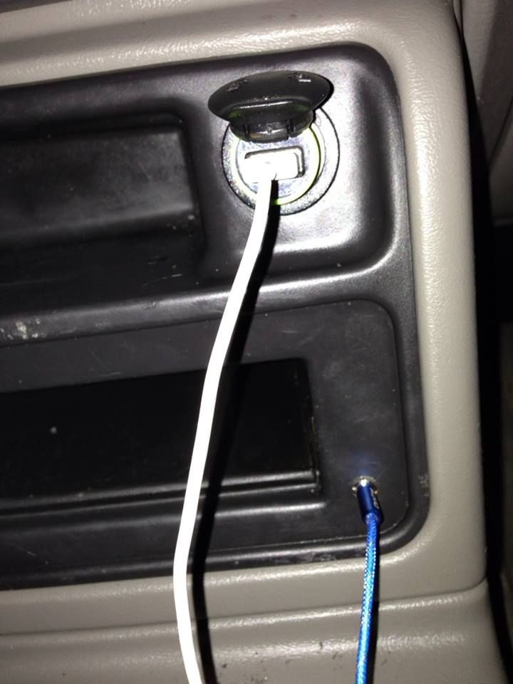

Got it all finished and working perfect! Probably the best 3 dollars I have ever spent. Also picked up a new battery today.
