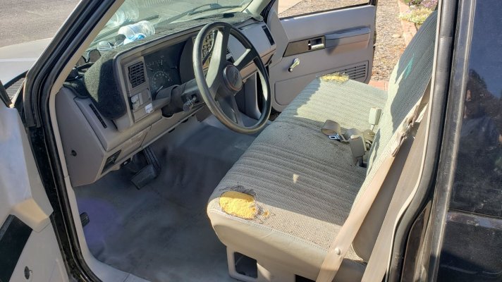

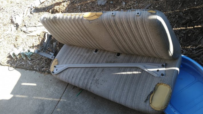

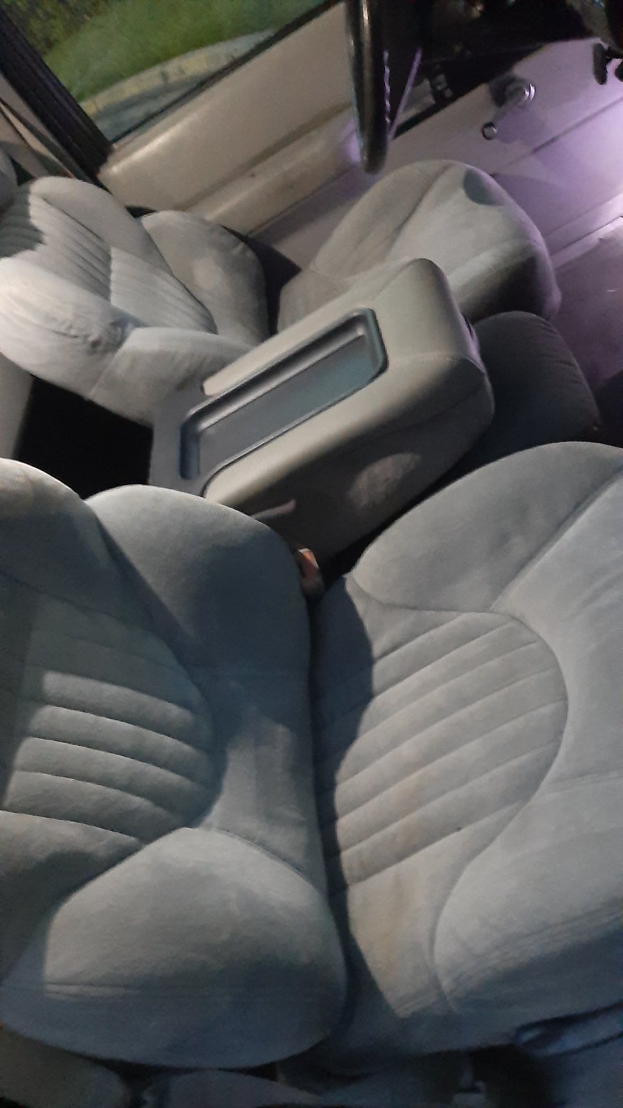

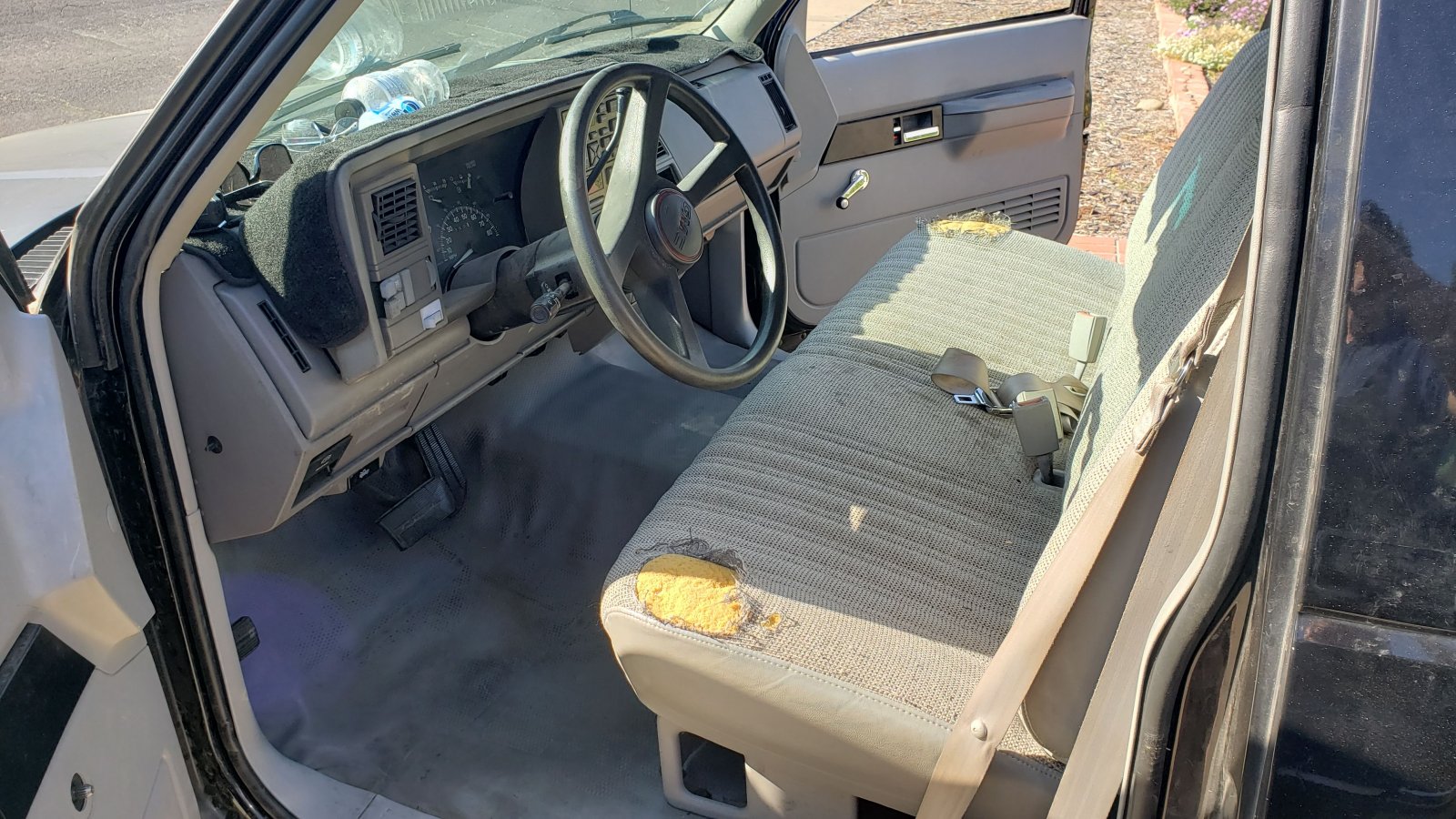

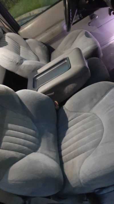

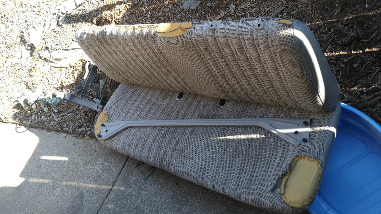

Gmt800 jump seat and cloth 98 bonneville buckets in my rcsb. Had to hammer/bend the center console bracket to match the floor. Drilled some holes and bolted it in with grade 8 hardware just like the seats.
See before bench.

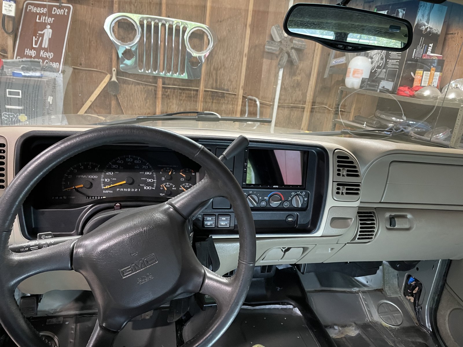

Thank you. Yes it was leaking into the blower housing. The wiper cowl is broken at the retaining screw. I vacuumed and flushed everything else, then sealed up the screw holes. Seems like it worked.
I did convert to double din. I used the Metra DP-3003 kit. The fit and finish isn’t quite as good as the OEM piece, but I think it looks cleaner than the kit that requires cutting the factory dash and putting the trim piece around it. As a bonus, the Atoto head unit was shallow enough that I didn’t have to trim the dashboard supports behind the radio.
Also, either SEM’s version of light neutral paint is significantly lighter the GM’s version or I miss read my RPO code.

Or yours might've just been dirty. That usually happens with the lighter color interiors.

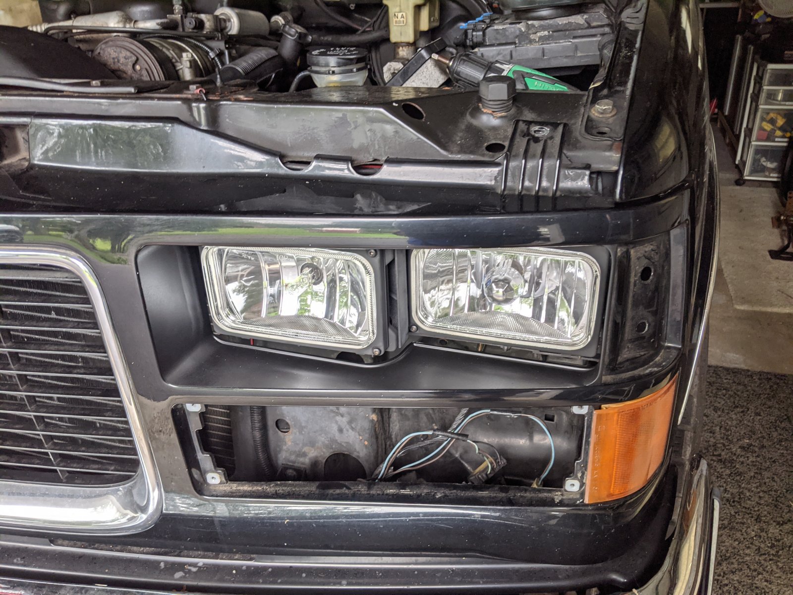

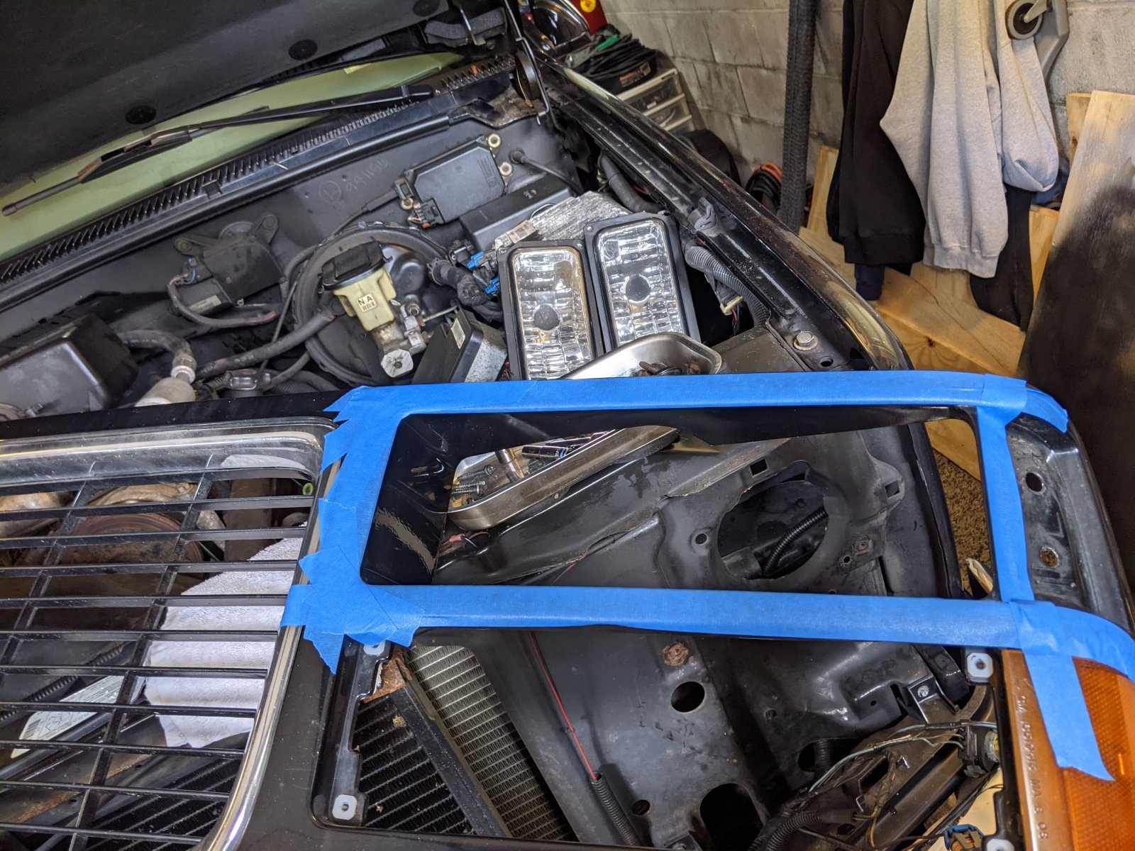

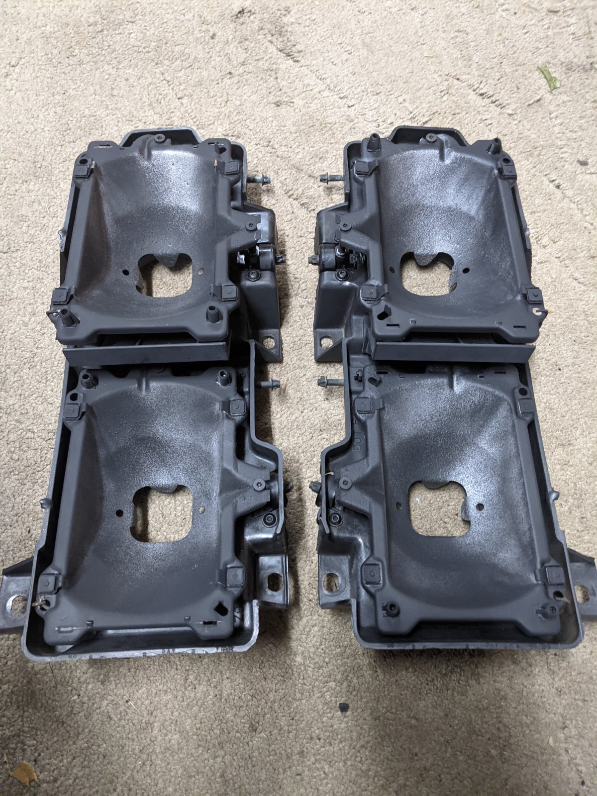

Not today but... I went the 88/89 assembly way with LMC lenses.
After two aftermarket composite assemblies either clouded or flooded over the last 8 years, I bit the bullet. I'm pleased with the outcome of the look, fit and finish. The lighting could be brighter with standard bulbs but when aimed right, they work fine and are actually better than the second replacement set of Anzo composites. The lateral vision ok, but augmented by my fogs. (Hipro Power 9006XS 5900k 100Watt bulbs helped with the brightness)
Wire brushed, prepped and high temp sprayed the buckets
A Little SEM trim black around the recess:
Test Fit:
