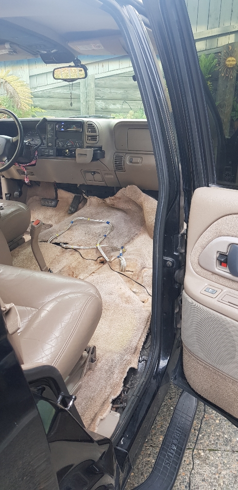

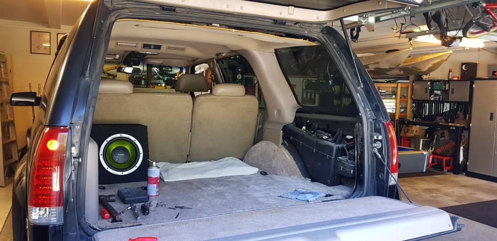

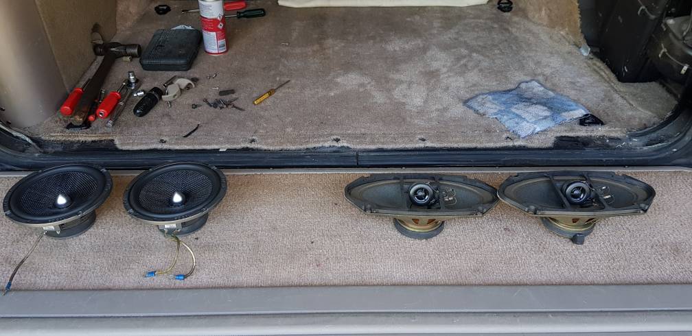

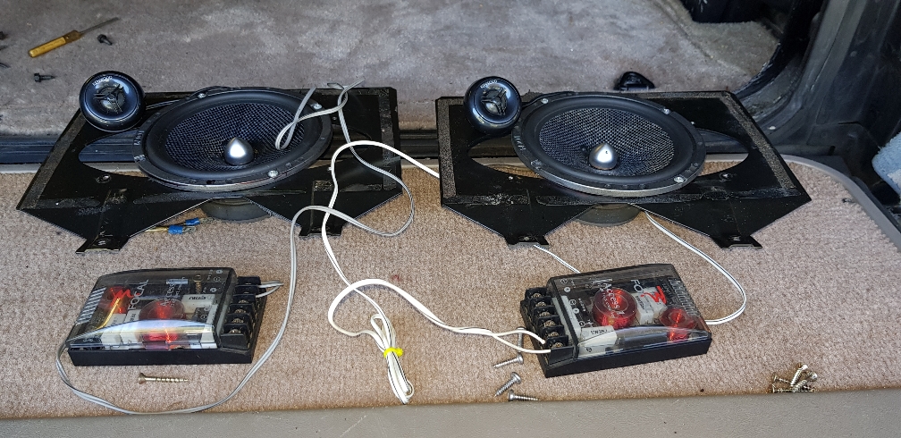

Today I decided to pull some of the rear interior put of the Yukon so I could pull the blown rear speakers out and are replacing them with a pair of FOCAL 6" Kevlar mid range speakers coupled with an old old pair of Kenwood tweeters and FOCAL crossovers.These I will hook up to a Fusion Encounter 1800watt 4 channel amp currently living under the centre front seat. The other 2 channels I've bridged to produce 900 watts into a 10" Fusion sub in the back. This should help fill the massive rear cavity. That will give the Beast the factory components in the front doors,factory door speakers 10 " sub and rear components. I usually run a 15" 750 watt Fusion but am enjoying the punch of the 10 at the moment. Rock'n [emoji869]
Yes I know[emoji85] Build thread!
I am amassing content [emoji13]View attachment 271201View attachment 271202

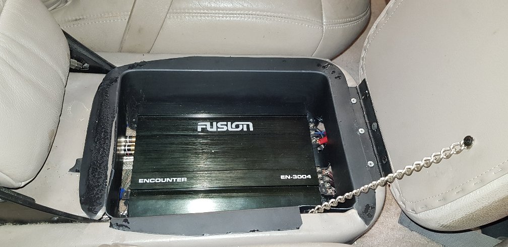

Awesome! Any problems with your amp breathing in there?
97YukonNZ
Feb 12, 2021
1,489
4,193
No problems so far is a fanned amp so it cools itself. Cut the front and rear of the plastic box holding the amp so it could push/pull air.

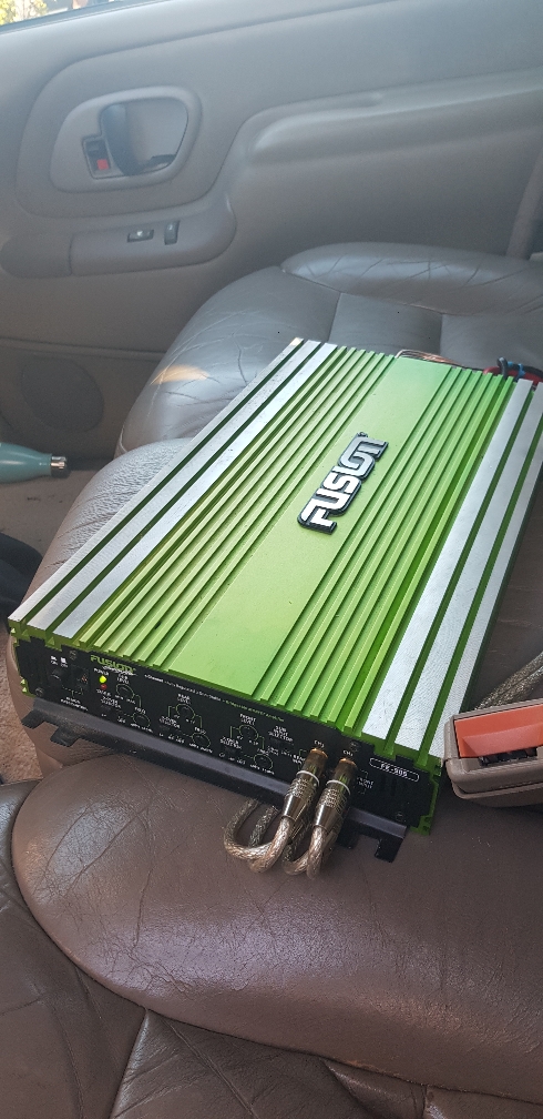

A friend dropped by work this morning with an older model 1400 watt 5 channel amp that he paid $15 for at an eco store. It looks so sexy!! That beautiful ano green with cast geometric thick alloy casing!
Am thinking about grabbing that,putting a battery on the left side of the truck and adding a smart charger so I can dedicate 1 battery for sounds and the other for Starting.
He'll want $50 at least for it. The capitalist Pig hahahaha [emoji28]

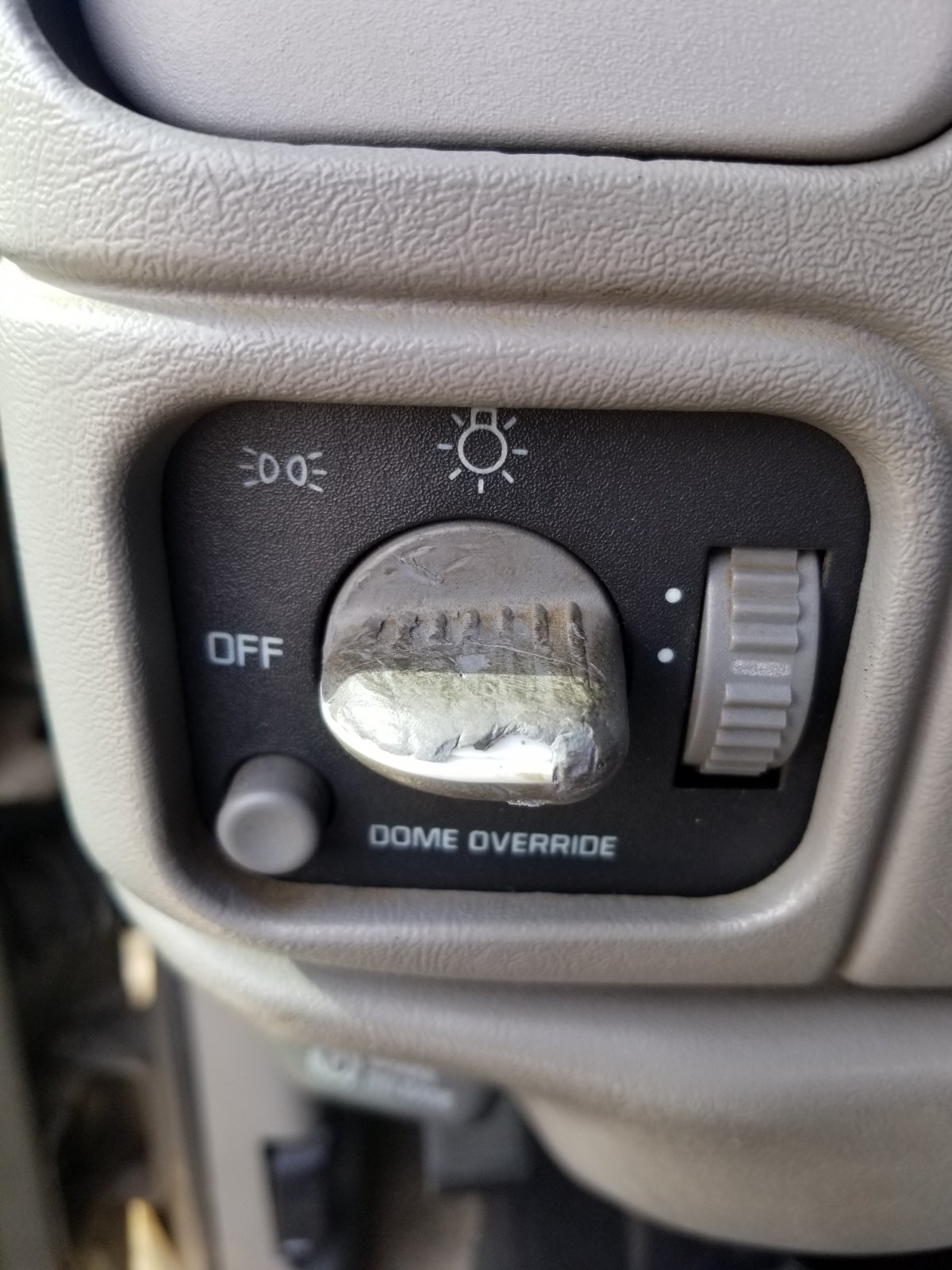

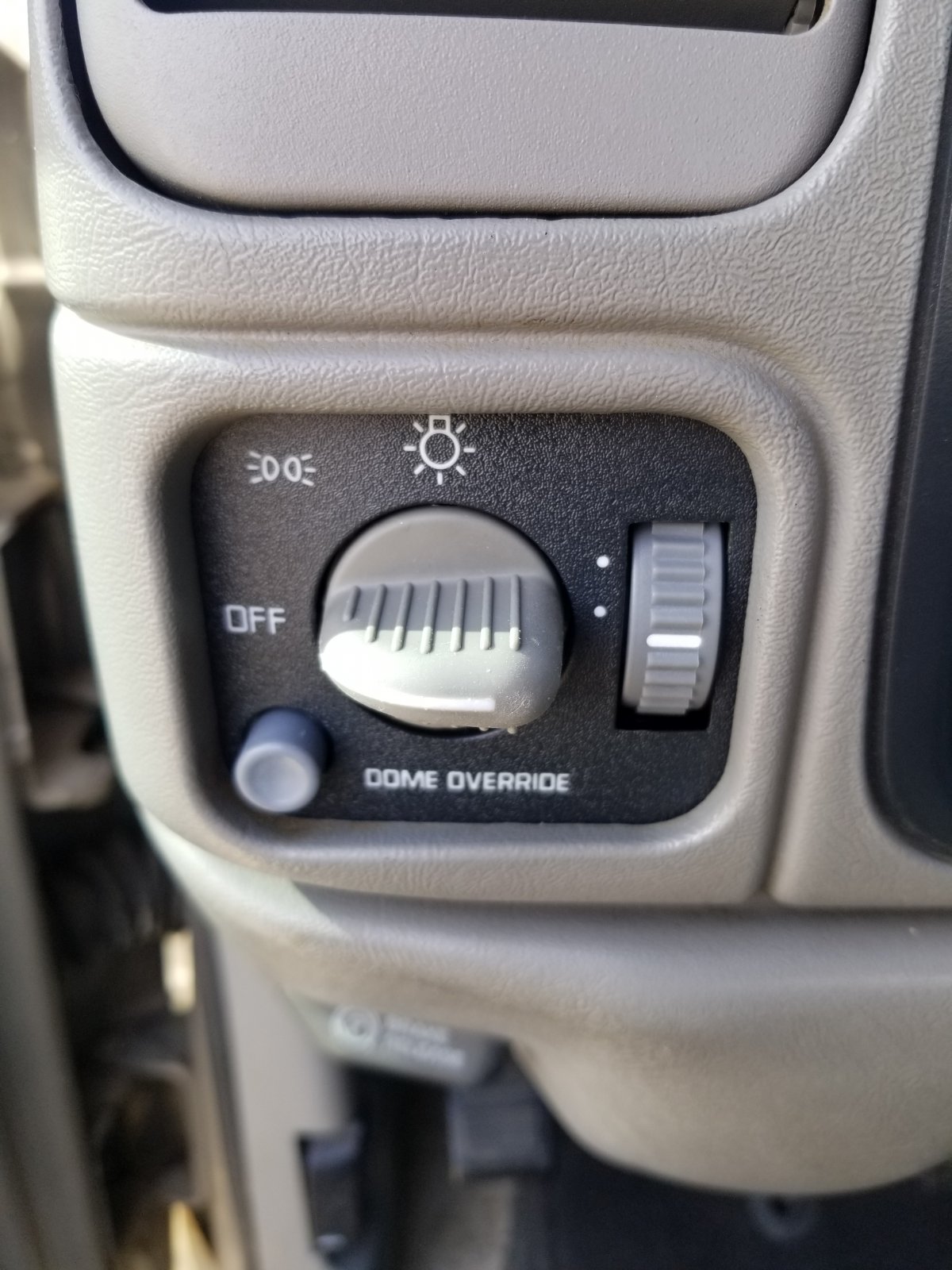

Finally got around to replacing the headlight switch. I don't know what it is with these trucks, but the headlight switches always seem to get old and gross. The rubber gets sticky and discoloured, and nothing you do seems to be able to clean it. I've had a few of these OBS trucks that have had this issue.
Anyway, easy fix. Throw old the old, install the new. Looks so much better.
Also took the opportunity to install LED headlight bulbs. I know, I know. The housings aren't designed for them, they're too bright, what about other drivers, etc, etc.
I prefer the "white" look, it's a much nicer light coming off the lights now. I went with a lower lumen rating, specifically with other drivers in mind. There is a noticeable difference in light output. I feel like I can actually see at night now. And with the amount of night driving I do, definitely worth it. Was out Saturday night, seeing how they look, and did not get flashed once, so I take that as a positive.

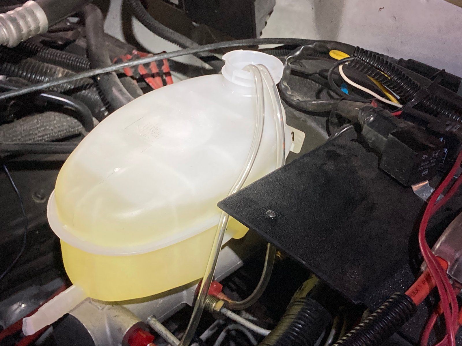

Brake Master Cylinder Swap: NBS
After a routine brake flush, I was finally tired of my 21yo weak and spongy brakes. I swapped out the OEM master cylinder for an NBS unit. You need a 9/16 to 1/2" adapter for the forward line but the swap was pretty straight forward. There is a good YT video on the entire process. You can use a 2005 yukon search if needed. The part at Autozone was a
Duralast New Master Cylinder (Brake System) NM4073
  • Part # NM4073
  • SKU # 493917
Some final thoughts:
The rear drums have an 8mm bleeder valve. The tubing that I used seemed to fit adequately but there was always some bubbling coming through the tubing no matter how much I pumped the brakes. I reconciled that this was just pass through from the tubing and proceeded with the front wheels that have a 10mm bleeder valve. The tubing was solid on this and no extraneous bubbles. Just keep an eye for it. I didnt see any reverse flow of air back into my rear brakes so I didn't worry about it. Brake check was solid at low speeds so I assume that the bleed was effective after the master cylinder install.
The new master cylinder is a fantastic upgrade. The pedal is much more firm with a much more definite stopping point. A highly recommended upgrade without the headache of the hydroboost and pedal fitment issues. This is an easy swap.
Cost: $95 for the master cylinder, $25.00 for 3 qts of synthetic brake fluid. Done.
The part comes with a bleed kit so you don't have to bench bleed. You can just use the brake pedal to clear the air out of the master cylinder before you hook up the lines and do a final bleed at the wheels. Cheers.

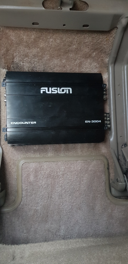

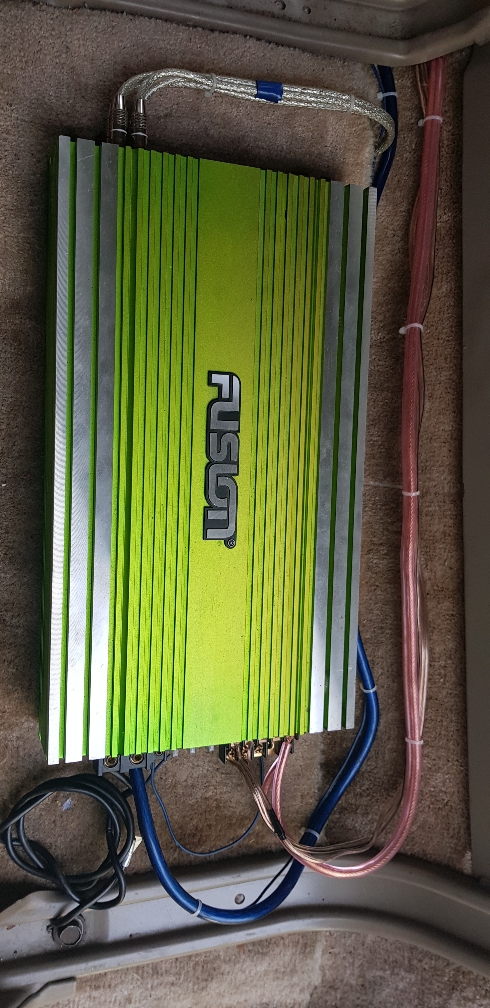

A buddy gave me an amp he got a stunning deal on! Time to find a home for it now that I've tested it
5 channel amp. Bridgeable Mosfet amplifier [emoji106] Favorite color [emoji106][emoji106]

And it is in! Now I just have to put the rest of it back together [emoji849].
Sound great!![emoji346][emoji345][emoji344][emoji444]
Will make a board to mount it to soon[emoji41][emoji111]

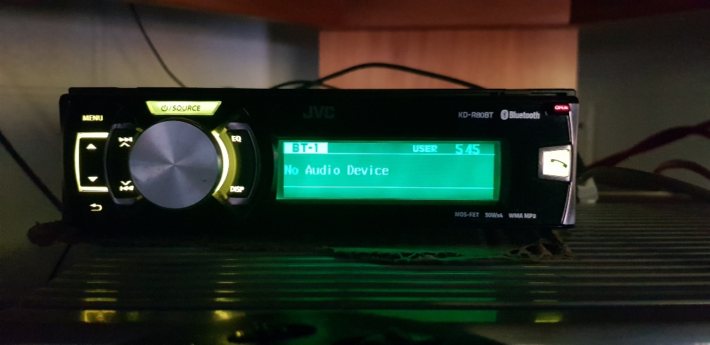

Are you using an Alpine hu?
97YukonNZ
Feb 12, 2021
1,489
4,193
Hey Tone [emoji870]

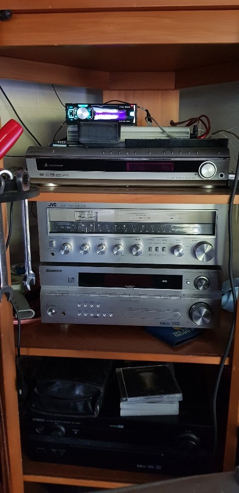

Am currently running this single din JVC
Am going to swap it out for another with bluetooth that I like more. This 1 has pretty good O.E.L features and lots of tuning scenarios.
The bluetooth JVC is currently a go between unit that pairs a couple of house stereo amps(analog and digital) together without feedback giving me 14.4 speakers in the garage currently.

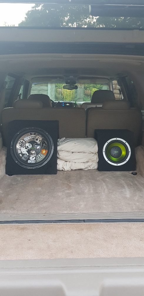

Lol so now of course I no longer need chose between 10 or 15 inch sub.
I can run both at once [emoji16][emoji106]

[emoji2] Yeah I was mucking around trying to hook the 2 house amps together but they hate each othe. Analog wont hook to digital. Massive grrrrr and feedback!
So I had a car system already goining in the garage. 2 components, 2 6x9s and 2 12" subs running off a JVC headunit and JBL gtq 4 channel amp.
I thought to myself why dont I hook the amps separately to the hu via the rca outs as they are only a very small volt and even tho people talk about correct ohm's and how house speakers eat car headunit amps this seems to work well.
At the moment the system is powering 6 car speakers,2 car subs,6 house floorstandrs,2 cabinets,2 bookshelves and a centre speaker.
All out of my phone connected through bluetooth
Have a 42" flat screen t.v hooked up so can chuck ytube or music on through the system.
Makes a fair bit of noise heyy [emoji28][emoji869][emoji106][emoji344]
