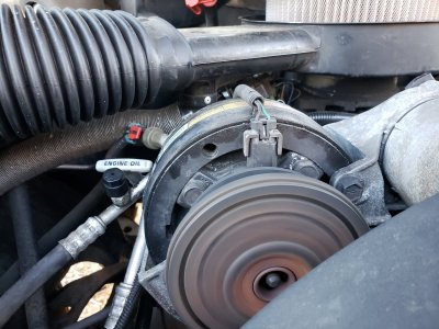

Damn. Im really hoping its a fitting or hose or something. Not seeing anything obvious though and its definitely leaking somewhere... Ill have to look closer at the compressor. I'm surprised to have this problem on such a low mileage truck despite its age. Its only got 65k miles...
Rubber deteriorates.
There's only 5 fittings, in and out of the condensor behind the front grille, in and out of the evaporator at the drier, and the manifold at the compressor. The high side quick connect on the manifold is prone to leaking, mine does, but also the low side could leak and there's another schrader fitting on the drier. Apart from that some trucks have had issues where battery acid leaked onto the line that runs past the battery from the condenser to the drier and corroded it. AS I already mentioned oil will come out where it's leaking. I can't actually see any oil on mine, but the compressor leaks in the center. You could have a leak in the evaporator coil or condenser coil but it's unlikely. My money is on the compressor
Edit: Could also be leaking from the high and low pressure switches. The high is on the drier, schrader valve I mentioned, and the low is on the back of the compressor.

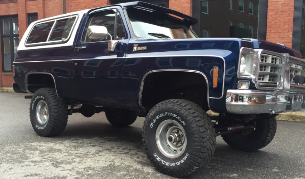

I replaced the aluminum wheels with the old factory Rallye steel wheels.today.

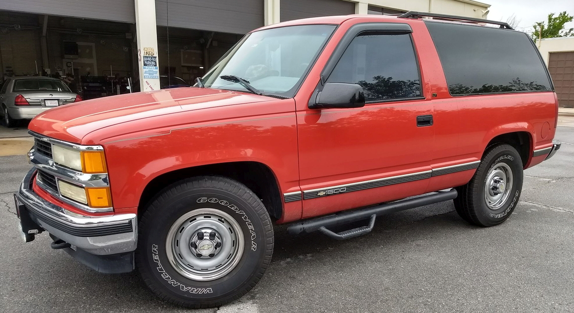

As much as i like the rallye’s i like the original alum’s on your truck but hey, who the f am i... it’s your truck. If you like, thats all that matters...lfted k5’s with rallye’s, raised white letter bfg’s .....that was a good looking combo tho....always loved that.

I had an '87 K5. I still miss that truck. It had that look, and I agree with you- it's a great look.

I've realized since I made the change that part of the reason (to me, anyway) the old Rallyes look better is that they're deeper.

Weird, i was looking at that pic of your truck a few days ago and thought the same....

The powdercoater took it upon himself to add some metalflake on these wheels. It doesn't show in this picture, but the wheels come alive in bright sunlight. It was a very nice added touch. I called last week and thanked them for doing it.
LOL The deeper style, like my '87 K5 had, would still look better though, especially with the flake.
Thanks I have not gone back to mess with this yet but I may use it for reference.
I can't see any obvious leaks I'll have to add some more and some UV liquid so I can find it.
Was leaking at the Schrader valve high side. Got that to seal. Gets nice and cold now but looks like it could be leaking at the compressor.

Glad to hear you got it working. Not unusual for the compressor to leak a little. If it lasts a season you're golden :)
