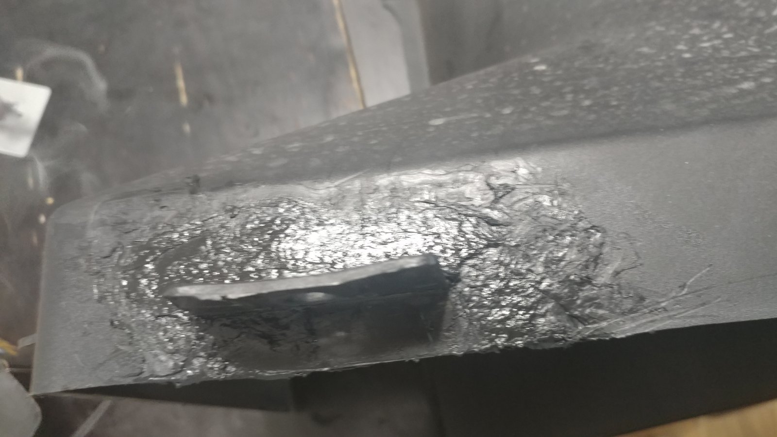

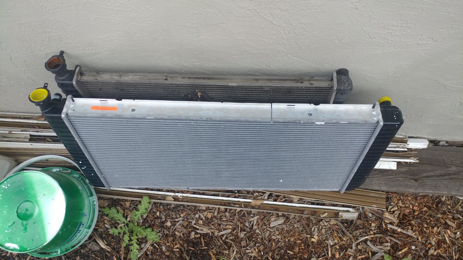

Rad upgrade. 28" single pass to 34" dual pass. Cracked my lower fan shroud had to repair with the ol horror freight plastix welder. Ugly as sin but works.
Decided to stick with the original fan shroud for now til i do the electric fan upgrade. just trimmed a bit and got the brackets to hold the rad. Had to trim the rubber isolators a bit and drill new holes in the lower rad support to locate them properly. I got the hd rad for less than the puny original one since i found one open box ($63) on amazon. Upper Rad brackets were about $30 on ebay. Cheaper than the standard original replacement.
Need a new lower rad hose though.

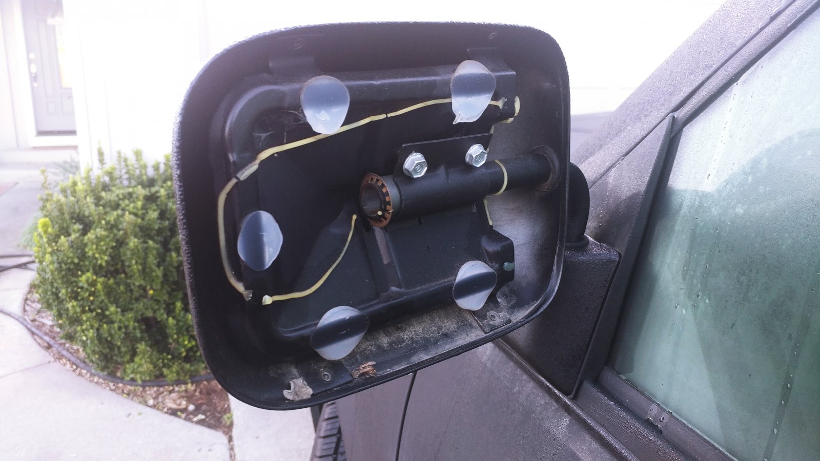

Couple days ago i walked out my front door to see a broken mirror. Good excuse to update them to the black flip style mirrors. I considered sport mirrors for a second but they look so tiny and i like to be able to see things in my mirrors. New mirrors have arrived. Maybe next week i can find some time to put them on.
33,201
51,450
Looks like it just gave up the ghost? Just popped out?
TheAutumnWind
Jan 8, 2015
3,255
1,997
Yup. I had the mirrors off to replace the scraper seals recently and they were fine. Attached them securely. No issues
Then there was a hard frost and it was fairly windy. Guess that did it.
