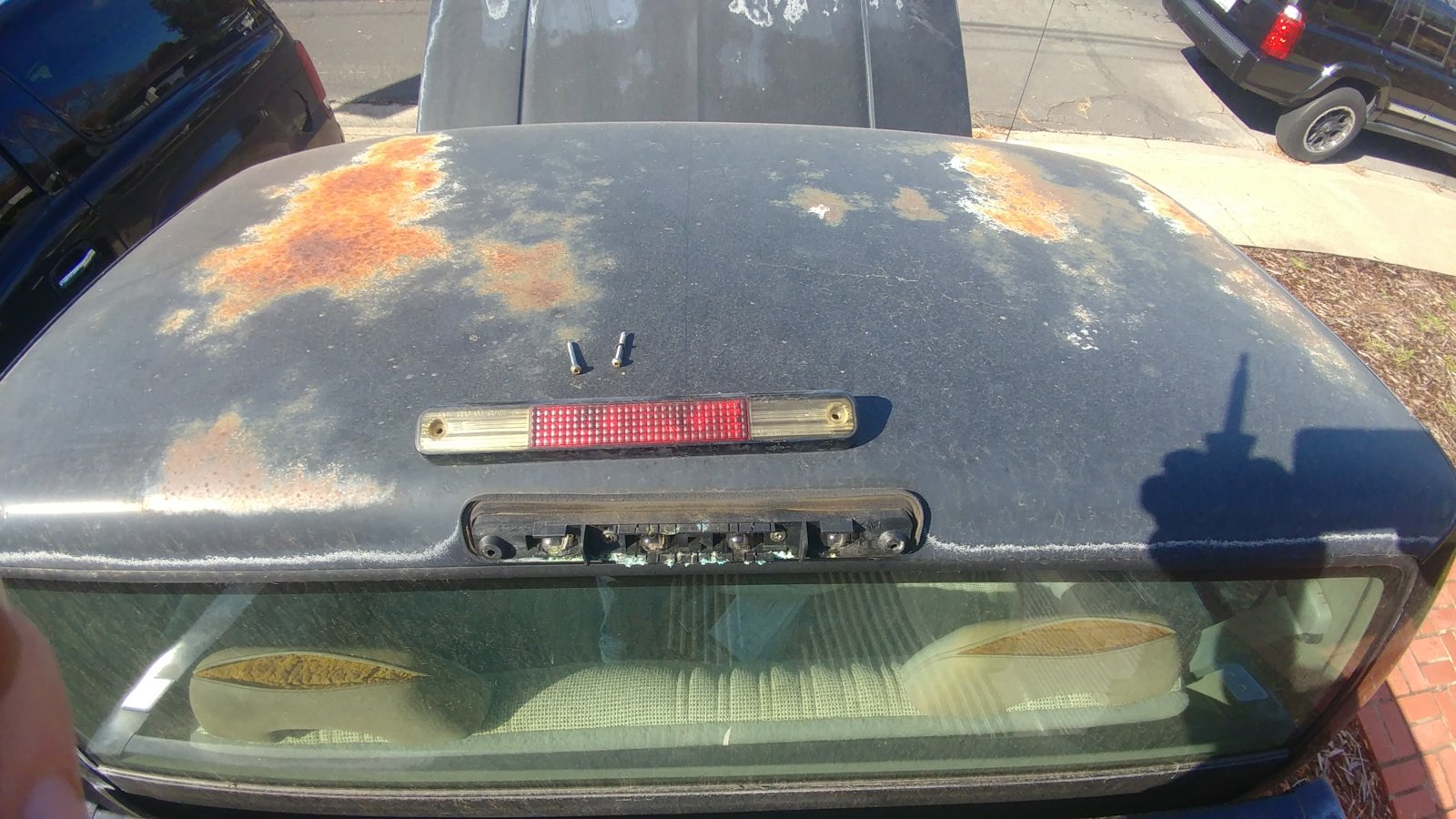

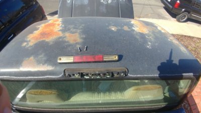

Going to have to address the roof.
Any idea where i can get this gasket? Or how these bulbs come out?
96-2D-Hoe
Feb 14, 2019
529
409
Bulbs are most likely corroded in. I struggled to get a brake light bulb out recently. The grease had gone hard too. Hair dryer to warm it up a bit perhaps?

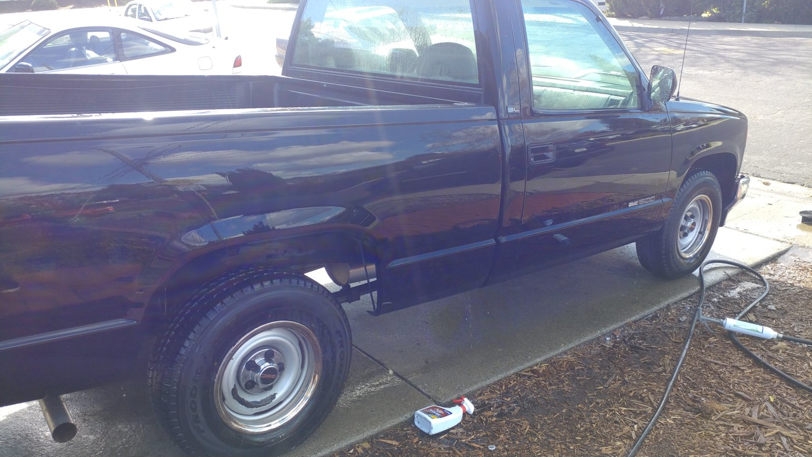

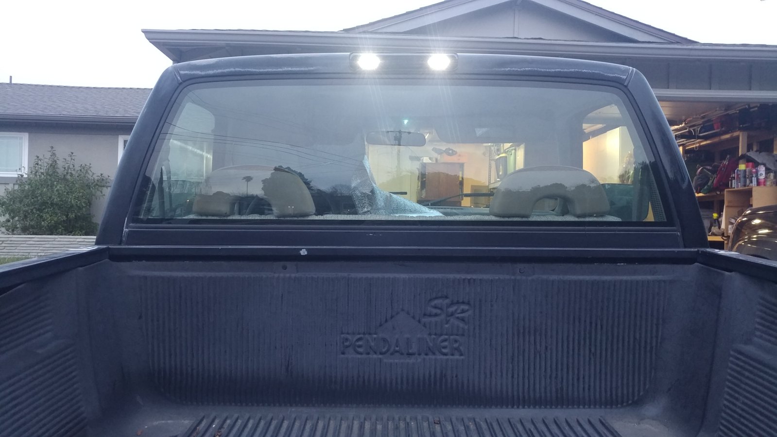

Washed the dust off real quick.
I've got some shackles. Think im gonna bring the rear down 2". Ill probably never go real low with gpas truck since i want to get some use out of it but a 2/3 drop might be about right.

Is that a CA truck? So clean underneath. Cleaner than mine!
Looking good

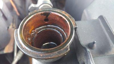

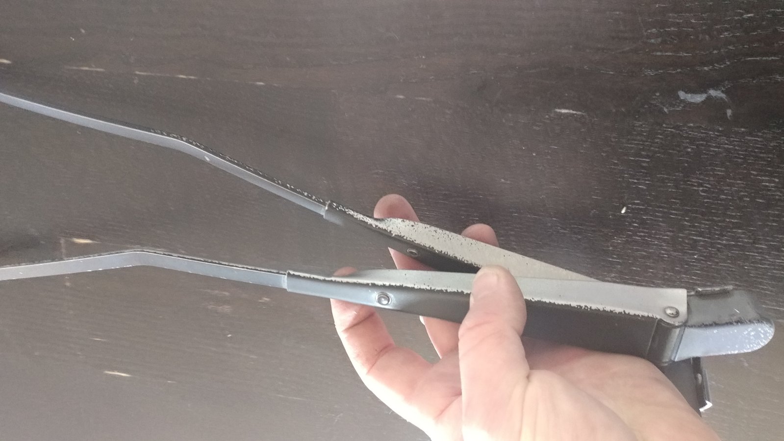

Refurbed wiper arms. Replaced 10 year old wiper blades. Flushed the rad. Backflushed the heater core. Cleaned out the overflow tank. Replaced upper and lower rad hoses. My little man helped me out hes not a huge fan of pants.
Still needs the block flushed out. Ill have to yank the thermostat at some point and blow that out. It was so full of dex junk. All the water had evaporated and the dex turned to sludge. Its on its second round of chemical flush atm.

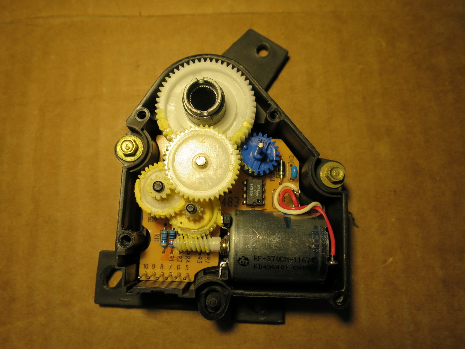

Took out the blend valve actuator that's been making weird noises and opened it up. Nothing interesting in there. I cleaned some dog hair off the assembly and it made less noise moving around than it did before. Probably coincidence.

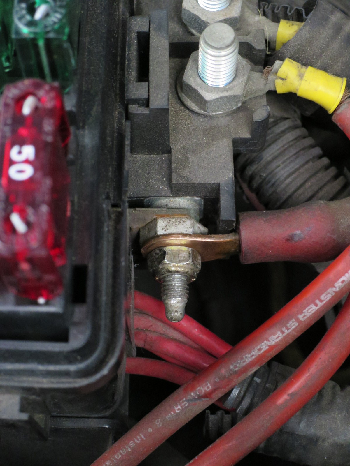

Cleaned up the main power cable to the fuse block. Noticed a bit of corrosion on the bus bar. Will revisit it.

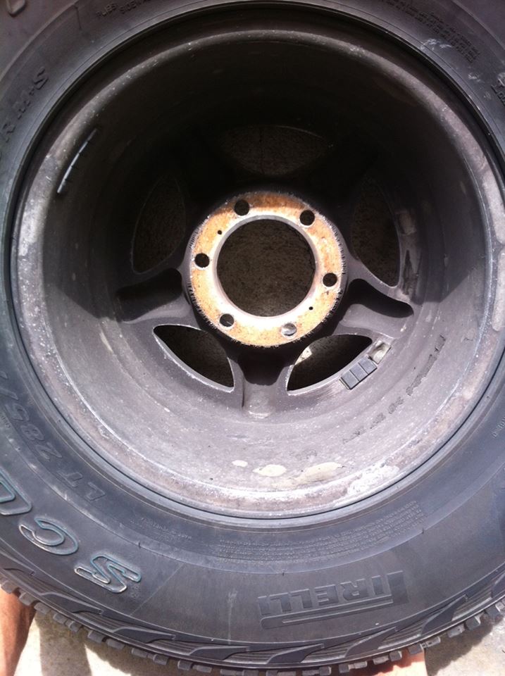

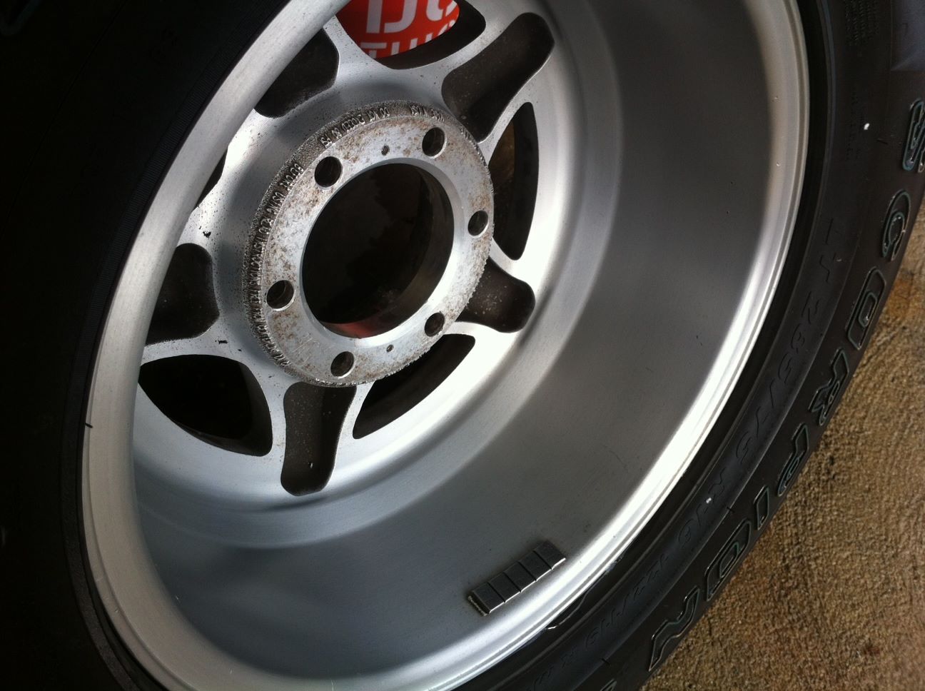

Just because I looked at them today, here's a before and after of one of the most satisfying jobs I've done over the past couple years that I still appreciate the difference today. Although they're nowhere near as clean as the pics, I still notice the difference. Soap and water, Scotch pads (I think I used light grey), aluminum polish, elbow grease, car wax. Nowhere near perfect, just cleaned up nicely.
View attachment 217149View attachment 217150
Great job, looks new.

Made the wheels look better/brighter from the outside, and less like a pos from the rear/inside too. I still like seeing them cleaner while I'm under it, as I often am lately. They had 20 years of crap on them and it took about an hour or two of hard work per wheel. Obviously only for polished/bare aluminum.
