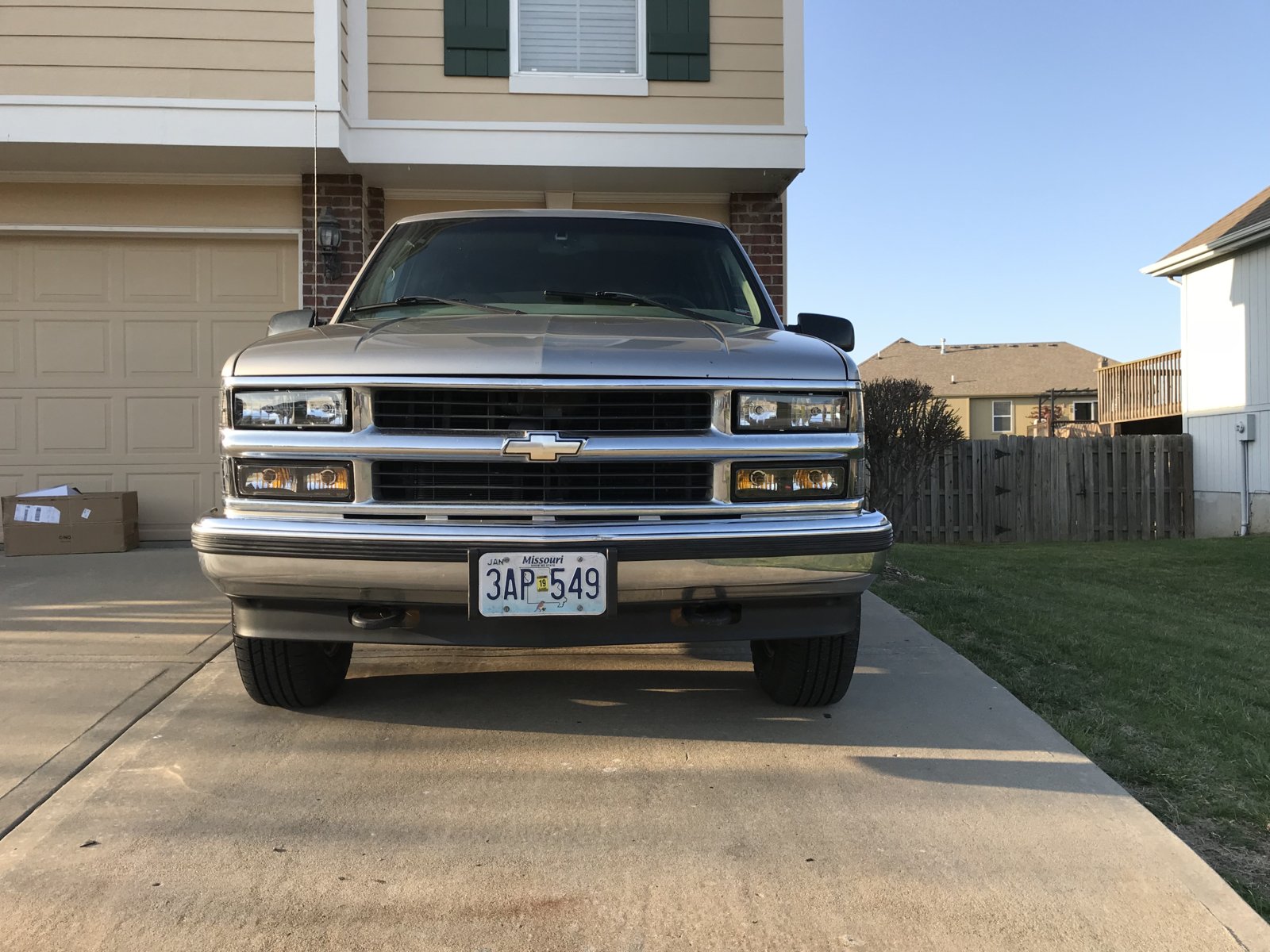

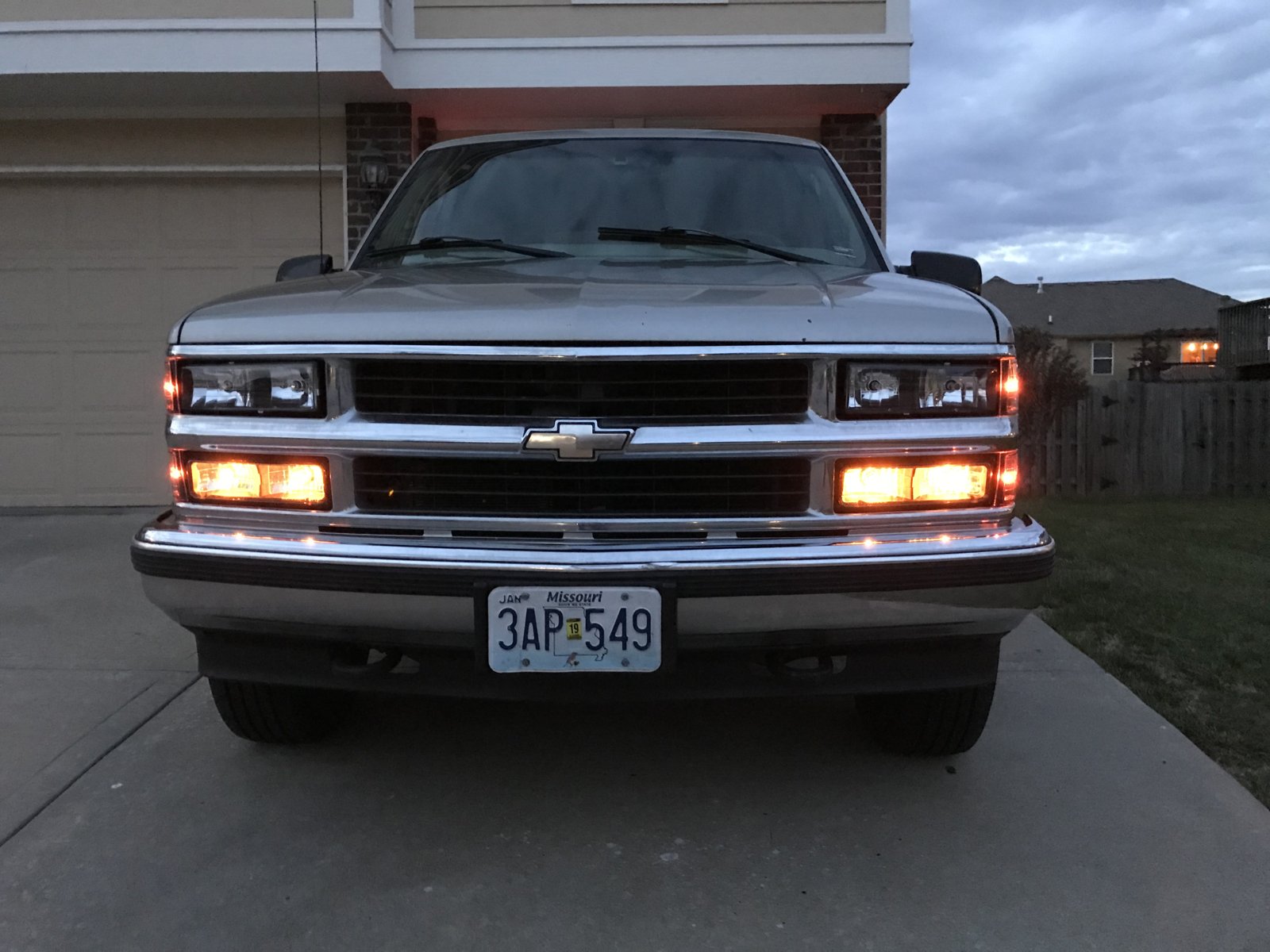

Nice! How? Cut and paste using bottom marker ?
Get the corner lense pigtail. And you can get an old bottom mark and in weld the hole into the top marker after using a dremel to clear space but I just carefully made my own hole that the connector would fit into

Saw a few videos, looks sinple. Ive had the same idea and kinda wanna do it on my nbs but might be too much. Looks perfect on a obs, and yours look great. Should swap those halgens out for amber leds

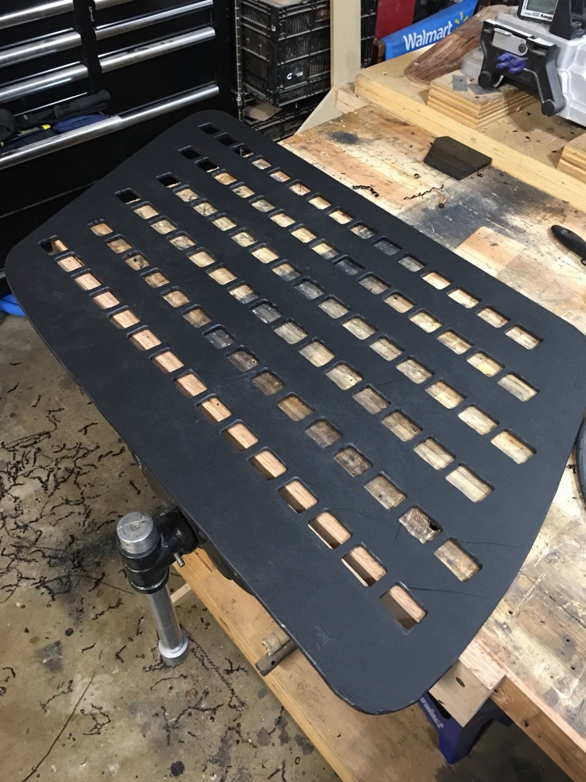

Finally finished a rigid molle panel for my right rear window, I’ll install it tomorrow or later in the week, still need to fab some brackets for it
How did you make this..? Been wanting to do it it mine.

It was kind of a pain in the ass, had to make a template first but only for one row out of 1/8 fiberboard, then use that over a piece of 1/4 HDPE then used my router to cut it out. I looked everywhere for one that will fit our trucks and no one make one. Thought about doing a full fledged production run of them. Just have to get enough interest
