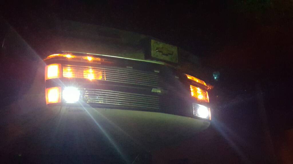

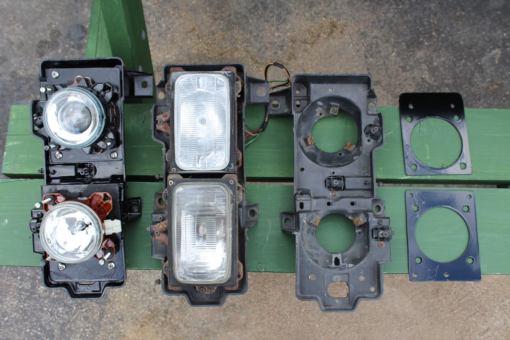

Those look awesome! What projectors did you use? Are they just sealed to the back of the headlight or do you have some sort of bezel around them? I wanted to do a retrofit so bad before I switched to my LED setup.

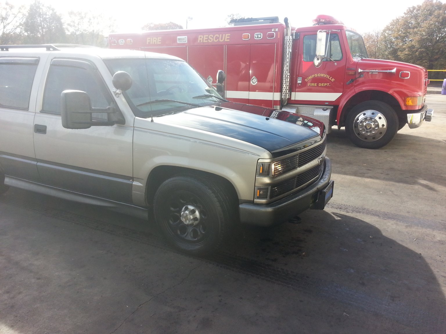

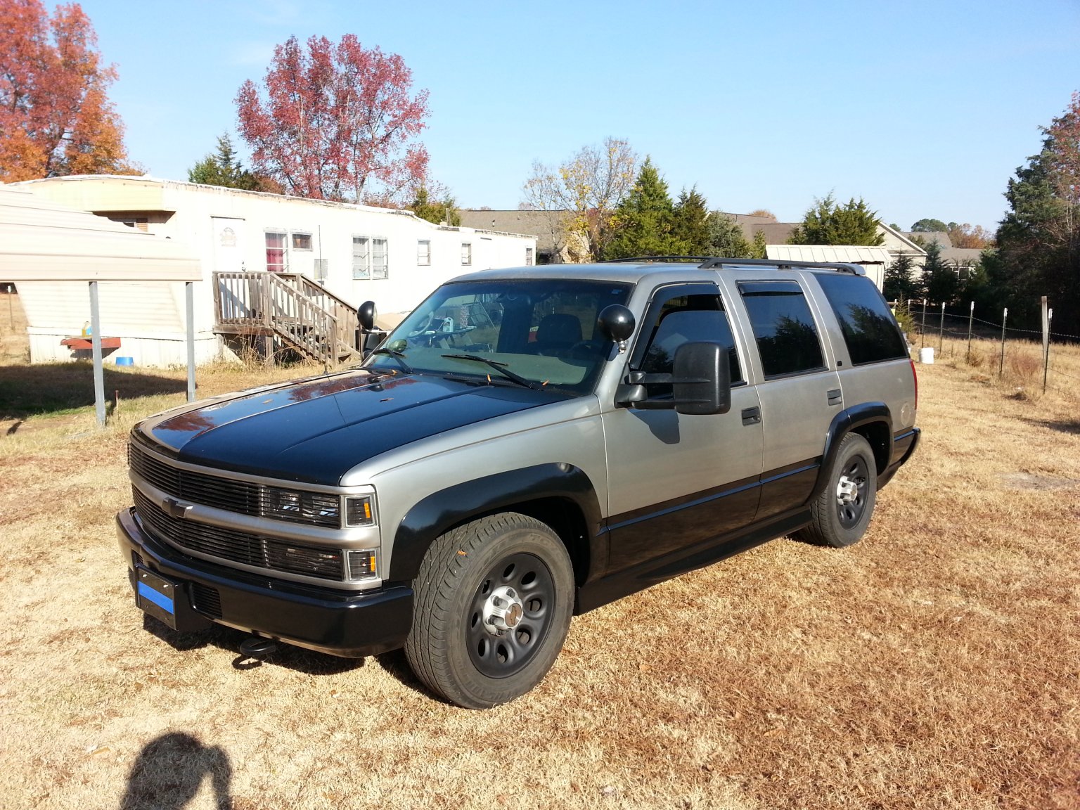

Been a little while since I've been on. Did some painting on the good o hoe a few days ago and I believe it looks so much better with the black bottom. That do yall think?

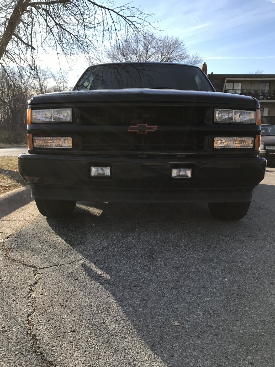

99YukonSLT
They are Hella 90mm modules which are weatherproof, or at least they have been so far.
I used 1988 headlight brackets and made 16 gauge steel adapter plates.
The high beams fit easily but the Lo or Bi take some drilling and grinding to remove interference between the plastic bracket, back of the lights, and where the back of a 2 headlight type bucket would go. Lo beams can use a round hole in the adapter plate but an odd shape for the Bi’s. Of course I forgot to take a photo of those before mounting them.
Have gone from stock 97, to 1988, 1988 with relays to eliminate voltage drop and enable all 4 lights for Hi beam, Hella HID Hi and Low and now Hella HID Hi and Bi Hi/Low. I think that will be it for this year.

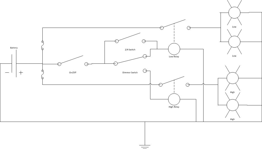

I think the 1988/89 is the best looking setup and with the relays for full voltage it is amazing how bright the sealed beams are, and how trouble free glass lenses are. I have a 1988 K3500 that I installed relays on last summer, and a selector switch for 2 or 4 light operation. Wish I had done that years ago. I am the original owner and never realized how dim they were. Found the extra 88 lights in the junkyard for about $50 a set. The selectable 2/4 is kind of nice depending on if there is snow on the road.

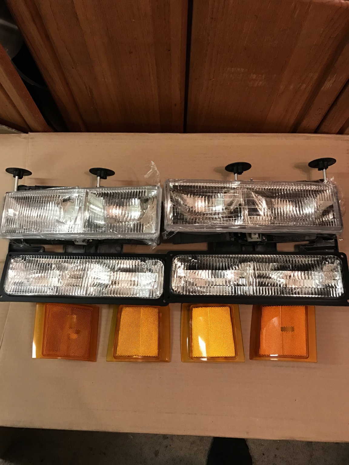

Bought some oem spec headlights. I had smoked headlights on her, but didn't like how my hid kit looked. They made my 5k hid kit look blue.
