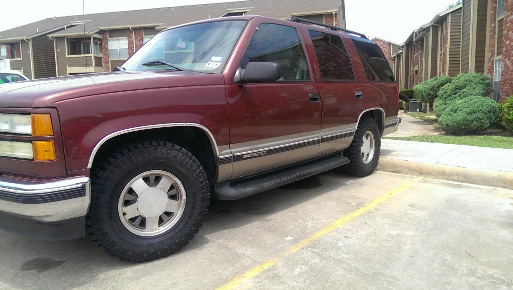

Finally replaced the old crappy highway tires that were on the Yukon. Got these 31x10.5 for 730$ at Sams Club including installation! Got a pretty sweet deal considering how expensive the duratracs usually are. I've fallen in love with my Yukon all over again!
What do you guys think? Ditch the factory running boards or keep them? I don't really need them to get in and out since I'm fairly tall but I do find them convenient sometimes
Nice color combination :thumbsup:
But i like to running boards on mine. They sort of serve as a door mat lol

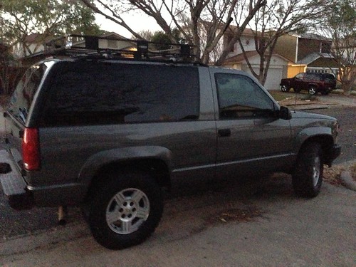

Thanks! I love yours, thanks for the picture! Now I can see it without them and I love it. I do like the function of the running boards unfortunately which is why I'm so torn on what to do with them.
Did you replace your "1500" door emblem with a Tahoe emblem or am I seeing things?? Ive been wanting to take the faded gmc1500 tags off my doors and put newer Yukon badges there but wasn't sure how they would look!!

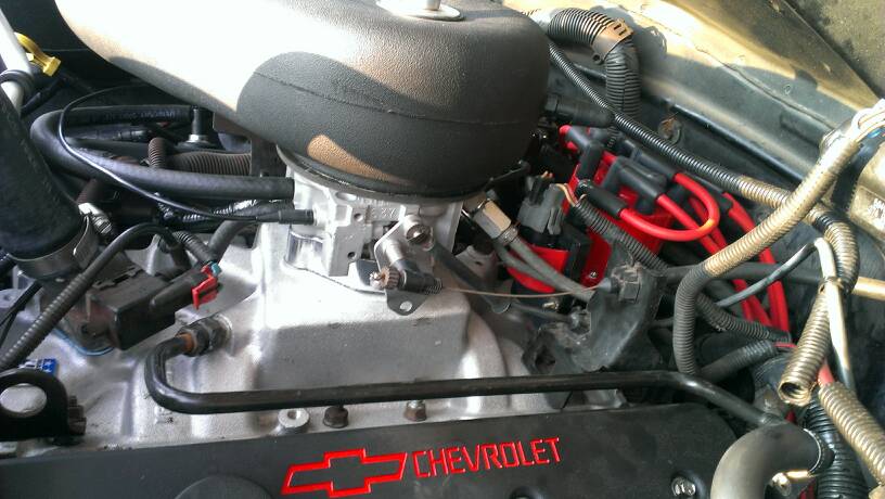

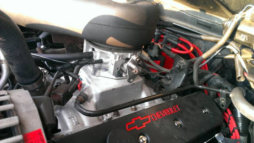

Put on the modded TBI unit, along with a TBI spacer and spliced in new injector wiring (had spots where wire was sticking out) ill post pics latter

looking good. i see you have a bracket to mount and a convoluted tube with nothing in it.
---------- Post added at 05:17 PM ---------- Previous post was at 05:16 PM ----------
i take it the new manifold setup is creating the slack on the throttle cables?

Ya thats causing the slack, still shifts and drives great, is there a way to get the slack out?

look at it this way. have someone hold a wot(engine off of course) while it is being held grab the shaft and see if it will open more. if so find a way to tilt or move the shaft back while keeping the cables relatively straight going into the sheaths. just need to have some minor slack with out killing extra input from peddle. cruise cable not as important on slack for the most part.

That engine looks dope
Thanks
