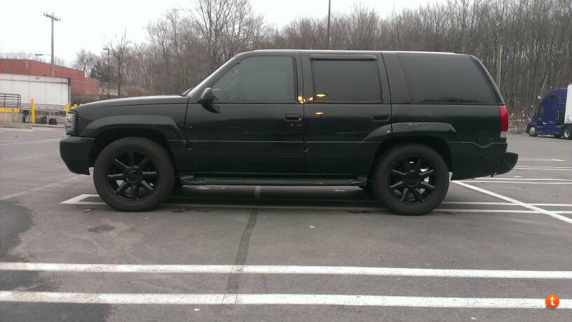

Took some better pics of the rims

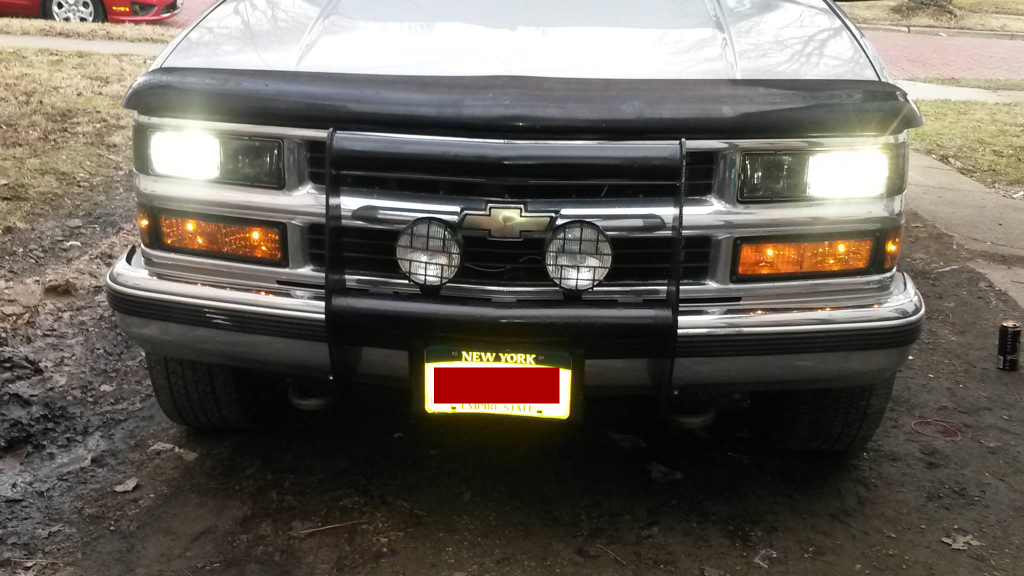

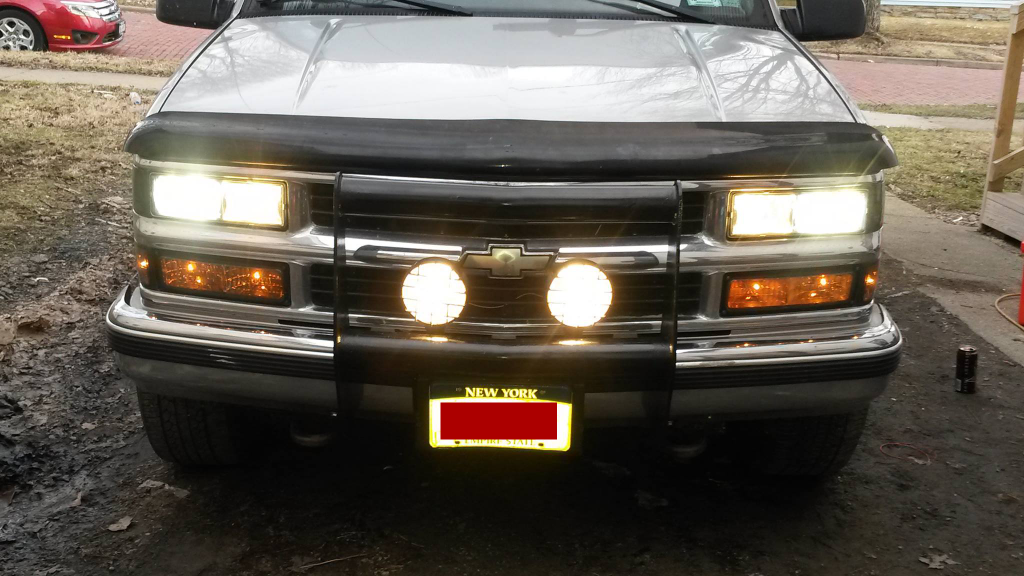

4 lo, 6 hi mod. did the 4 hi mod with the relay in the original fuse box, wired in my driving lights to the high beams and by using a 1 amp rectifying diode (1N4001 from radioshack) so that when then highs are on the fog lights (that i'm going to install in a new diesel bumper) will turn on with the lows and off with the highs automatically
now i just need to install the 6k driving lights, and get the HID hi's

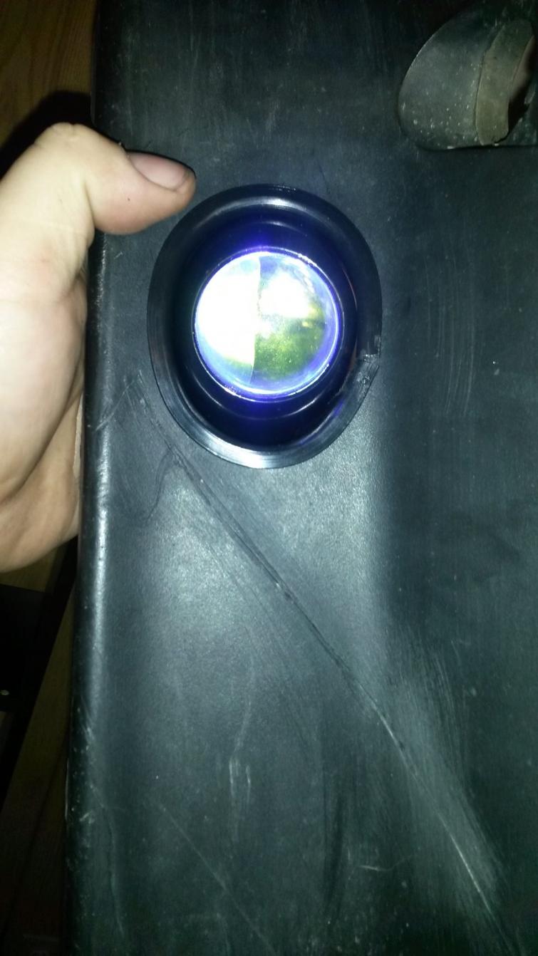

cutting out holes for fog lights on the new valence, i need to find some good plastic filler for the scratches, i've plastic welded the cracks and the missing mounting holes back together.

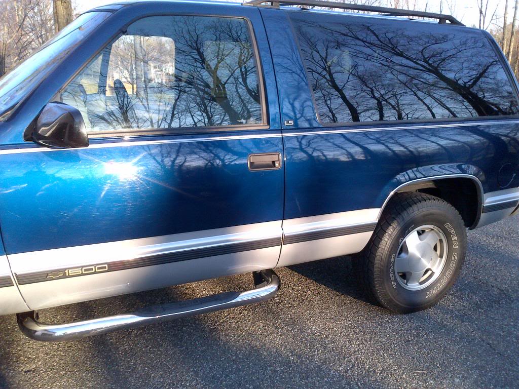

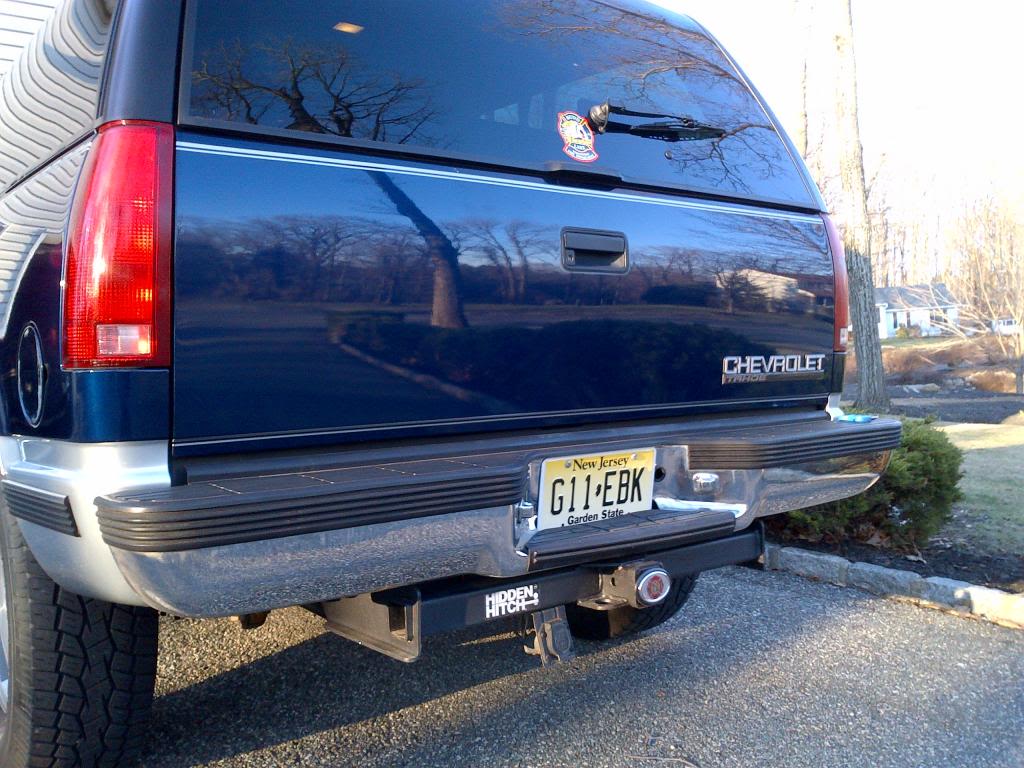

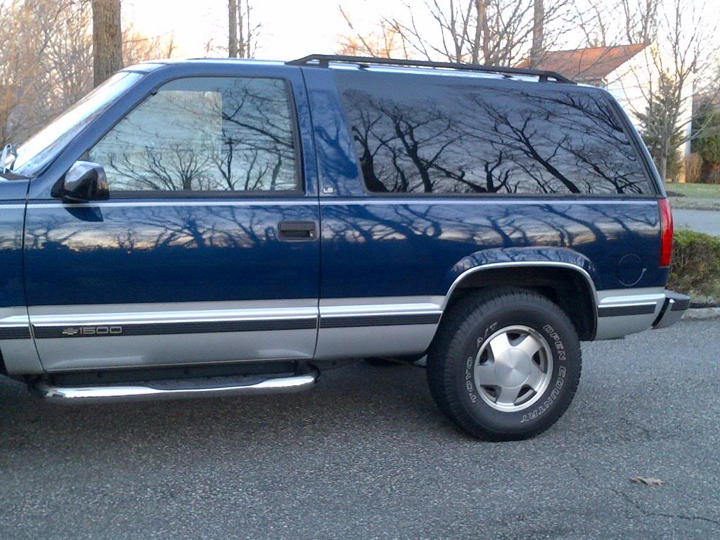

pinstriped
so the trend is to remove pinstriping... i thought the truck needed a little something on the waistline. put some silver vinyl down , and on the tailgate put an upper and lower stripe. i thought the lower one tied in the two corners of silver rocker color.
