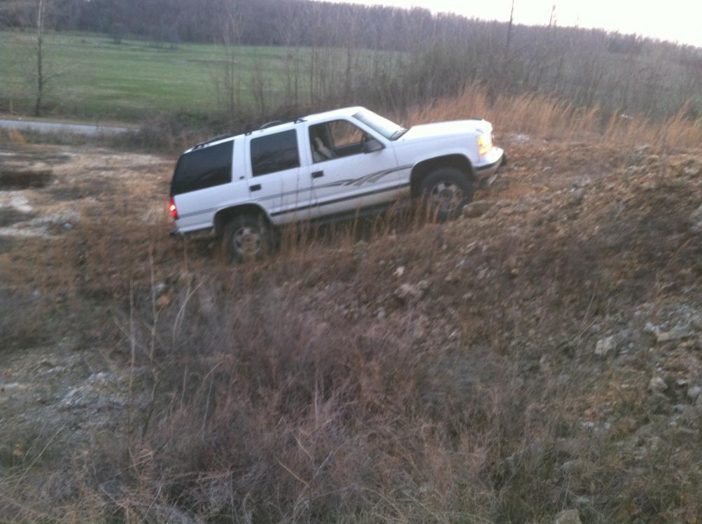

Got my ranchos on and when crawling. :driver:
