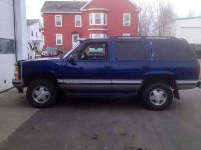

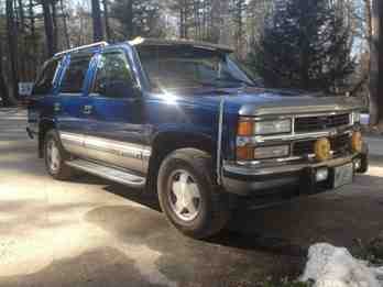

Rough country add-a-leafs in the back, and rough country leveling keys up front. Ended up with 1&3/4 inches and it's awesome down the road!
