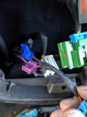

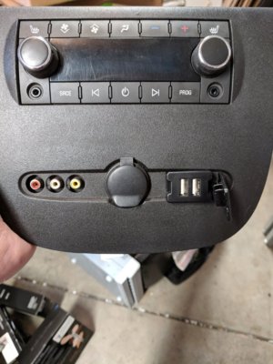

added a couple usb ports so I can still have the 12v plug for whatever reason, I used my last 2 taps can't find these locally anywhere, guess I will have to order some more online, I was hoping these usb ports that ordered and took a month to come from china would not have a led inside but they do, this was very easy to do.
