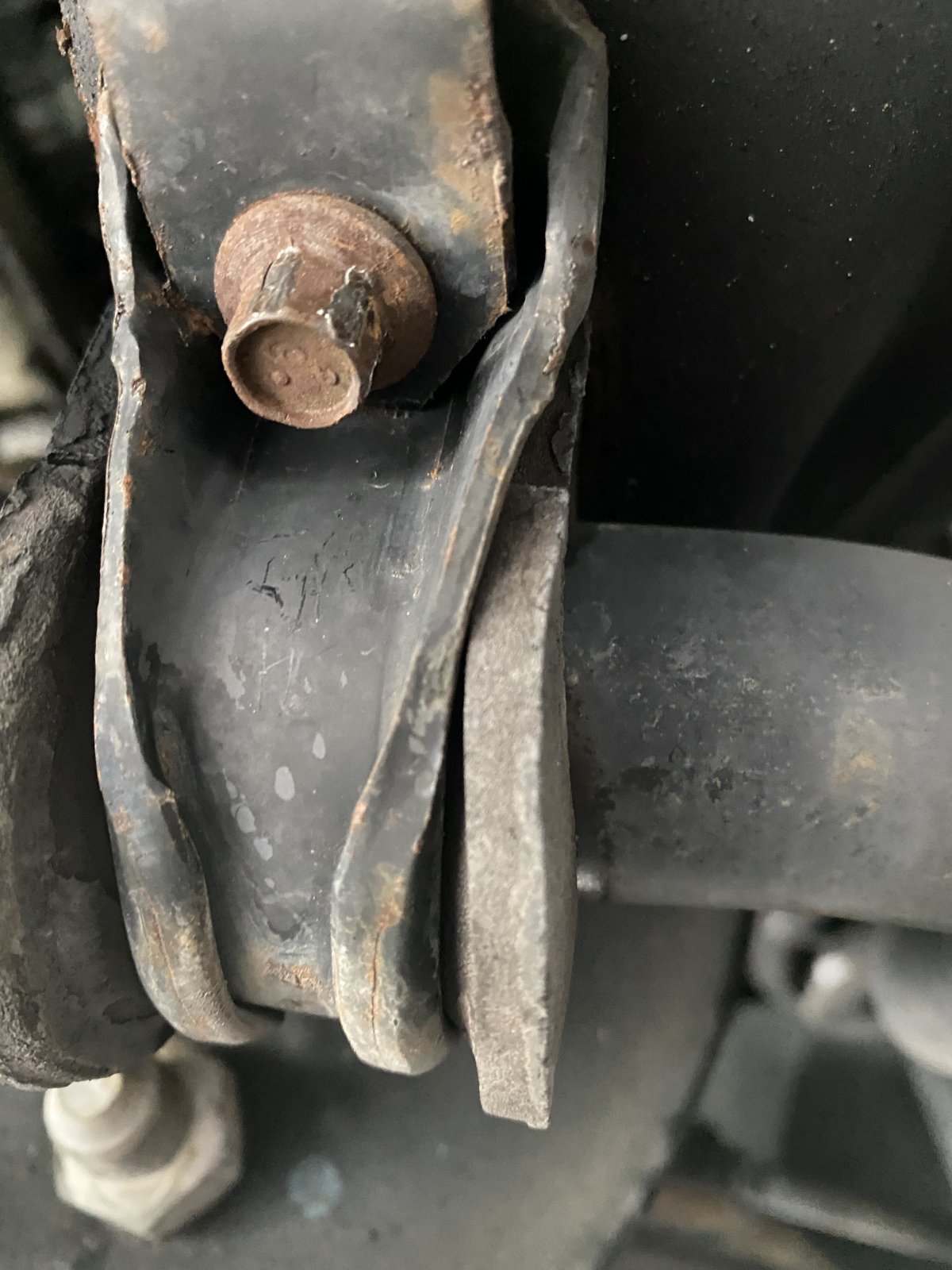

Put the Suburban back up on jack stands this morning. Removed the driver side sway bar bushing and gave it a good glob of grease. Went to remove the passengers side and one of the bolts will not budge. Rather it wants to round off. Tried a 6 point and 12 point deep socket and had a look at some vice grips. NOPE!! The sockets want to round off the head and the vice grip is not really going to work due to limited spacing.
Any further thoughts on getting that bolt to move without making the head into a marble??

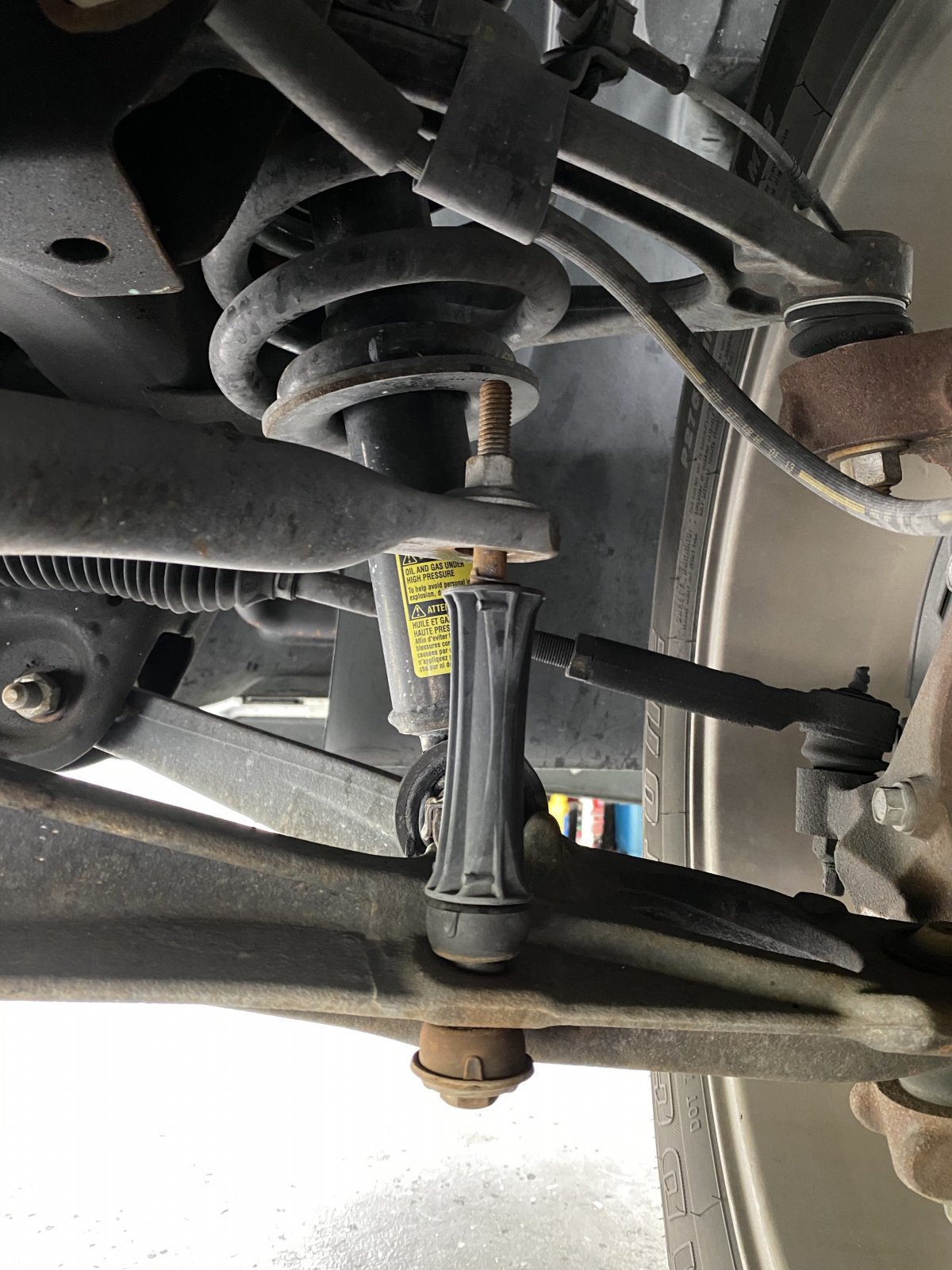

As I was messing around on the passenger side, I think I found my clunking issue.
The passenger side stabilizer bar link bushing is gone! I guess I overlooked it in my hurry or maybe it finally just popped off.
Missing bushing under the sway bar.
Sway bar bushing bolt wanting to round off the head. 10mm.

Here are the stabilizer bar link kits I am looking at. Moog Problem Solver which is what I put on the Tahoe.
Moog K700538 Stabilizer Bar Link Kit

man that sucks, I would say heat it up with a torch real good but that means you will probably need new bushings, if it refuses to come out you might have to get a grinder out and cut the bracket off on that side then you will have room to work with it. My guess is your going to need new end links, bolt and some d brackets and bushings I don't think they sell them separate.

Been there my friend and know how much it sucks.
A couple of thoughts in addition to those already offered up since the bolt is toast already.
1) if you can get a cutoff wheel and cut a a slot in the head of the bolt and then take a manual impact driver with a stilled screw bit and try that. They work well for breaking loose rusted bolts due to I’m-line impact and rotation at the same time.
2) weld a nut or bolt to it to extend it out past your bracket.
Had all 4 bolts break off on my ‘07 and had to drill them all out.

I'd try spraying some penetrating oil (Kroil, PB Blaster, etc) into the thread area and use a bolt extractor socket (I have a Craftsman set) to get that bolt out.
Last month my drivers side end link was busted off at the bottom and I used the same replacements that you have linked to. Just remember that they are sold individually and you should replace both sides. They get torqued to like 17 ft lbs

Oh crap you’re going to have to hammer on a 12-pt socket after heating the shit out of that bolt. I have a Port-A-Torch oxyacetylene kit that will get it cherry red but a long time with propane may work too. Find a 12-pt that is just a tad smaller.
Probably time for a drill bit and easy out on that bolt after a good soak with PB Blaster and maybe heat like Sam said. Those end links are a common failure due to a ****** design, they trap and hold water. The Problem Solver line is there because GM has a problem with some of their designs lol. Good choice.
Edit: you might want to look into some sway bar bushings with grease fittings like the poly ones at Energy Suspension so you never have to remove those bolts again.
Yeah I remember you changing out to the Energy because of the zerk fitting to make sure it is able to be lubed.

Thx guys for all the input for myself and others. I put the Moog Problem Solver set on the Tahoe as well and I will be changing out both sides for the NNBS. As said, I got 3 of the bushings lubed and may consider changing out to the Energy Suspension zerk fitting type later on.
Thankfully that rounded bolt head on the passenger side sway bar bushing is still intact and holding the bar tight, so I can deal with that later.
New end links should stop the clunking and off to the next item. lol. Thx guys.

If you end up having to cut that bolt head off, a left hand drill bit will get the remaining threaded portion out no problem.
