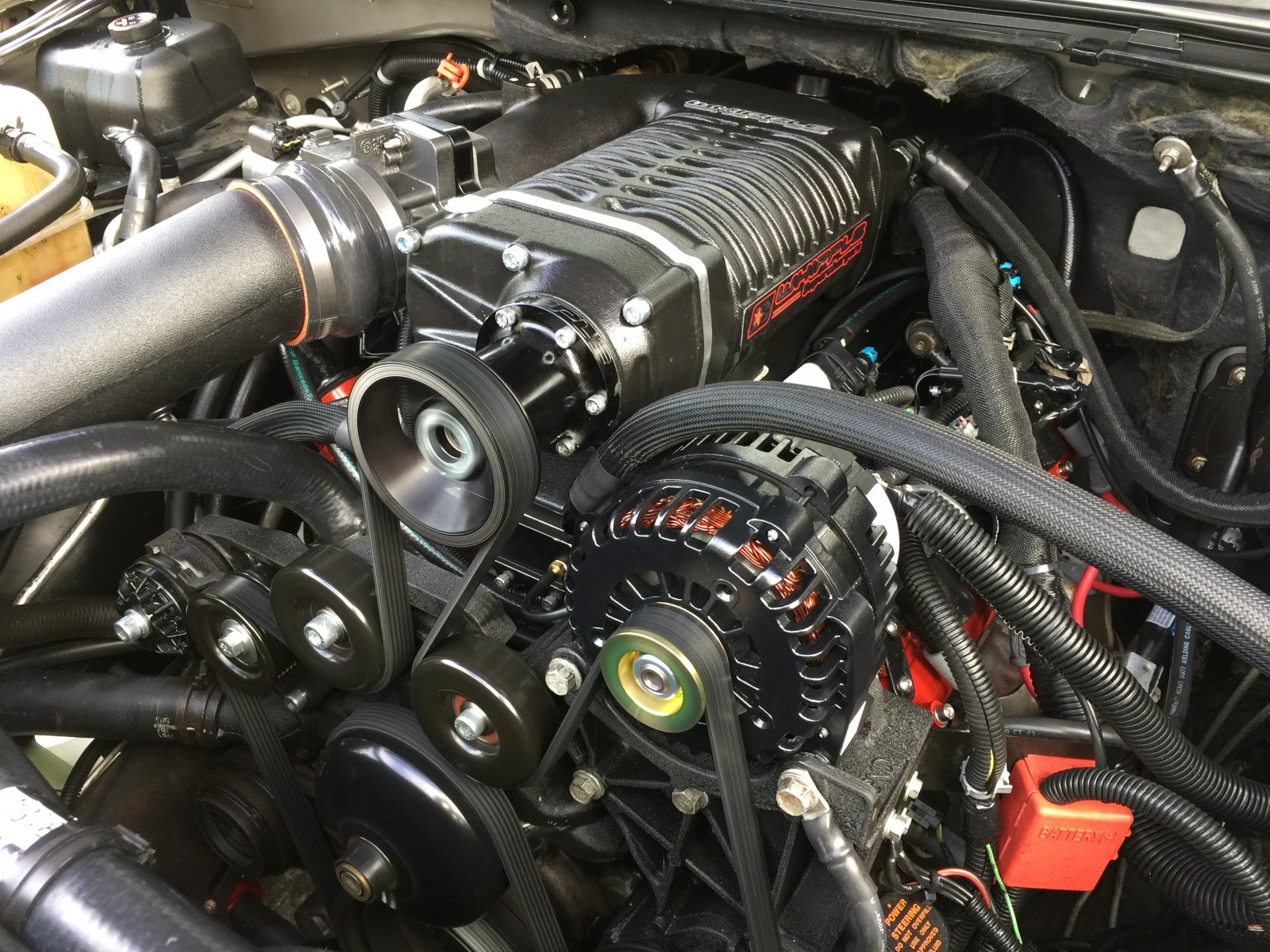

The only engine covers I’ve ever liked are the Corvette ones. And they don’t work with the 5.3s or the truck intakes.
Anything is better than that mess that’s there when they're removed. Even when guys try to shave the intake manifold and paint it, it still looks terrible. It looks like unfinished business and there’s no way to clean it up. A supercharger does it, by eliminating the ugly intake manifold and replacing it with something that looks nice, plus all the wiring and hoses are redistributed so it looks clean. Add some billet coil brackets, paint the valve covers or buy some nice ones, nice looking alternator, etc and it’s good to go.

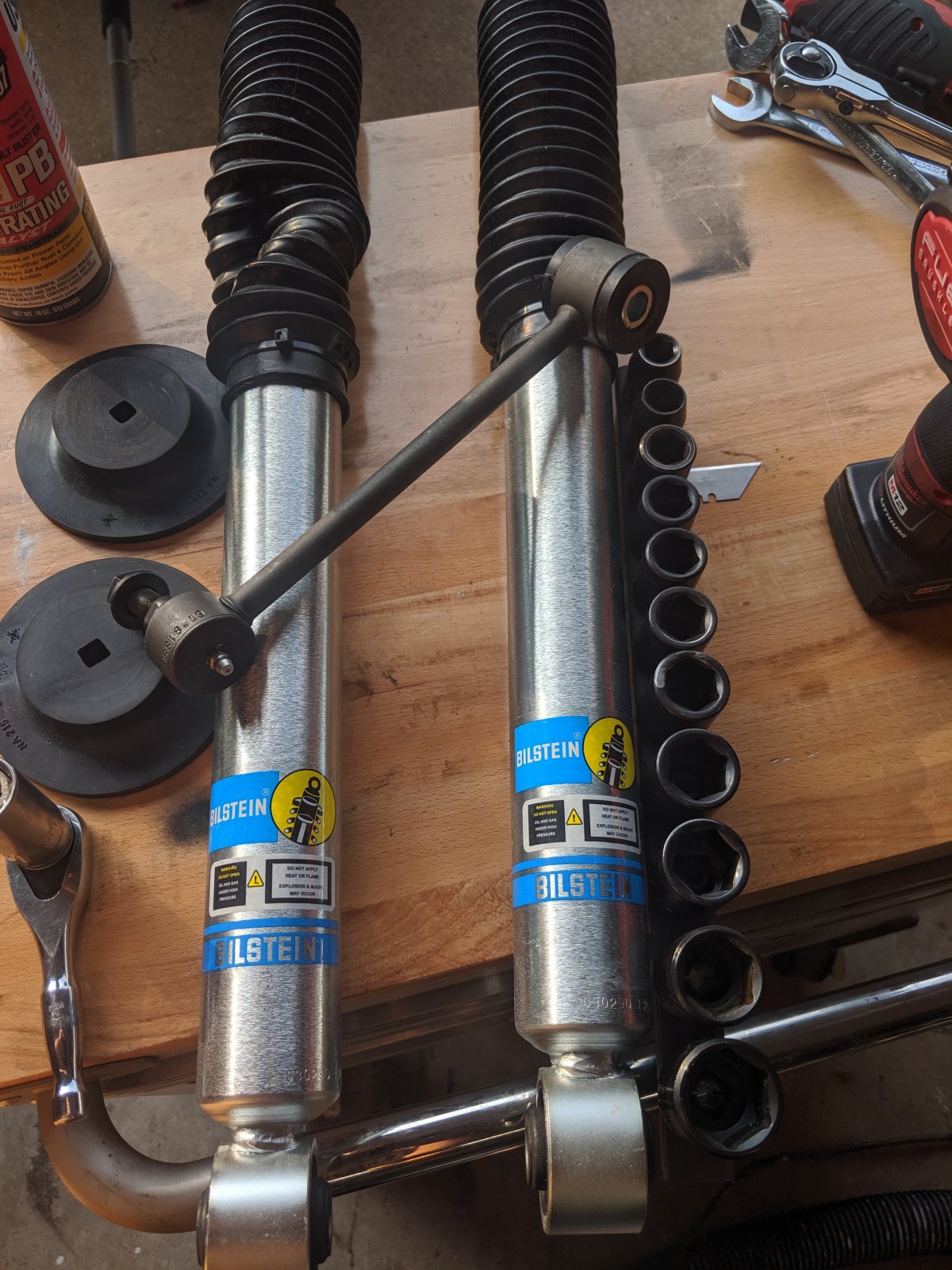

Finally, the rear Bilstein 5100s. Tried for Z71 springs but could not get to cram in there. Ran out of light, time and really it looked as though the springs were replaced. The PO towed a horse trailer: I would not be surprised if they are Z71 springs for towing purposes.
New rear sway links as an already in there job, too. Replaced w/ Moog.
Found a weatherpack connection disconnected. Rear, above exhuast and on top of frame rail on pass side. I plugged it back in..
Now I have an ABS and TCS light. I'll Chase them rabbits later. First I will clear codes to see if they reappear.

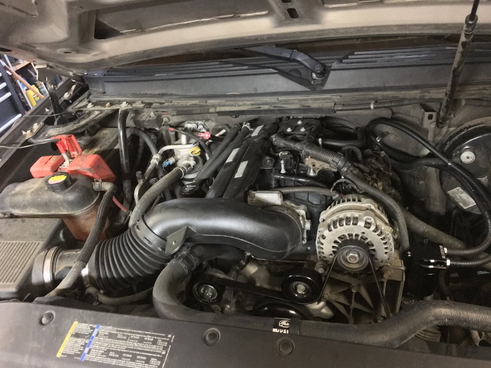

Only thing I don’t like about how the engine looks without the cover is the resonators on the intake tube that go down by AC lines (cant see in pic) and towards the rear of engine. My christmas present to myself will be the air raid intake tube that doesnt have the resonators.
Other thing I don’t like is the harness that crosses the engine on top but there’s nothing I can do about that.
I thought you were gonna trim off those chambers and epoxy over the holes?

Anything is better than that mess that’s there when they're removed. Even when guys try to shave the intake manifold and paint it, it still looks terrible. It looks like unfinished business and there’s no way to clean it up. A supercharger does it, by eliminating the ugly intake manifold and replacing it with something that looks nice, plus all the wiring and hoses are redistributed so it looks clean. Add some billet coil brackets, paint the valve covers or buy some nice ones, nice looking alternator, etc and it’s good to go.View attachment 231577

I still might. Really want to! I just can’t seem to find my dremel- and the dremel was same price as that air raid tube
I still want you to! I'm sure it could be cut with a utility knife. Or a hack saw blade? I'm a bit behind the times, but I discovered and bought one of these not long ago:
I wish I would've had it when I was slicing that PVC pipe for my center caps.

you might want to check the rear abs harness connection, the rear harness connects right where the top bolt for the shocks goes thru, there is a bulletin Arnott includes with there shocks to check to be sure you don't accidentally unplug them.
Yep!
When I swapped rear shocks on my ‘08, I read the bulletin, installed shocks, forgot bulletin, got error lights, remembered bulletin, fixed it.
