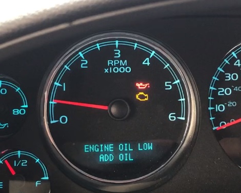

Now with that being said... I have never had the low oil level light come on so I can't say how low the oil level might actually be when the light comes on.
What I do know is that if the oil level doesn't show up between the hash marks and holes on the stick you are a quart low... if it's not showing on the stick at all you are probably closer to 2 quarts low.
My biggest concern with your method of "checking your oil level" is... what happens when the oil level sensor malfunctions for what ever reason???
You could potentially do great damage to your engine without ever getting a warning... granted the odds may be slim that this scenario would ever happen BUT it is a possibility.
I guess what I'm saying is that technology is a great thing, until it malfunctions. It's just hard to beat simplicity and a dipstick is about as simple, and reliable, as it gets.
