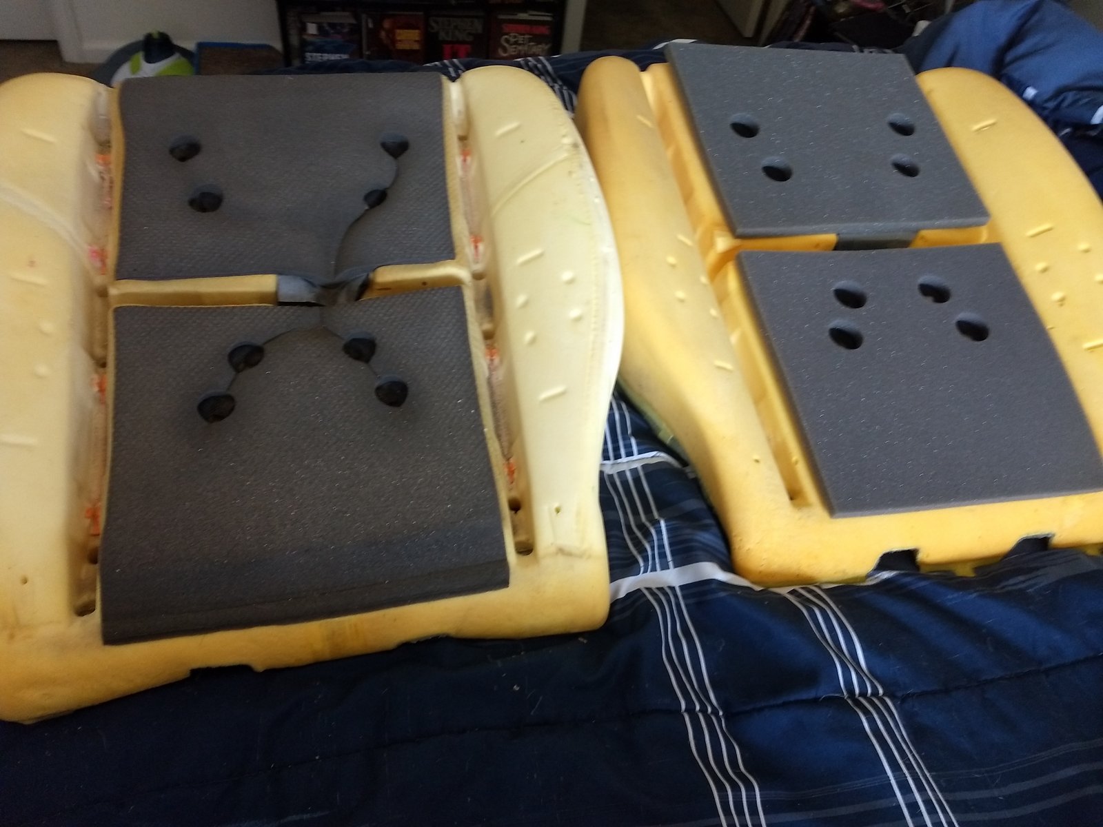

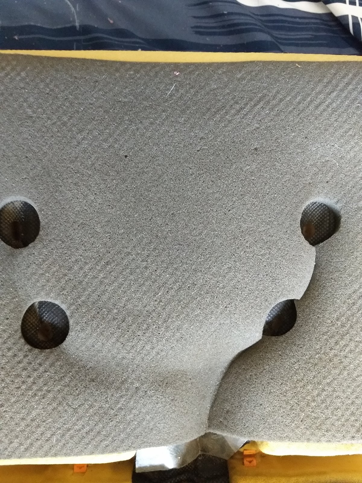

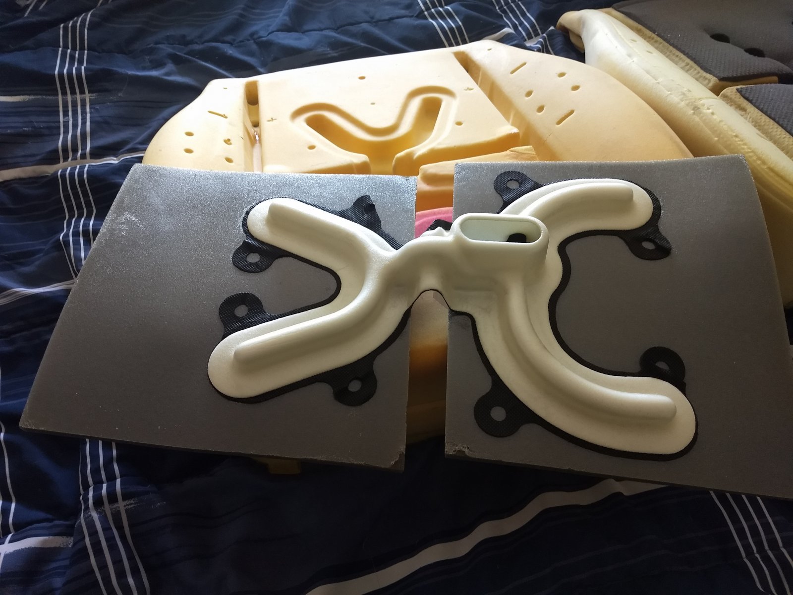

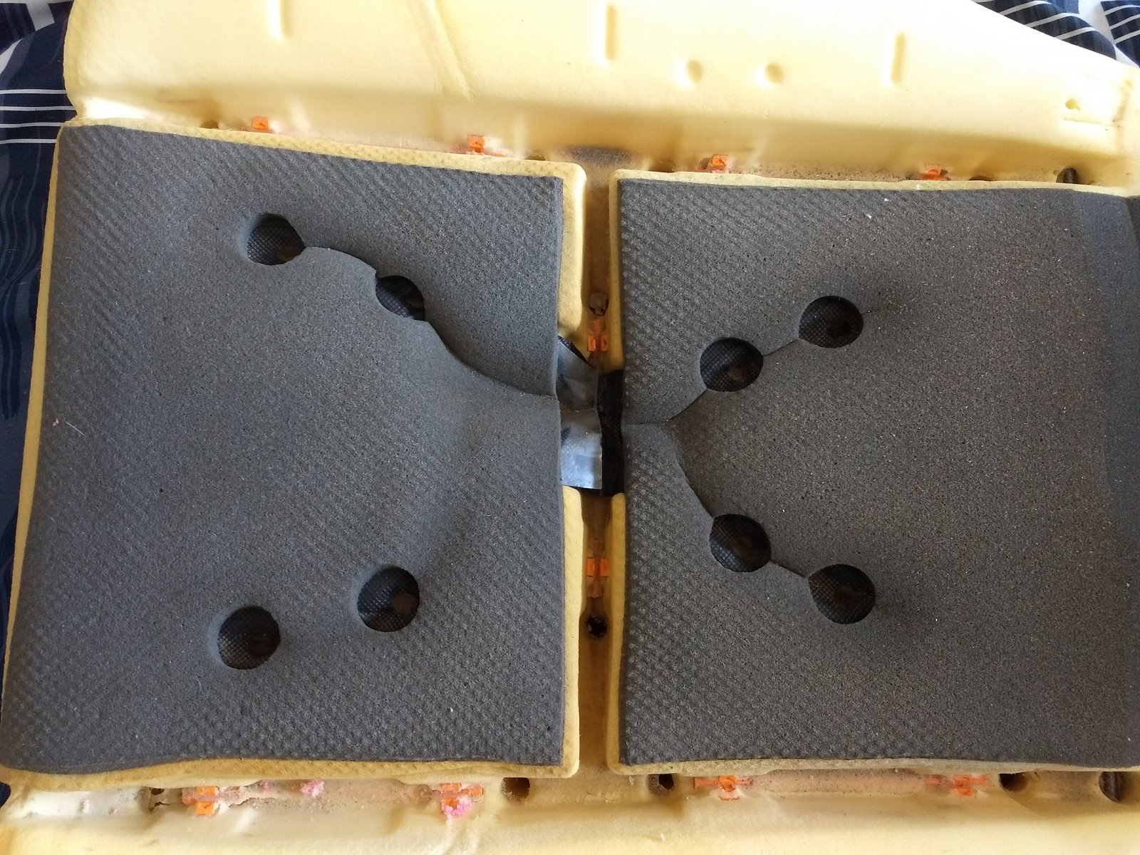

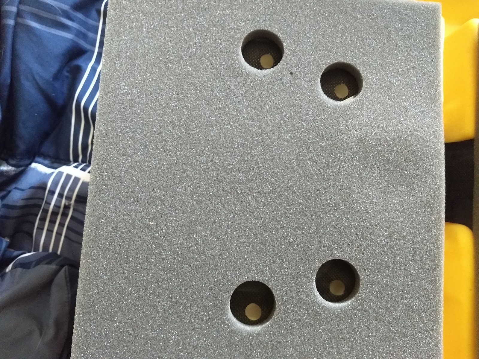

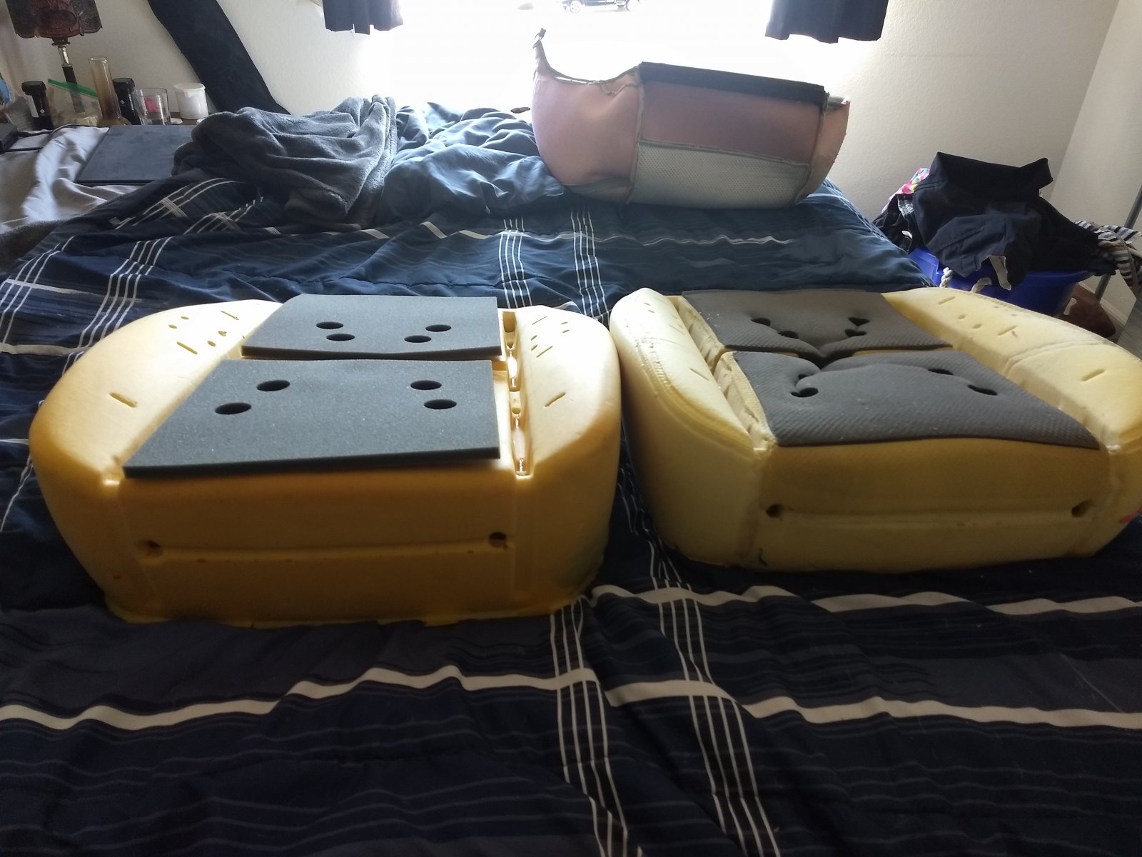

I replaced my driver's side cushion. The heat/cool wasn't blowing through the seat very well and half the cushion wouldn't get warm. Here's why:
On the old cushion, even the little ducts were squished closed on the one side.
Could it have been damaged from someone standing on the seat to look up through the astroroof? Though my seats are only heated and not cooled, that is my fear with having someone clean inside the astroroof area.

Mikey, is tgere a fan under the seat? Are those ‘ducts’ plumbed into the other ducts under the seat?
Yeah that's a fan and inside is a thermo device that electrical current flows in both directions. One way heats, and the opposite current cools. The fan then blows past thermo part and into the ducts
I'm guessing the original owner may have been a big guy that smushed the sides of the seat, and then I'm a small guy that fits in the center of the seat, so there was little side support. Or it's just 8 years old and just wore down.
Usually it's the outer side of the seat that gets the most abuse, whether you're big or small. That's the side that you slide in and out on.
I'm a big fat guy and mine have smushed down some since I bought it. A little lady had it before me. Heat still works but worry about it breaking if an adult steps on them to peer out of astroroof.
I was just telling my brother about this. He'll be borrowing the Tahoe while I fix his truck, and I gave him two rules: Use 89 octane or higher and use the side steps to get UP out of the seat before getting out. Don't do that thing where you position yourself like you're in a luge and slide out.
