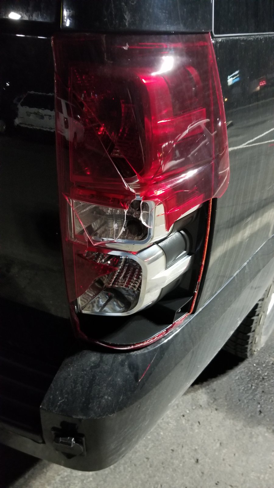

So I did this today;
Backed into my neighbors mailbox. I'm so angry about on call stuff that has changed at work. I've been called out probably a dozen times over ******** nonsense alerts. I was flustered and not paying proper attention becuase I haven't been out of the house all day.

Well, look at the bright side, now you have a good excuse to upgrade them if you want.

Always sad to see this hopefully body damage is minimal, as a profession box jockey(delivery guy) a tip if I may, always back in first. 1 it leaves you a clean escape if needed, 2. also eliminates risky backing into traffic, etc.. I know it's not always possible when coming home at night especially if someone is right on your tail.
