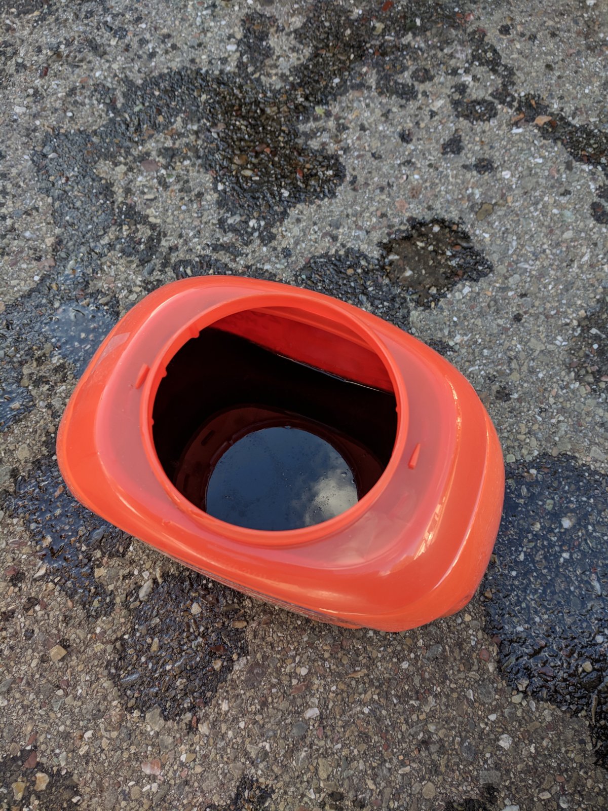

Flushed 64oz thru the power steering, looks like it's going to take more still looks kinda nasty

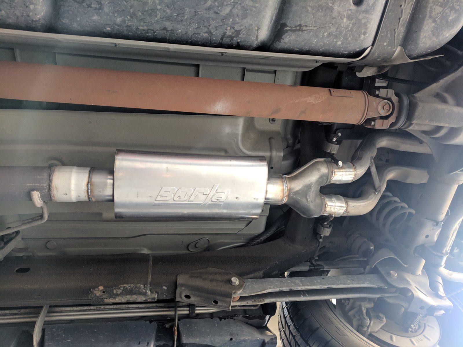

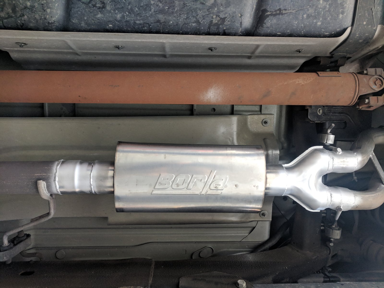

so this is the Borla from inside and outside, sorry my windshield wipers are noisy, it's kind of passive/aggressive quiets down a lot when just cruising but my phone mic is very sensitive, there is definitely a different sound than the flowmaster. this is the Borla xr1 sportsman

I need to do that. Was it easy?
very easy with a small hand pump, I just pumped into a mcdonalds cup so I could add back the same amount I took out, jacked up the front wheels and turned them back and forth all the way a bunch times/rinse and repeat, I ran 64oz thru it but it's still looking kinda dark so i ordered 2 more bottles and will do it one more time. I read it basically takes a gallon to flush it which seems accurate 1/2 gallon is not quite enough
