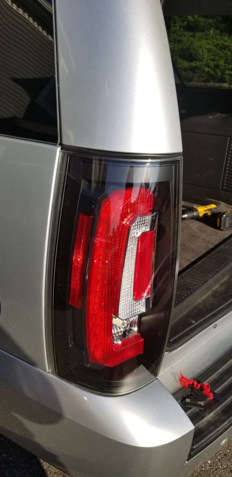

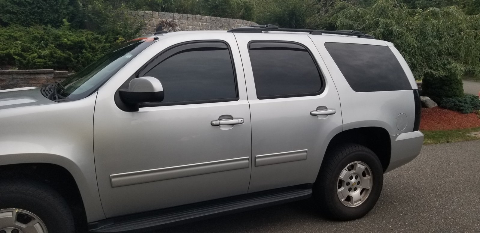

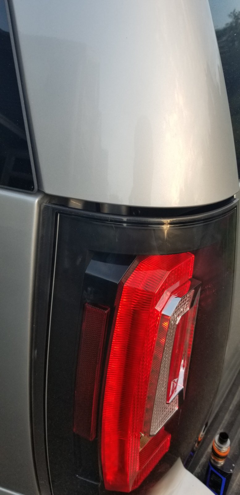

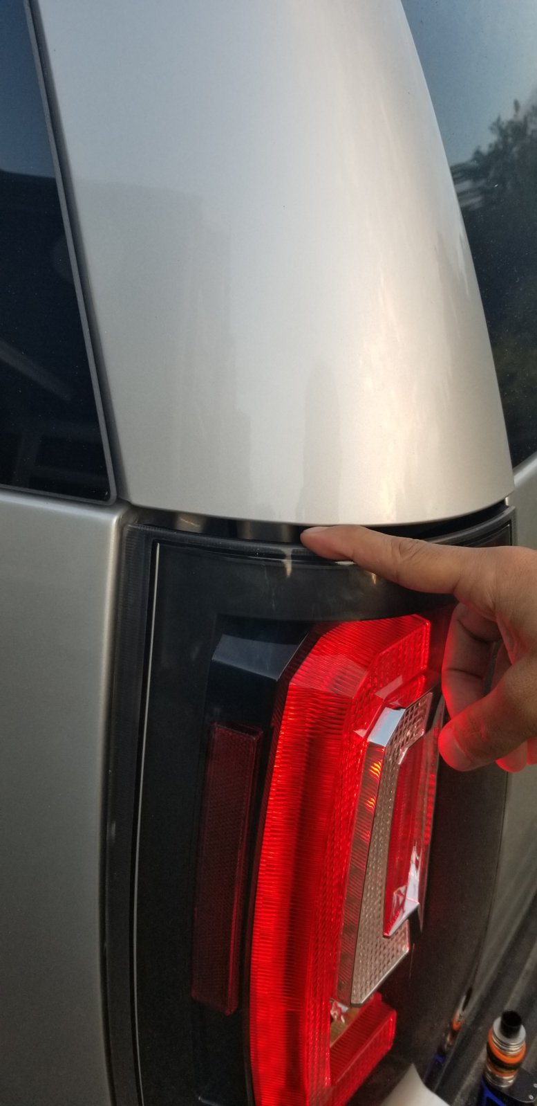

Finally got it tinted this weekend, 20% over factory all around with a 6" eyebrow up front. Got the tails tinted as well

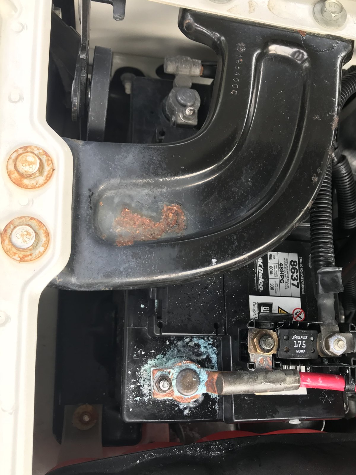

This is the 2nd time in 2 weeks that I have build up crud on the positive battery terminal.
What am I missing?
Don’t mind the rust on that fender support. That is coming off, drilling a drain hole so it actually drains and giving it a fresh coat of paint.
Thoughts and/or fixes on the battery? Thanks.

Well, it's green, so it's free copper exposed to the air. I'd clean it really well, as in, wash, not sand. Give it a good coat of penetrox or the like when you put it back.
Thanks for that info. Looks like Lowe’s has something similar, just not that name brand and a whole lot less $.
Aluminum to copper
anti-oxidation compound.

Ya, I would hit it with a wire brush real good and get one of those green felt pads and spray it with something I am sure they must sell some anti corrosion stuff at the auto parts store.
Thx.
I wire brushed it and used vinegar the other week to dissolve/neutralize the oxidation, but wasn’t sure how to attack it and keep it from reoccurring. Some
good tips here.
Aluminum to copper
That'll work.
good tips here.
The brush or scotch Brite is good for getting it off initially, but both will leave free particles behind (microscopic pieces of the tooling and the work piece). Removing these is the key. The grease is a good protective measure for the dissimilar metals.
What am I missing?
I like the spray-on protector/sealers. The one I used years ago and never had a problem again looked like I poured candy apple stuff on the terminal. Grease and penetrox work, but they can be messy.
