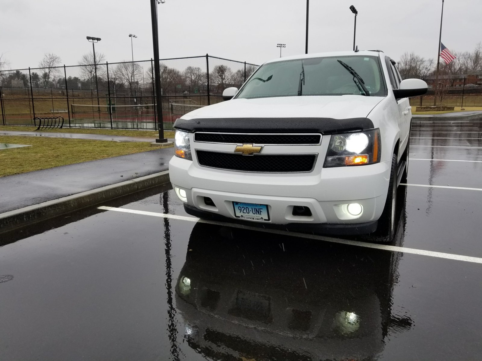

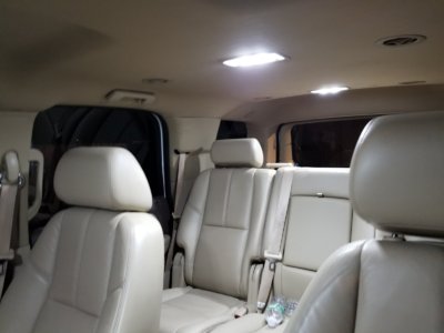

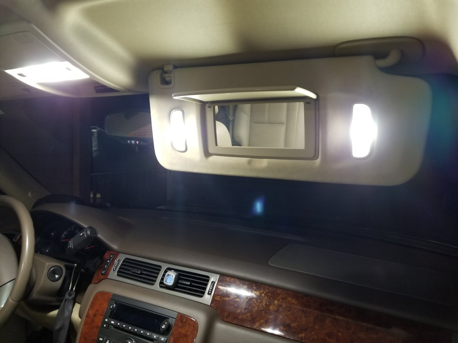

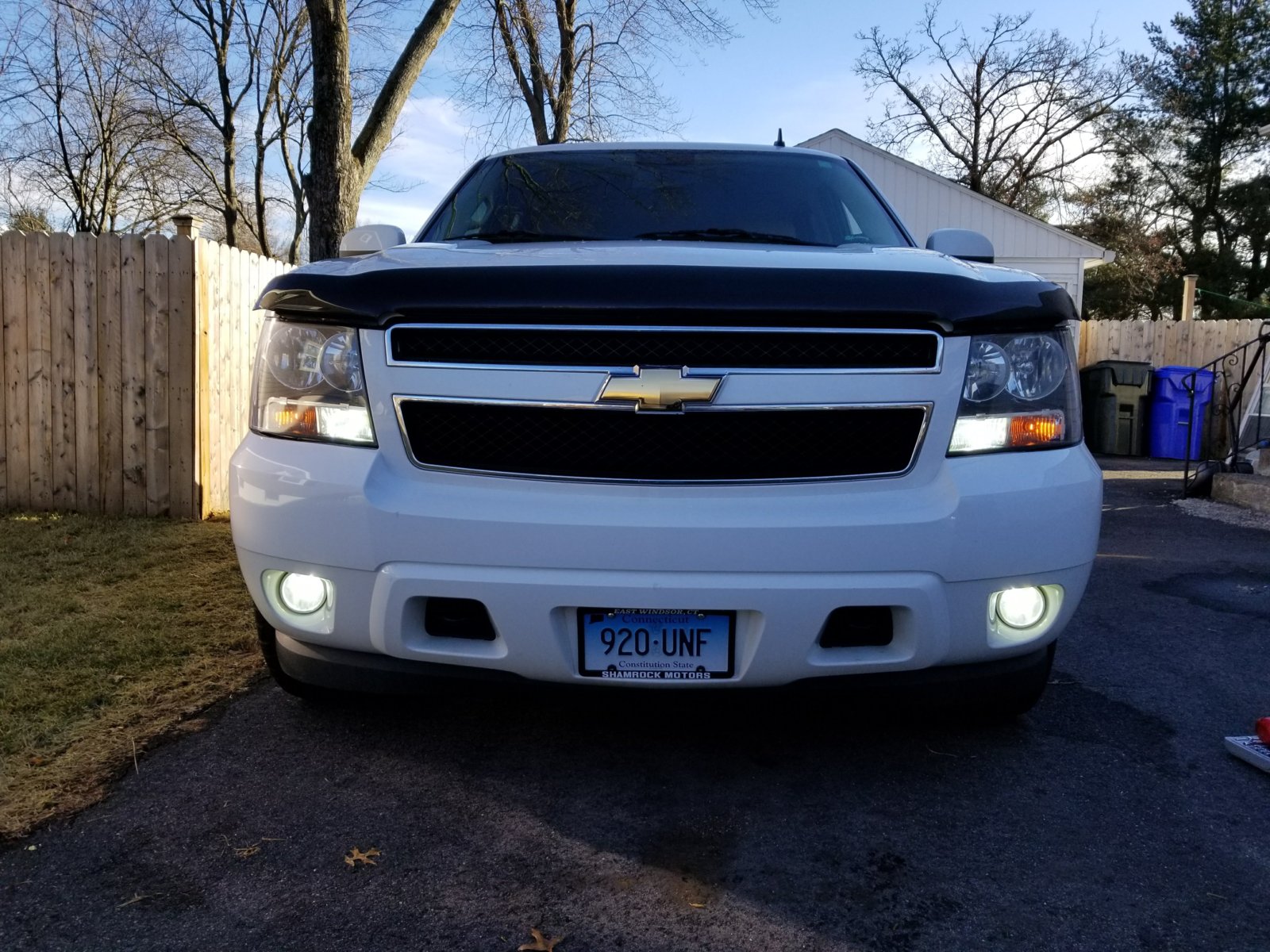

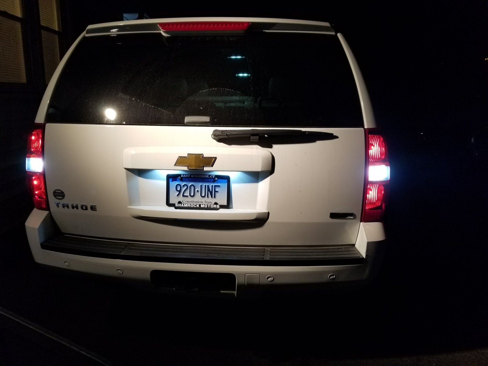

Today I installed the last LED (for now) in my LED lighting upgrade(did headlights today). I am happy as heck with this setup (again for now LOL).
Thankfully after a lot of research, I didn't have to actually remove the front bumper

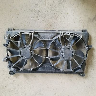

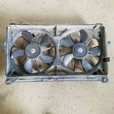

the shroud is bigger, one side is 9 blade the other 7 blade and the motors are 700w each versus 500w each, the stock one on mine has (2) 5 blade fans, fitment is the same frame wise but the HD shroud is about 2.5" thicker probably because of the bigger motors but I will know more once I dive into it, this one is from a hummer. I don't really have a specific reason for doing this other than it's freaking hot here in the summer, not really desert hot but hot enough and I just like things a little more heavy duty than normal I am kind of rough on my vehicles. I am going to take these old motors out and pressure wash it and clean it up and try see what I can put on it to make it look like new again.
I did something similar to my 09 tahoe, but I used the 2011 and up HD fans, they are of different design. They are 5 blades on both sides with no rim to the fan blades, and one fan is a 700w and the other is a 900w. I'll try and find a picture.

From 2011 or so they all went to 2, 5 blade rim less blades. The non HD had 2 700w 5 rimless blades, and the HAD had 2 5 rimless blades with a 700w and 900w motor.

are you sure about the 900w? there is nothing available above 700 that I can find and I did quite a bit of digging before I pulled the trigger, I did find different combinations of fans, dual 5 blade, dual 7, dual 9, and combinations of 5/7 7/9, some were for towing packages.

I may be wrong about the 900w, but you are also using the 1st design fans not the 2nd design ones like I have. The 2nd design came out in 2011 or 2012 and only have 5 non rimmed blades per side regardless if it had HD or non HD cooling. The motors themselves were what GM changed in order for HD cooling, so after checking Rock Auto, the 1st design fans had numerous fan blade counts and 2 different motors, while the 2nd design has 500w or 700w motors depending on if it was HD cooling or not. When I searched for the 2nd design, it was much harder to know if they were the HD cooling because they all have 5 rimless blades, but there is a part number on the upper shroud that differentiated them. I also found that the 2nd design non HD cooling ones sound weaker than the HD cooling ones.

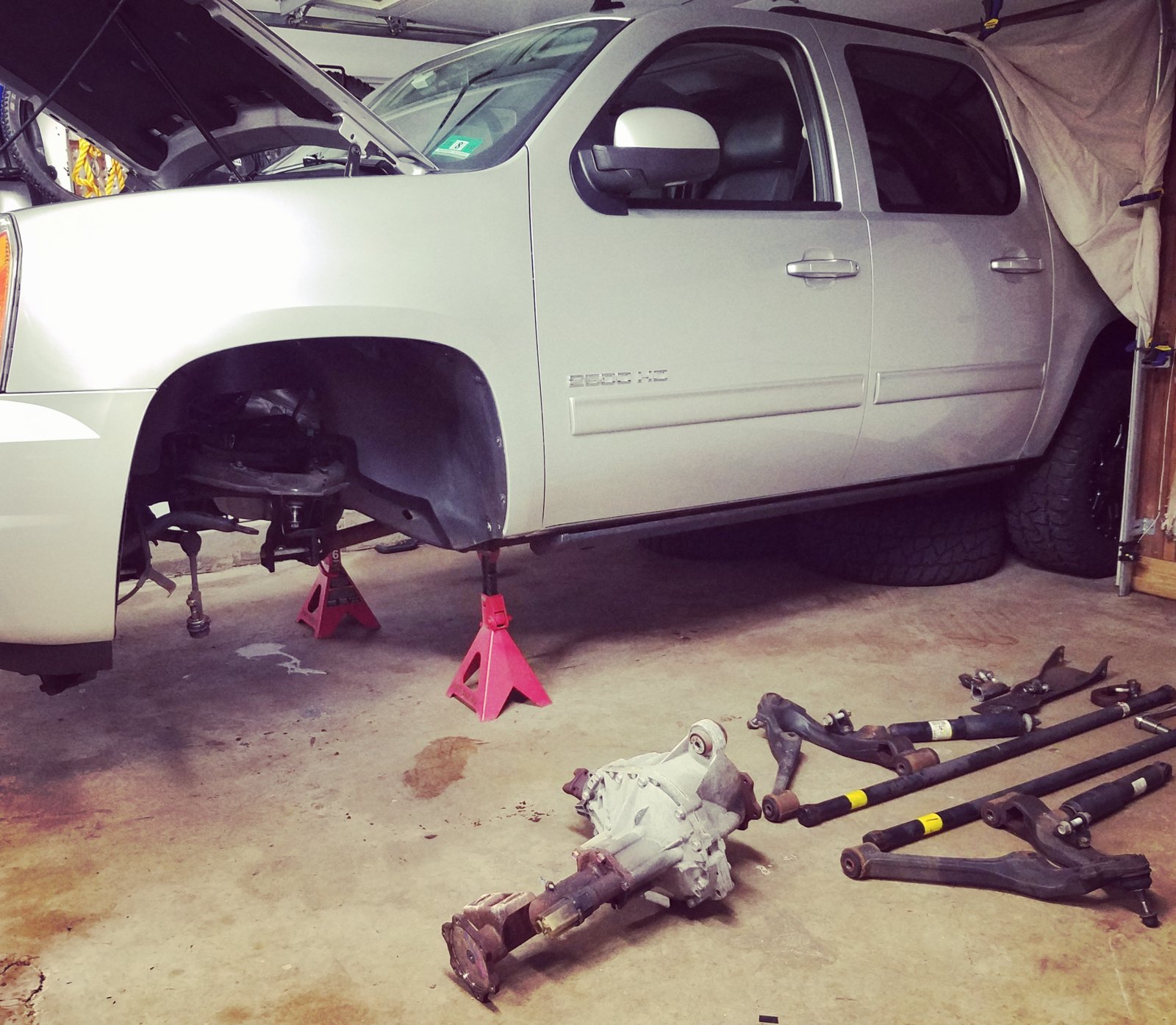

Front/Rear Dif fluid Change(Mobil1 75w90) as well as the transfer case fluid change(Valvoline Max Life ATF). Looked like it hadn't been done in a while by the previous owner so I am glad I got to it. Everything came off with ease which is surprise for a vehicle with 100k Michigan miles.
Next up is the Transmission but we will leave that for much warmer summer weather.
