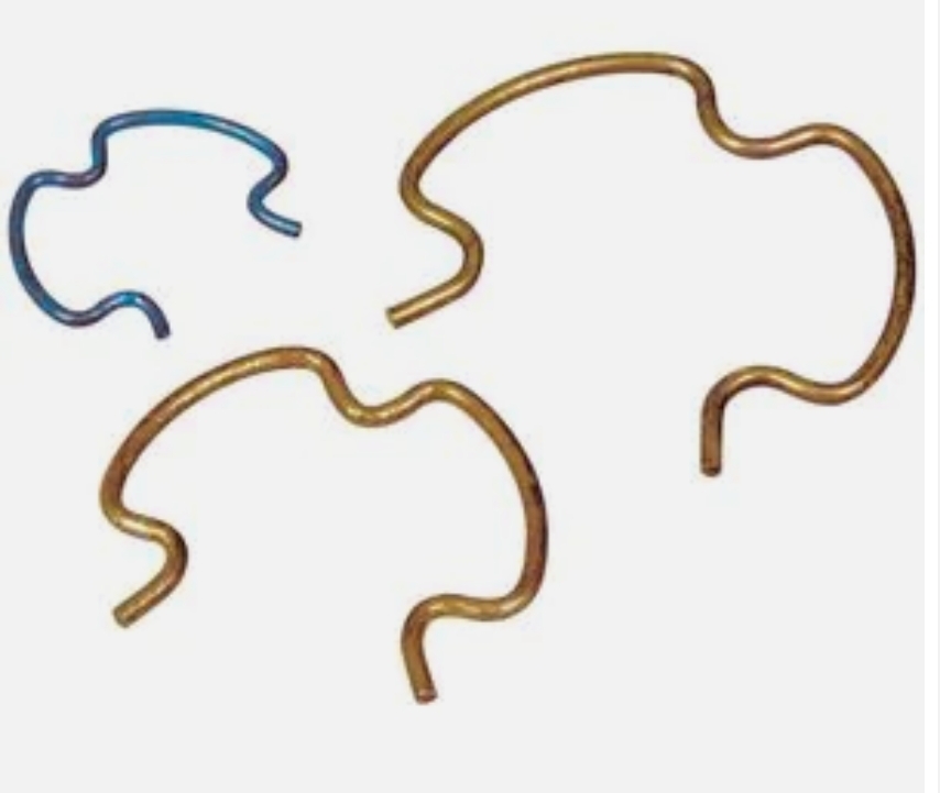

Is there a tool needed to disconnect the cooler lines?
There is a tool made to disconnect them, but you can use a pick like mentioned above, or a small eyeglass screwdriver to undo the wire clip from around the fitting. Once off, the line should just pull out. Also watch out for that clip to go flying when removing it.
When assembling, put the wire clip on the fitting first, then just push the line into it and it will "click" when secured.
These are what it looks like
