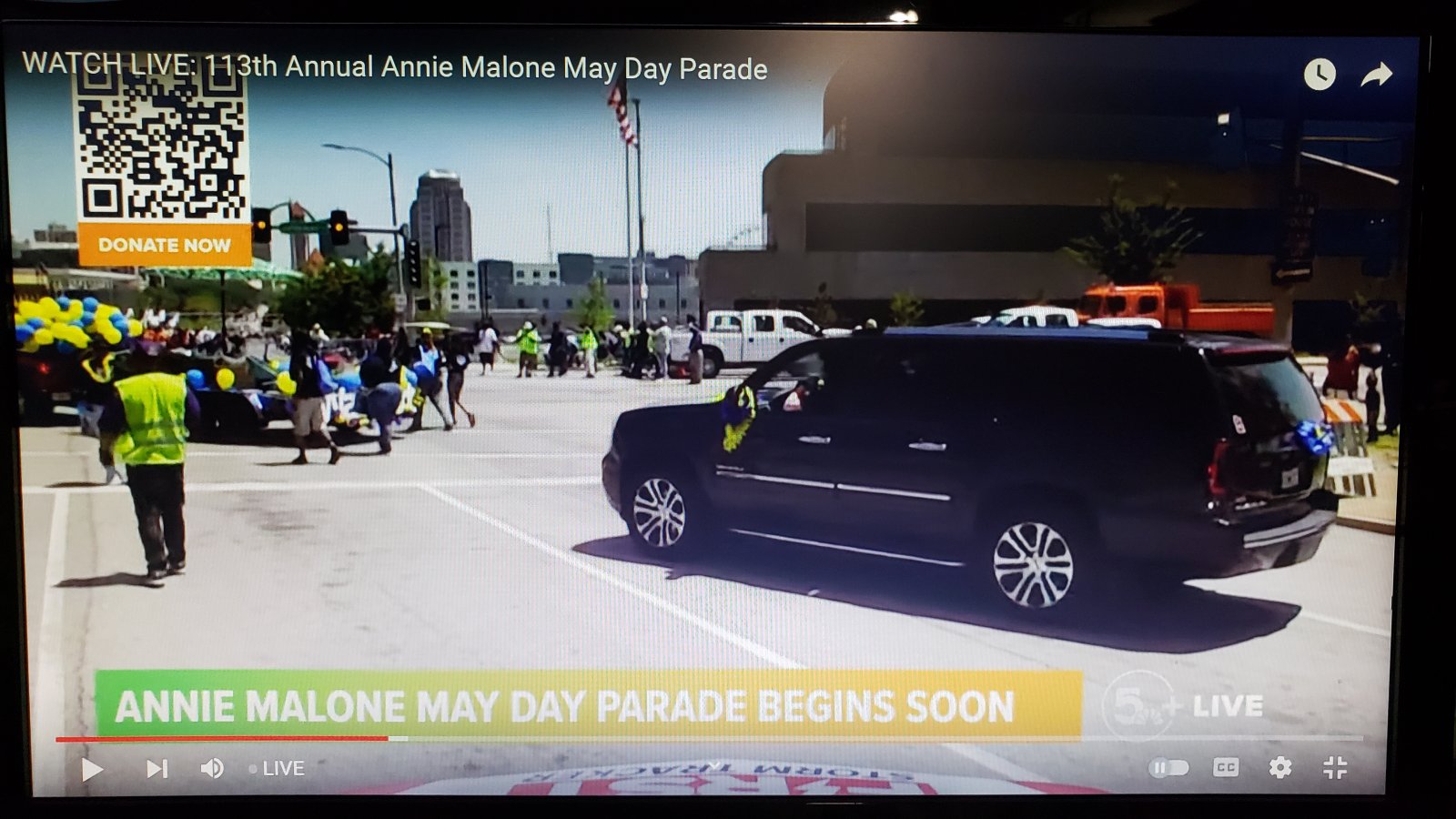

Drove it in the Annie Malone May Day parade here in downtown St Louis
I was right in front of the newschannel 5 van that was livestreaming it on youtube.
You can see the front and rear strobes that the AutoSync can do with the stock lights in the videos below
