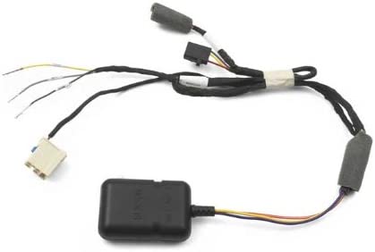

Cool, someone added the GM accessory tilt and or shock sensor to your truck.
The tilt sensor is mounted on top of the bracket that holds the BCM in place. The shock sensor is secured to the main wiring harness under the dash with a tie strap. The former is a square box, the latter is rounded with a dial for adjustment for sensitivity.
View attachment 394239View attachment 394240
I also found this on the GM website but I didn’t find the shock sensor.
