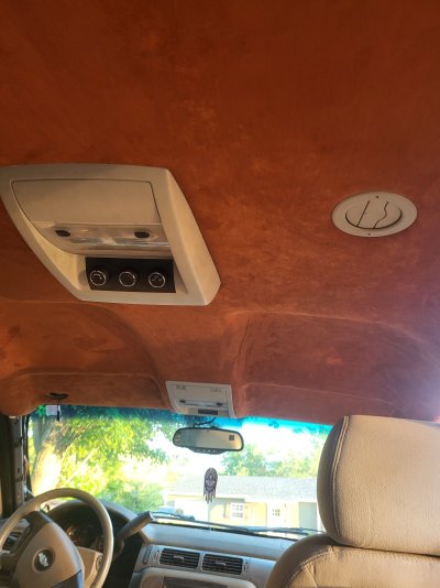

installed my new headliner i had redone. whiskey brown micro suede
