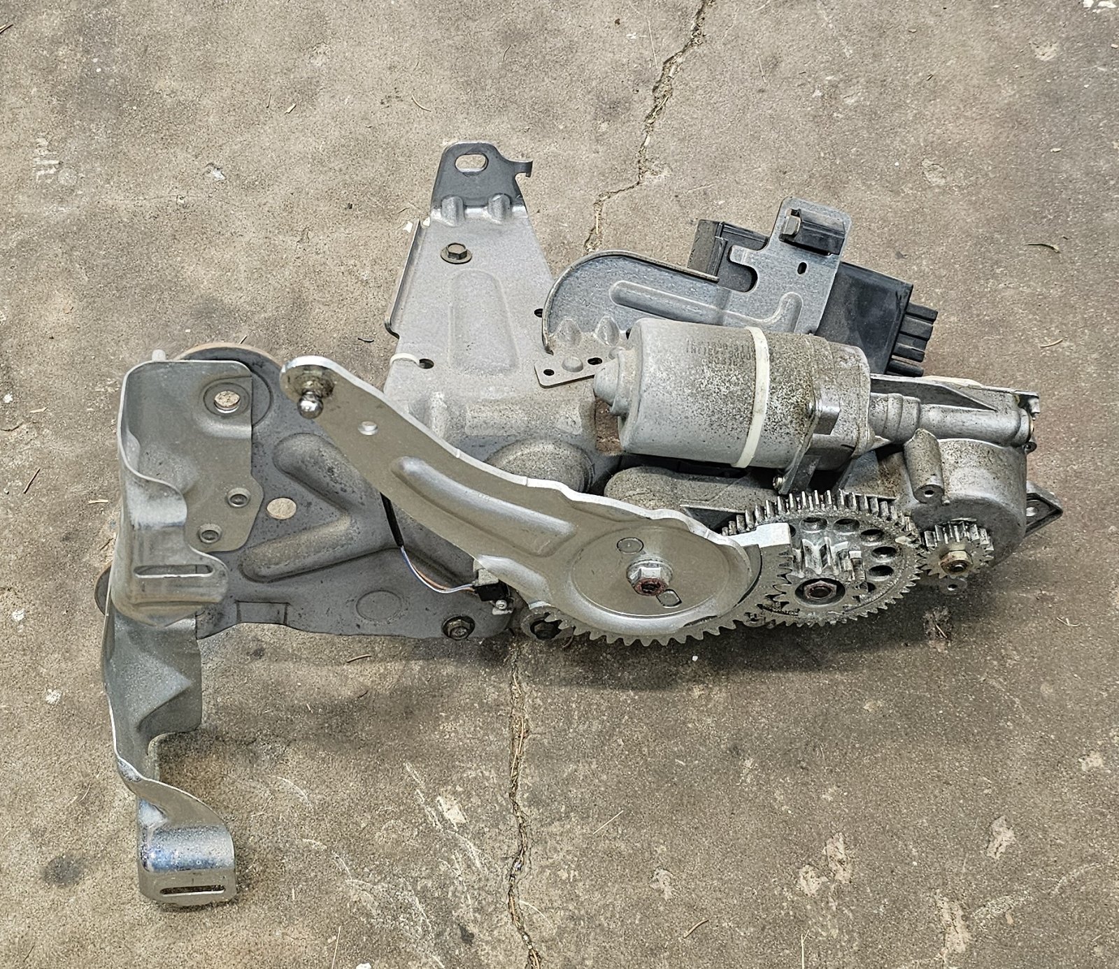

After a year and a half of replacing drive gears, changing module's and having it apart about 100 times i got this from the wrecking yard for $150 as a last ditch effort to fix it.
Had it apart and the new part in, in less than a half hour.
Fallowed the relearn procedure and SUCCESS! Finally, the gate opens with the remote and closes with the button. Did it about 10 times cuz it was nice to see it was working properly.
No idea why the old one would not work. It has had two new drive gears and 2 different modules and i can hear the motor run but for what ever reason the drive gear will not engage.
I have one of these I pulled at the junkyard a couple years and stuck it in storage in case mine ever takes a dump, which oddly enough in the last couple months it's started making a thump noise at full open sometimes but no other symptoms.
how does the re calibration process work?
I believe in my scanner without looking it says. Tailgate open/close test.
