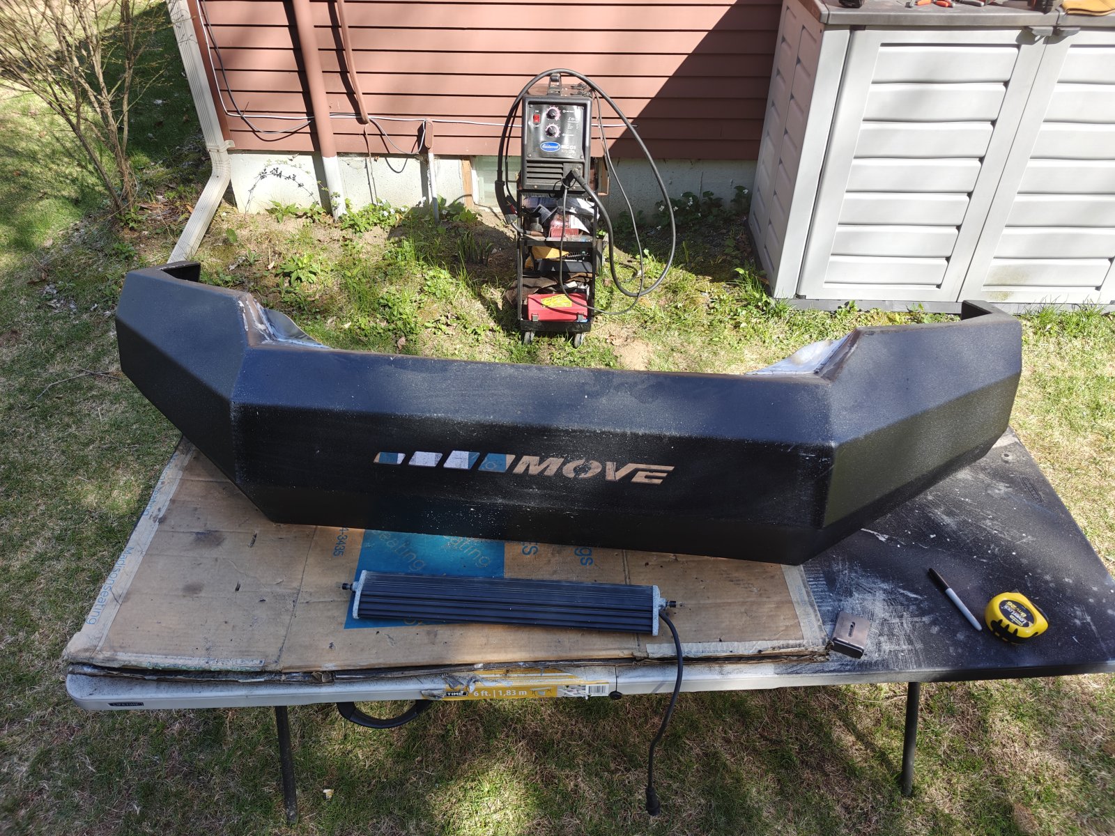

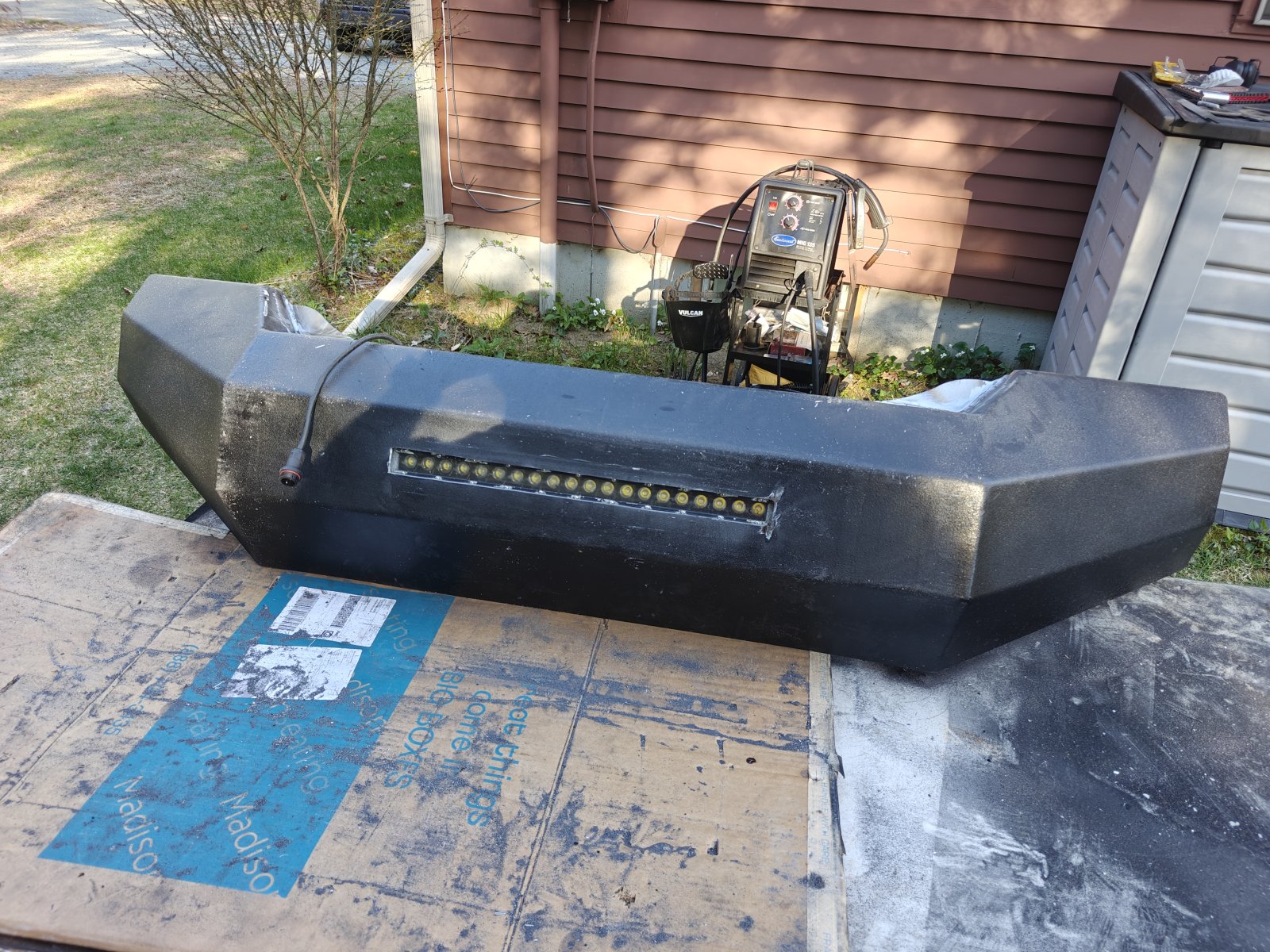

Added the upper/inner gusset plates that I forgot about when I initially welded the bumper up. They were in the bottom of the box, and I didn't see them...oofda.
Also, I realized that the giant bumper logo was almost exactly the same size as the LED bar that came on my rig when I bought it. So I cut that MOVE section out, and welded some tabs in for the Retina Blaster 9000. The car was already wired for the bar, so that made it a no-brainer. (Still working out a solution for reusing the factory fog lights.)
Primer is drying over night, then whatever black paint I have left in the stack of rattle-cans.
I think phase 17 will address triangulating the bumper wings to the frame mounts.

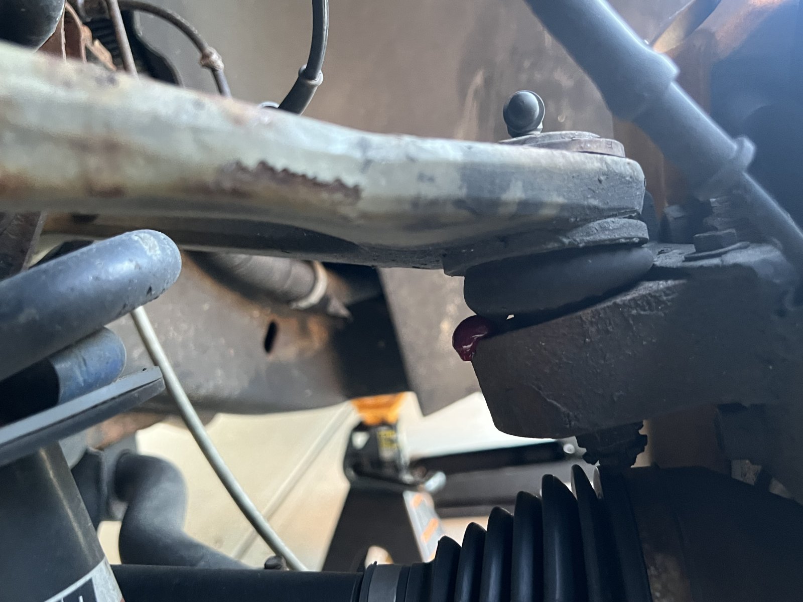

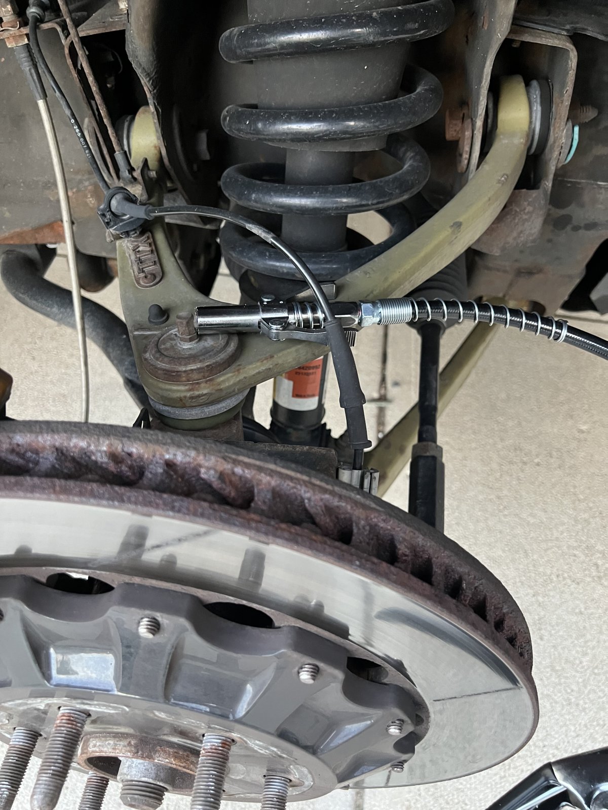

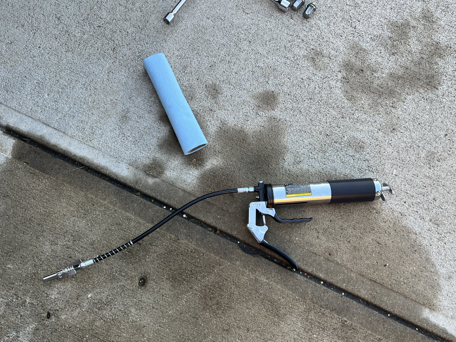

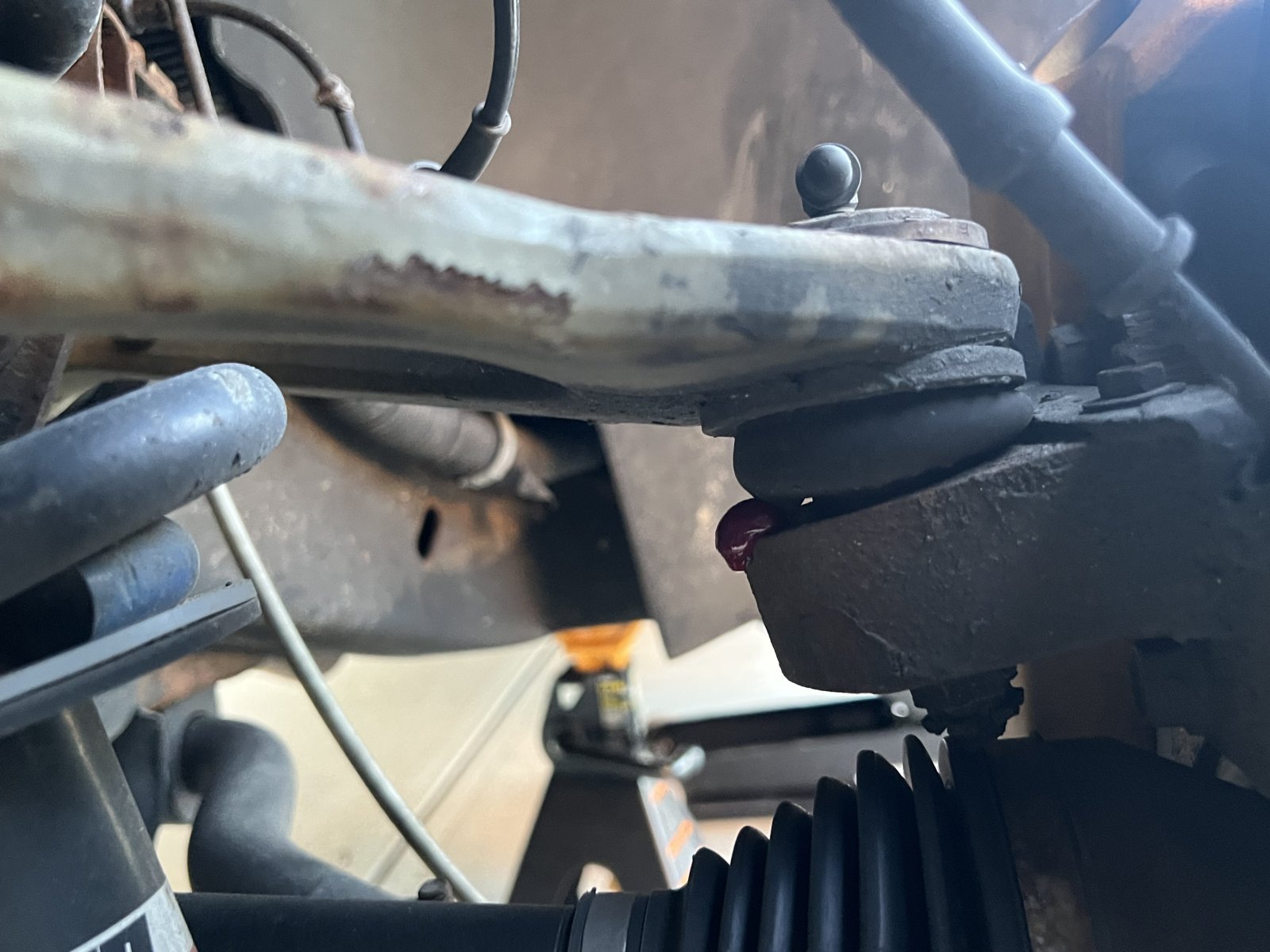

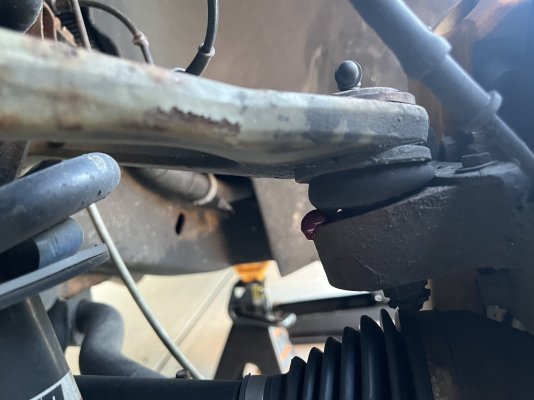

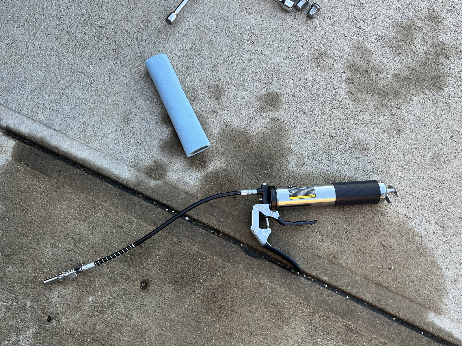

Been hearing some squeaks & creeks from the front suspension.
So hit the zerk fittings on ball joints in my Mevotech TTX control arms with some red & tacky.
Did both driver & passenger sides upper and lower ball joints.
Some squeezed out of my upper driver side which I wasn’t a huge fan of, but I’ll keep an eye on it.
Morning commute into work over my routine route that causes the squeaks will confirm if this did the trick.
View attachment 483744View attachment 483745
It's probably the swaybar bushings that creak/squeak.
Also, you don't need to pump so much grease into the ball joints that it blows out. One squirt is enough to supplant the grease that's cycled through the ball/socket as it cycles through its range of motion.
The creaks & squeaks are gone from the front suspension so I feel like the ball joints were the culprit.
Thanks @Charlie207 Admittedly I wasn't too sure on how much grease to put into them and probably did over do it. I kept slowly adding more pumps until I could visually see the boot expand some. That may have not been the correct "visual indicator" to go by...
I doubt you hurt the rubber, as they looked fairly serviceable. I've definitely blown out old rubber balljoint boots after they've been weakened and cracked, and just gave the grease-gun the 21-pump salute. Not wise, but now I know.

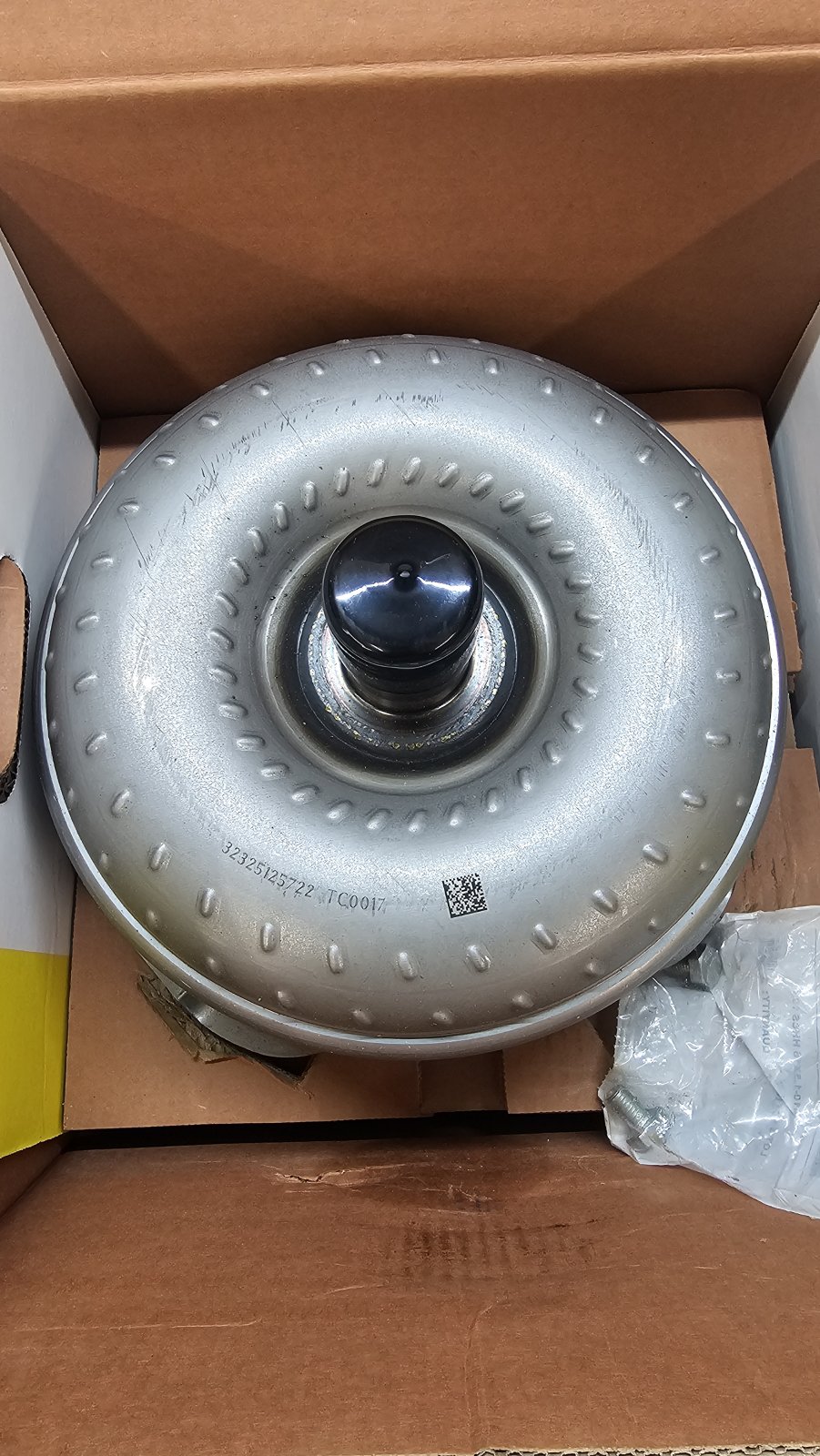

I was just reading about those today, and their rated for 1000Nm, or almost 738ft./lbs. You'll annihilate the gearbox and twist the driveshaft into confetti before the TC slips. Nice.

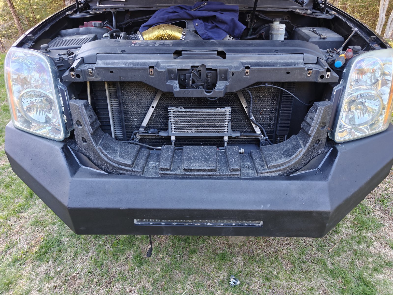

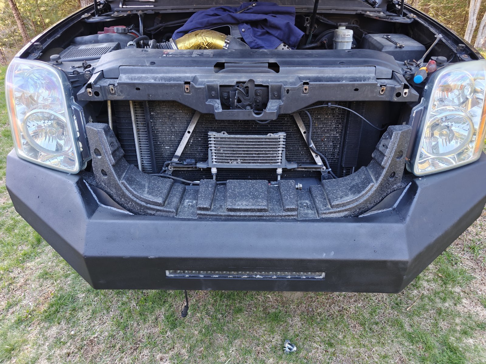

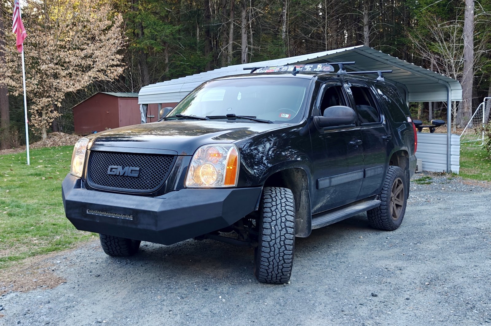

Finished the last 10% of the bumper build. Got the little extra steel parts welded and painted, the light bar mounted and wired, and even managed to reuse most of the hard foam insert behind the bumper cover.
I imagine it helps funnel air into the radiator and other coolers by blocking off the air flowing down.
I have to figure out a good foglight solution. Square lights on L-brackets would be the easiest to cut and weld for, but I like the idea of somehow reusing the factory lights. It would be significantly harder for me to cut a bice oblong hole and use the OEM light mounts.
Time for a barley-pop.
Looking at your radiator, it appears that you need to blow out the fins to improve air flow.

I made the decision to rebuild/upgrade my transfer case, since that is the only drivetrain item on my truck that has not been rebuilt. I purchased a used transfer case from LKQ, and it should be delivered to my build shop on Monday for a complete rebuild/upgrade. Once rebuilt, it goes into the truck.

Totally normal. I have taken the rear mount loose and jacked the trans up enough to wiggle it out. Some can just wiggle out.
