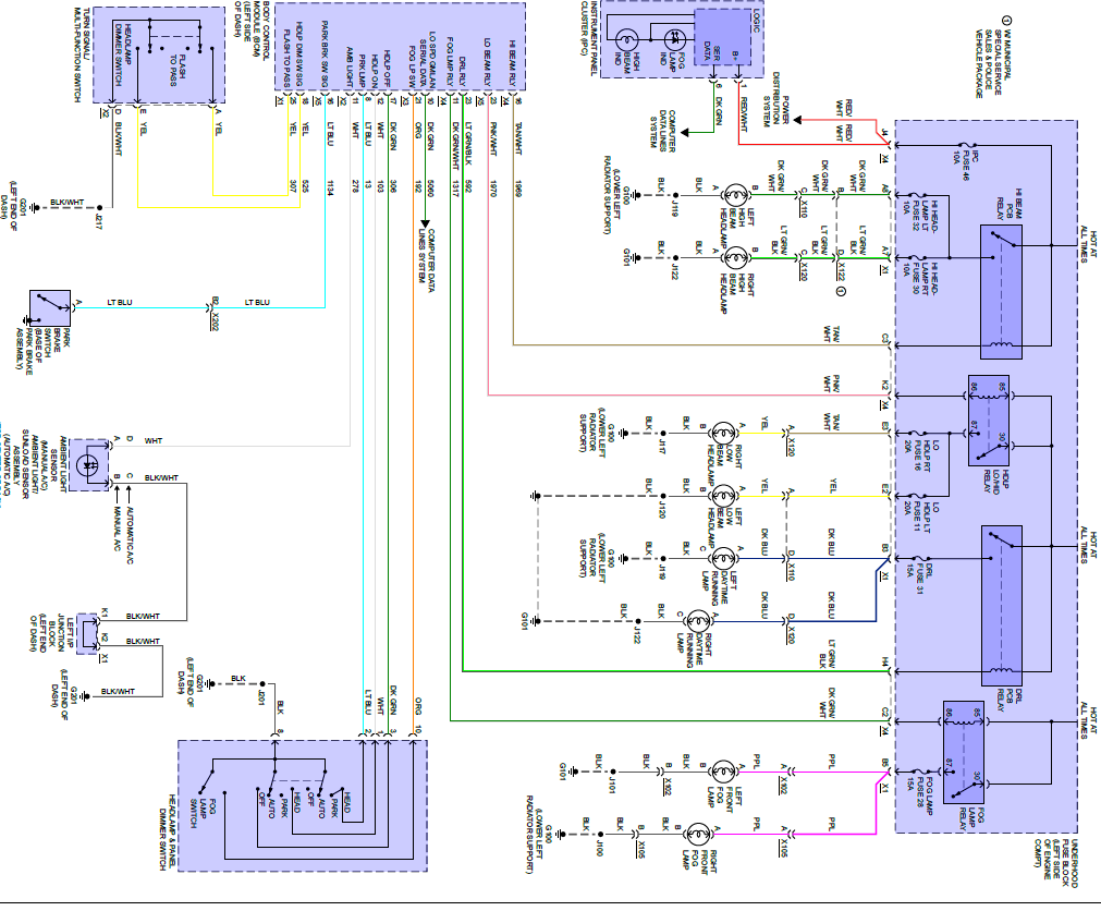

All of the SS3s and SS5s have an amber backlight now (which is amber whether you have an amber or clear lens). I haven't connected this circuit (dunno if I will).
oh yeah. here's your diagram.

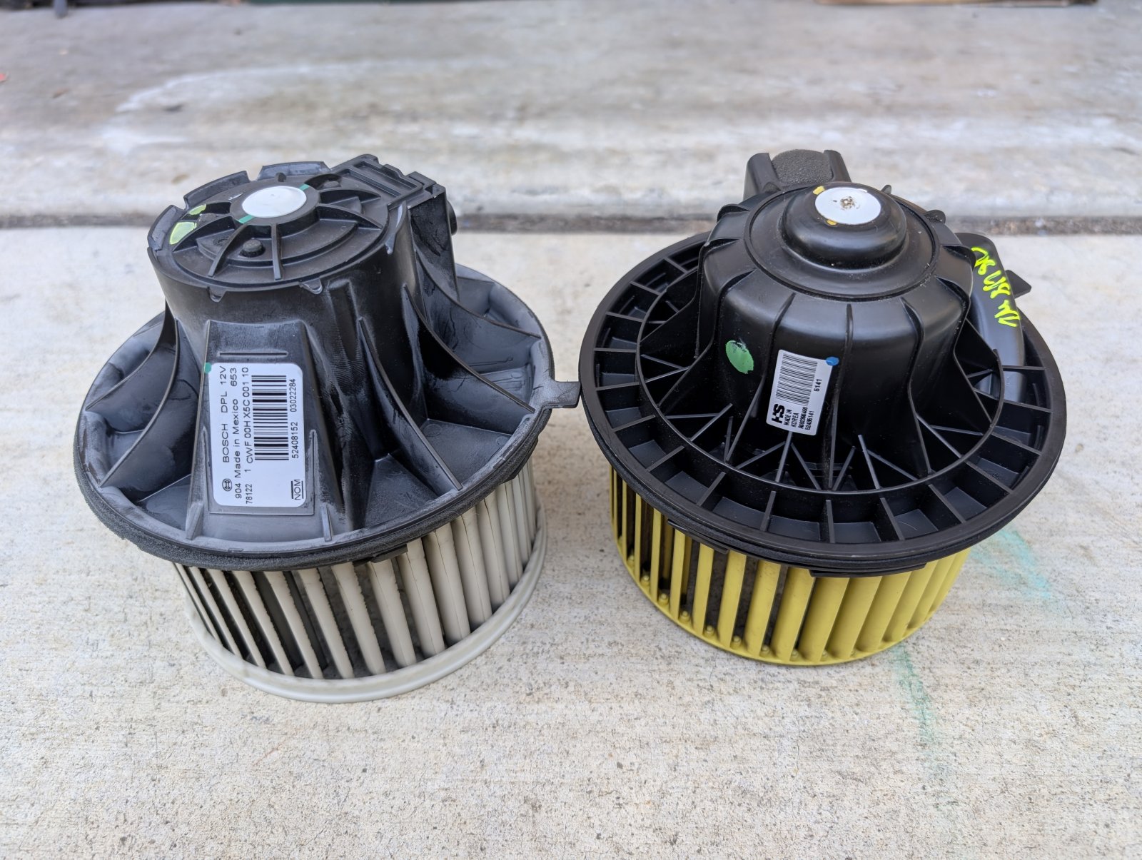

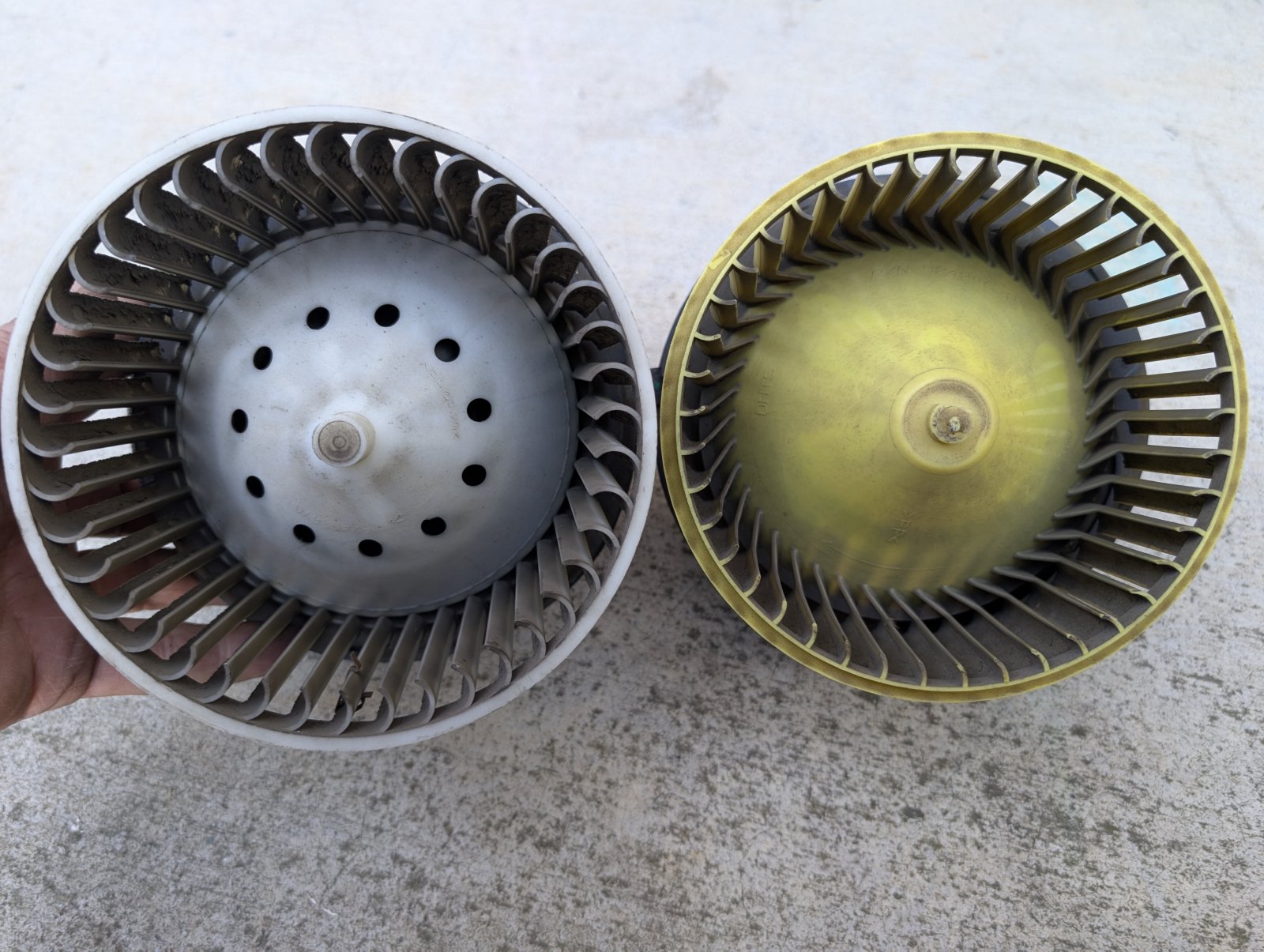

learned something new, I was not aware the blower motors are the same design as the gmt800's figured they were different and the gmt900's may come with a bosch (oem) p/n:52408152 instead of the HS or KS brand
which looks like a slightly better motor/fan, better self-cooling, fan scoop is slightly different and the bosch weighs 6oz more. I assume they changed manufactures to pinch pennys in typical gm fashion.

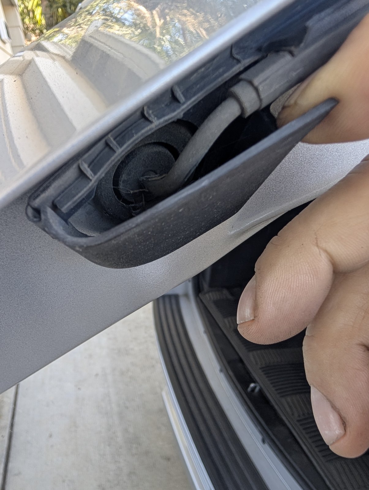

discovered something new to me, I had never noticed that there is what appears to be a combination gravity/air activation switch on the inside edge of the rear hatch door.
I was first looking at it because a small 1" section looked different then further inspection I thought perhaps at first it was part of the rear wiper washer sprayer (not sure why first thing that came to mind) but on both sides it runs about 30" or so and looks just like a trim panel/weather seal, curiosity got to me and revealed that when the hatch is partially lowered even just a little bit and the hose is pressed on it activates the hatch lock, hmmm. I guess that is how it detects that the hatch is in closed/open position?? my best guess anyway

That’s weird. At first I looked at the bottom edge and didn’t see it until I looked at your pictures again and see it’s on the side at the bottom. It does indeed lock but it seems to lock all the doors if I do it twice.

wifes suburban has it, both of ours have the powered liftgate/hatch, I assume it it for the powered hatch's then. Just surprised I never noticed it before because I clean all the cracks and crevices a few times a year, guess I just never paid that much attention to it.

I kind of found out it activates the lock by accident as I was holding the hatch down a bit and pressing on it and heard the lock cycle. weird it's never come up as a thing before that I have seen. with the hatch all the way up it doesn't do anything so I assume some type of gravity switch is involved as well or the lift motor has some kind of sensor.
anyway learned something new....
