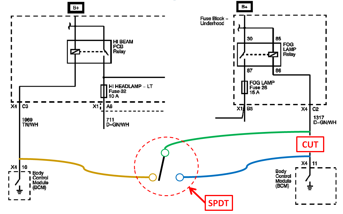

A common aftermarket part to enable an "all lights on" setup is the Fleece Module. However, there are two issues that don't suit my arrangement: 1) I have no need or desire to have my driving lights on with my low beams, and 2) I do not care for the "piercing" (i.e. Scotch-Lok style) of wiring tap, which inherently damages the wire insulation and can break the individual strands.

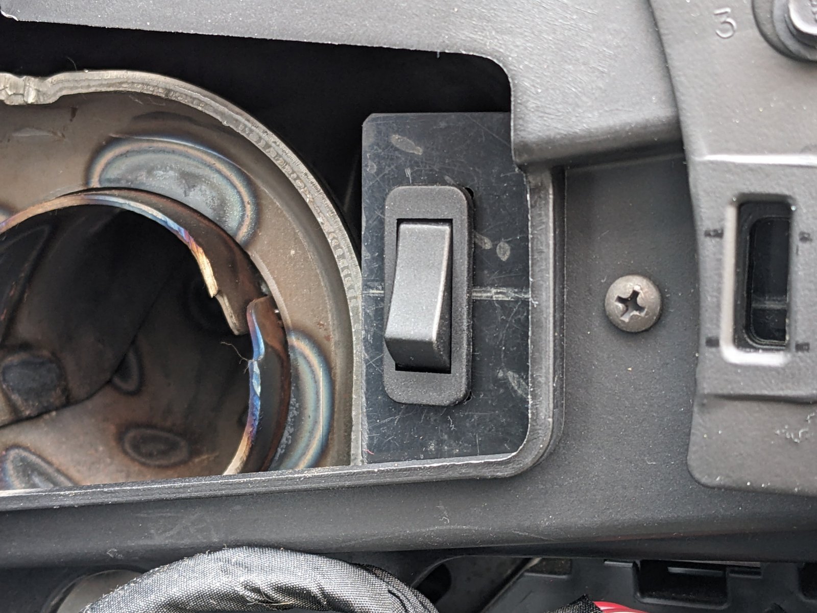

So, what I did is install an SPDT switch as per the crude schematic below, with the switch behind the driver-side fuse box cover. When flipped to the "high beam" side, the driving lights come on automatically with the high beams and cannot be controlled with the fog light switch. When flipped to the "fog light" side, the lights will not come on with the high beams and can be controlled with the fog light switch in the stock manner. I used what I had on hand, which was a C1510AB switch, some 18-gauge TXL wire, and some 18-20 & 22-24 gauge butt connectors. IMPORTANT: The wiring harness at the BCM appears to be 22-gauge, so you do indeed need 22-24 gauge butt connectors if doing this.
Anticipating the question "Why even have the switch if you are only using these as driving lights?," I did it this way so that I can reinstall the fog lenses and revert the circuit operation to stock by flipping the switch to the "fog light" side. Should I ever desire to have an arrangement that will duplicate the Fleece Module function (fogs optionally on with lows and automatically on with highs), I can simply add a properly-oriented diode between the "high" and center "fog" terminals.

nice write up.
seems a shame if they don't come out with a hi/lo version at some point.
some of the new bi-led projectors have a 2nd section of the lens for a Lazer spot beam. it has me curious to maybe upgrade mine at some point.
but use, a diode inline from the high wire will keep power from turning on the high beam when you turn the fog lamps on.
