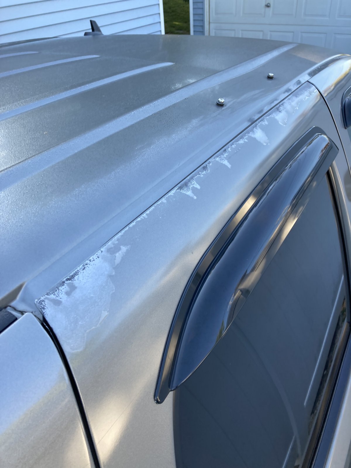

They always make it look so easy
that they do. I have learned to polish clear pretty well thou from YouTube but it takes a long time.
my thoughts going in is if I'm not going to a body shop, then how much worse can I make it anyways. along as it seals enough to keep it from rusting, it was worth the try
