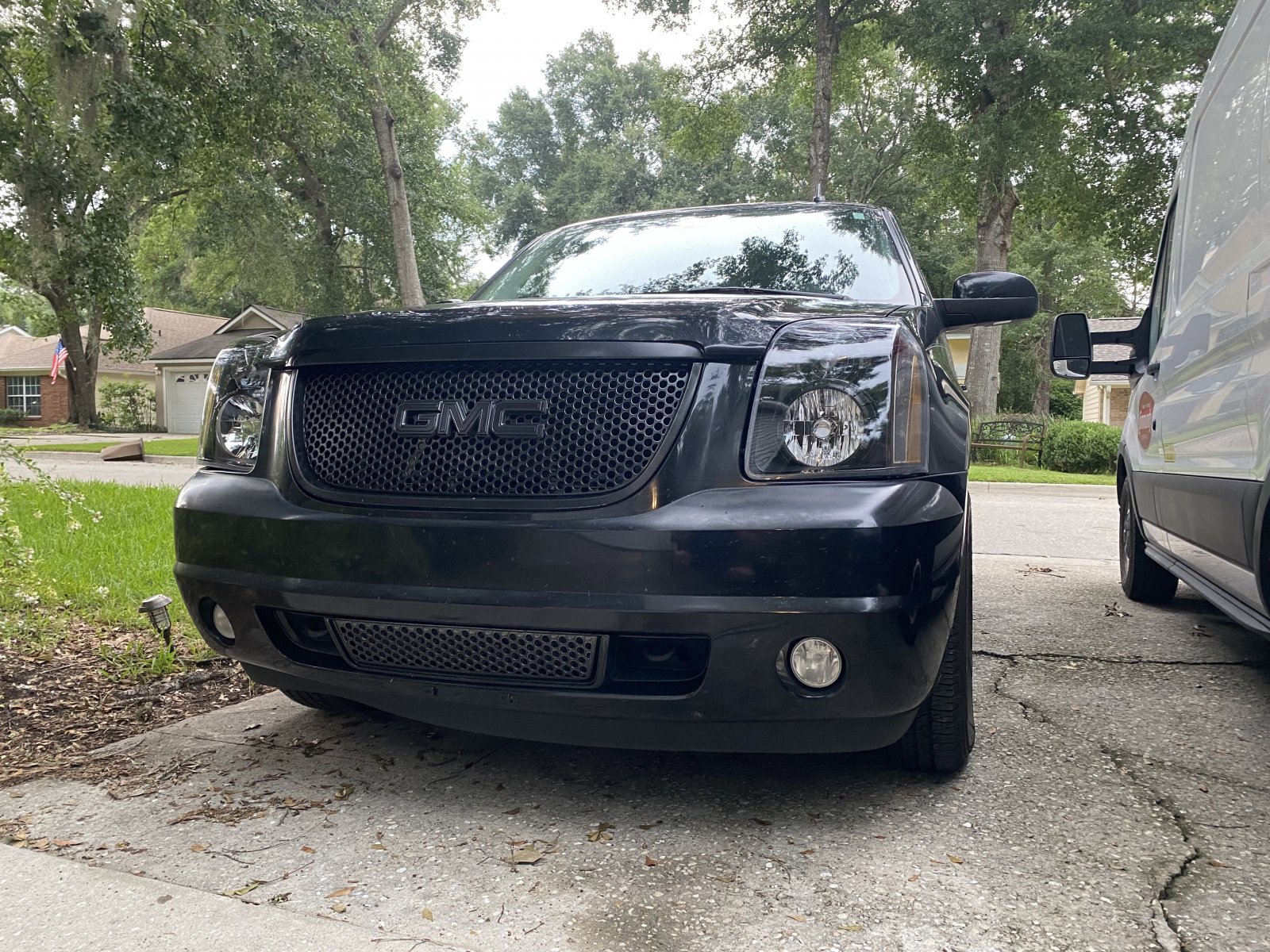

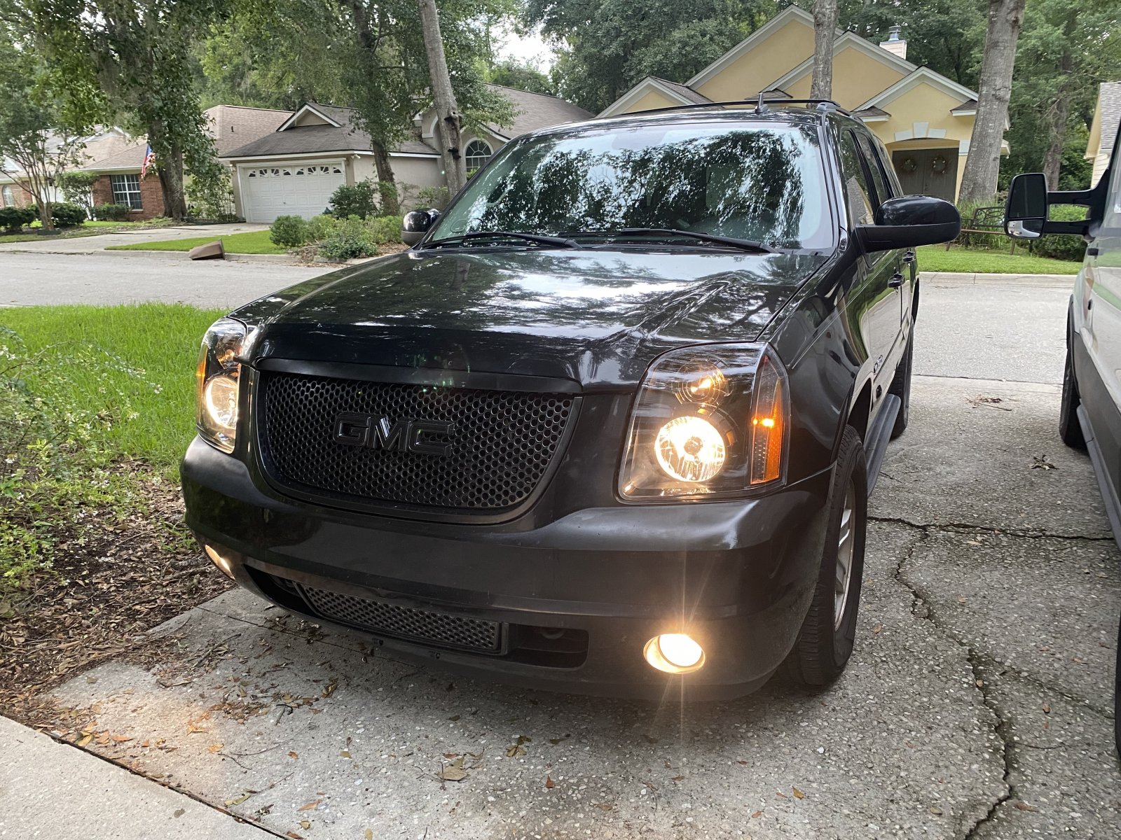

Replaced the visor receiver and installed new headlights.

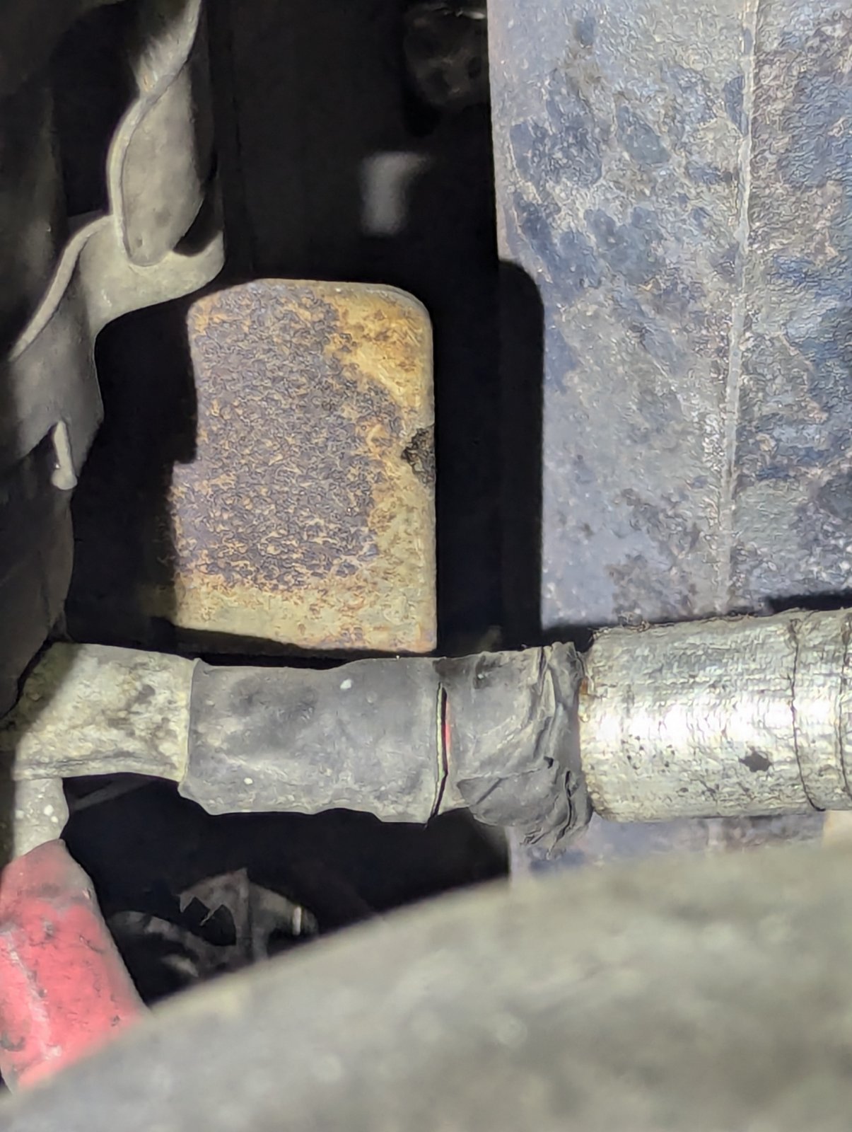

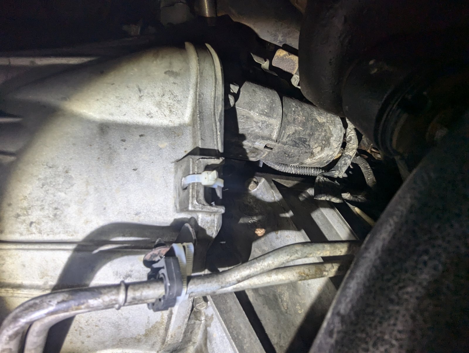

Got under it didn't find anything too amazing the little heat shield that clips on the starter solenoid was down and was making contact on the starter power cable, can't really tell if it hit bare wire or not yet but it might barely have been you can see a small black spot on it and the solenoid wire is tied in with the knock sensor harness, I pushed it back up for now and the lower cover plate between the starter and bell housing had a definite ping/tiny sound if you touched it all so I zip tied it to the bell housing and the transmission cooler lines were dangling a little bit so zip tied those up. Will take another test drive after the wife gets back to watch the kids

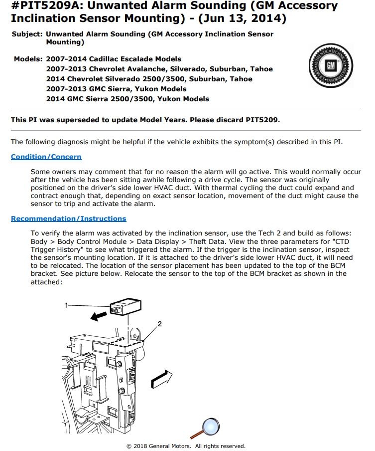

My alarm (horn honking) just went off about 10 mins ago while it was just sitting in the driveway. Haven't driven it at all today. I looked at my security cameras and I saw nothing, 4 legged or 2 legged that could've set it off. But at the same time I could hear another milt-sound type of car alarm going off a few houses down across the road.
What would cause the factory alarm to sound, the door opening? Ignition starting without chipped key? Shock/glass breaking?

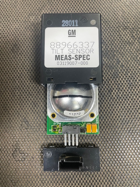

If you have the factory tilt sensor, and it's still mounted on the lower airduct, there is a TSB about relocating it..
Mine used to go off all the time, I just removed it instead.
Opening it, there is a metal dome on a circuit board about the size of a half dollar with liquid inside.
