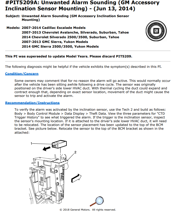

If you have the factory tilt sensor, and it's still mounted on the lower airduct, there is a TSB about relocating it..
Mine used to go off all the time, I just removed it instead.

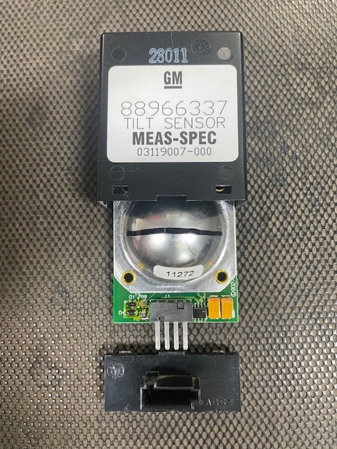

Opening it, there is a metal dome on a circuit board about the size of a half dollar with liquid inside.
How was it mounted, sticky tape?

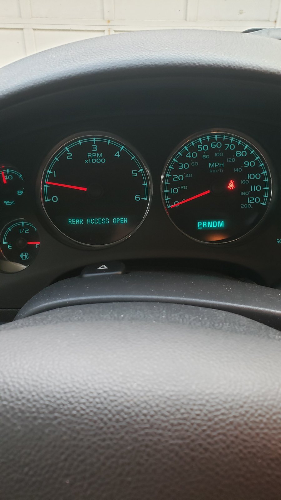

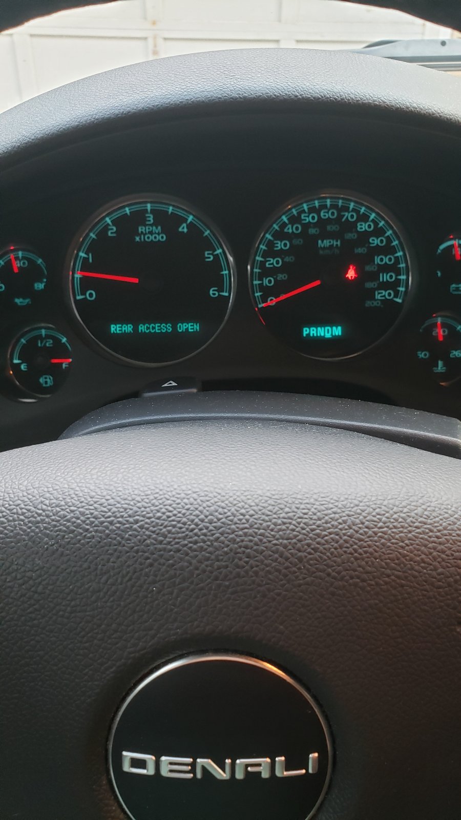

Update...
Went out and started yukon and the "Rear door unsecured" or whatever message was on the DIC. I opened the liftgate with the button on the overhead and went back to make sure the Husky mat wasn't blocking anything then closed it with the button on the liftgate. Message went away. I then went back and opened the glass and the same message displayed on the DIC. Closed glass and message went away.

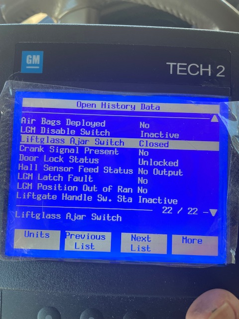

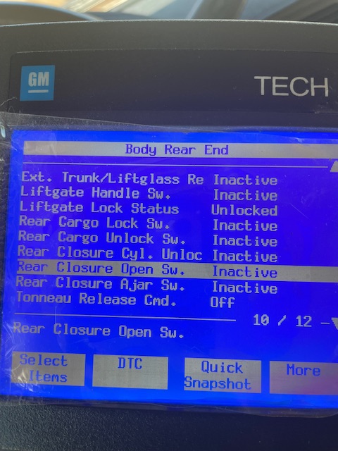

So, is the sensor built into the latch? If so, how do I tell which latch, the liftgate or glass, may be going bad? Would the Tech2 help with this in any way?
They have seperate sensors. Liftgate Open/Ajar or Liftglass Ajar. I would have assumed the Tech2 would show it, but can't find it in the Tech 2 Paths..

Found it. liftglass under liftgate module, liftgate under bcm rear body.

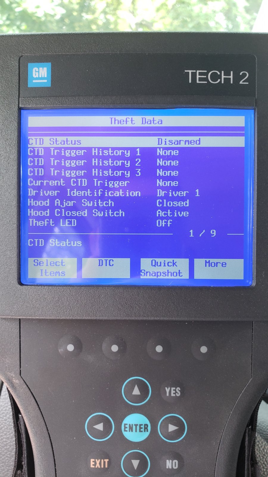

I broke out the Tech2 and figured I'd look at the Theft Data info to see what triggered it. There was no trigger history, lol
the only thing that really set's off a factory alarm on the gmt800/900 is if a door is opened while it is armed, so it could very well be the rear hatch sensor. not sure how the rear actuator is configured as far that goes.
@mikez71 that's a mercury switch, it was probably added on at some point i don't think my Denali even has one factory

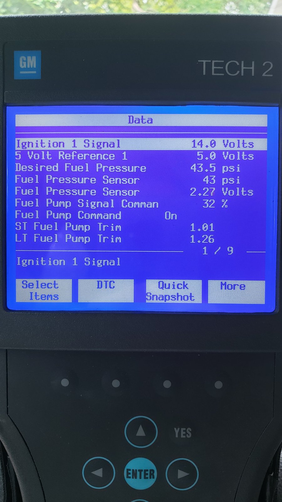

Had the tech2 hooked up a bit ago. Here's my fuel pump modual data screen
Also while in there looking around I noticed a screen where you can get a whole lot of misfire data.
Under ECM, Data Display, Misfire Data
ya that's where you get the misfire graphic, that's seperate from just regular misfire monitoring
I was hoping that theft data would tell me which sensor set the alarm off, but it shows like it never went off.

I remember having codes for my tilt sensor when that was the culprit..
Since you got liftgate open messages, I would guess it to be the hatch or the glass..
Seems like they share the AJAR signal the more I look at it..

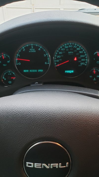

Well I just got home from running some errands and it hasn't done anything weird. Hope that by opening both liftgate and the glass and making sure nothing was hindering it's closing and also spraying the latch mechanism with GM multipurpose lubricant fixed the problem.
My wife said I probably picked up a ghost, lol.
Oh, and the message on the DIC says "Rear Access Open" and not Liftgate Adjar or anything like that, so just kinda vague.
you can determine which one it is saying by opening either the hatch or the glass and then go put it in drive

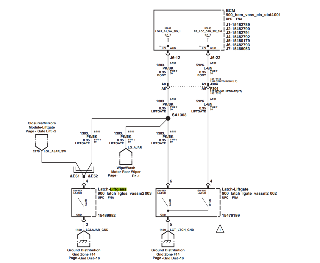

Yep, if you look at the diagram, the two signals are spliced together...
If it keeps happening, you could unplug one of the ajar switches to test, as the other will still work.
I would be especially careful with the wiper while disabled.
Is the ajar switch separate from the closure mechanism or is it in the mechanism and just has a separate wire connector?
