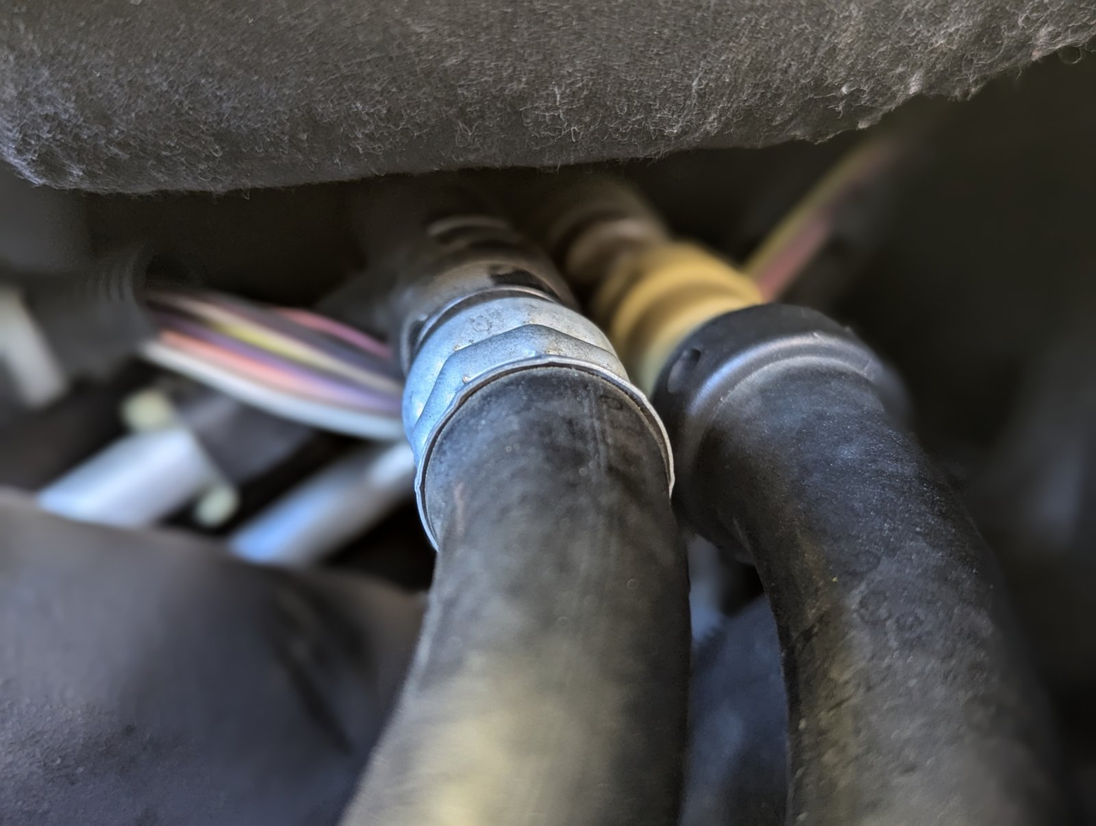

Can anyone take a look and see which way this wire harness goes around the heater hose t's? this doesn't look right to me, should go over or under

Damn, those look like shit. Guess they don't make them like they used to. My BBK ceramic coated longtubes are about 20 years old and built really well with nice clean welds.
Yeah, that's what I thought I was getting, these aren't how I like to do things.
Suppose I could exchange them for jba or something else, they're all 1-5/8.

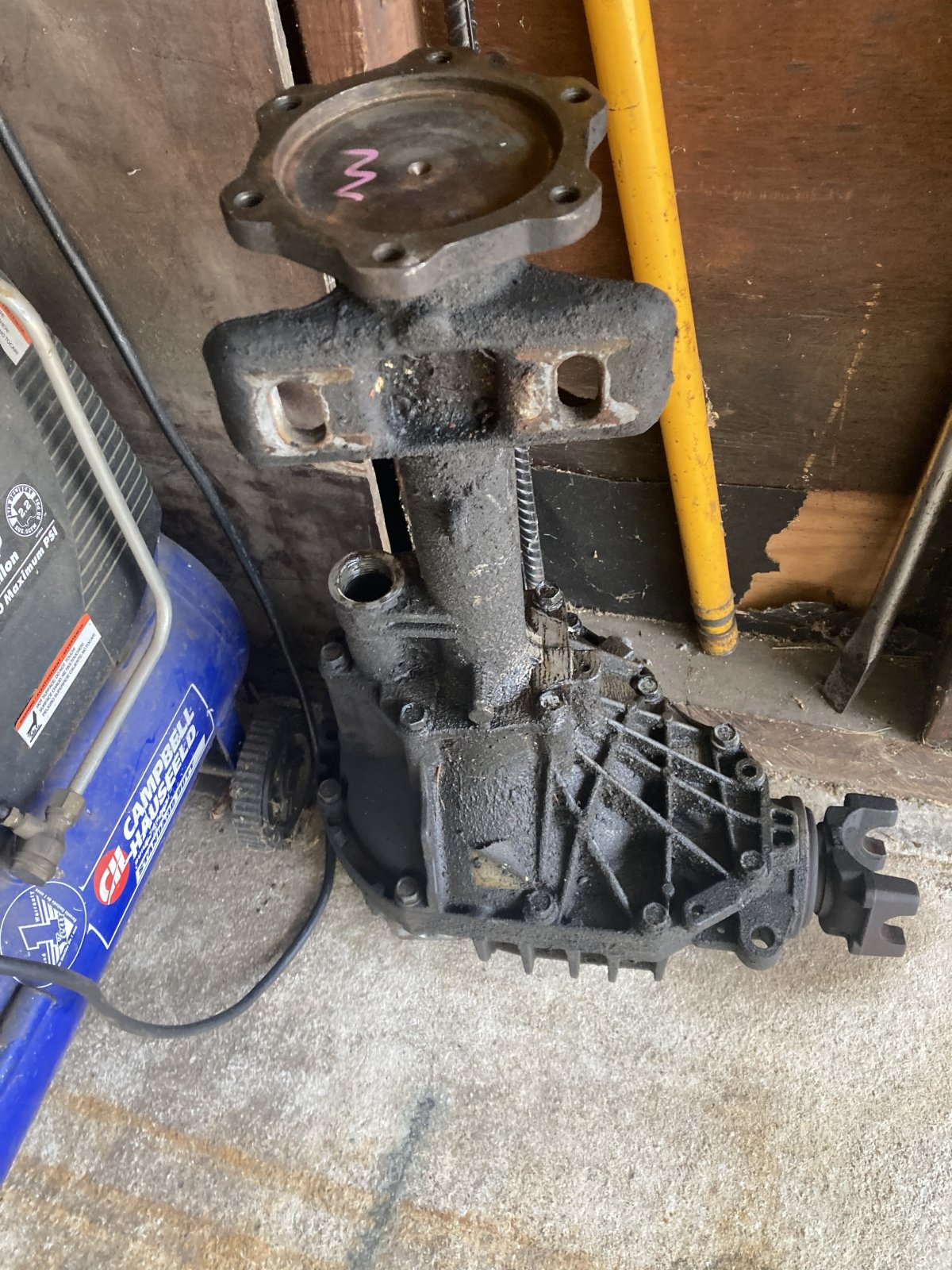

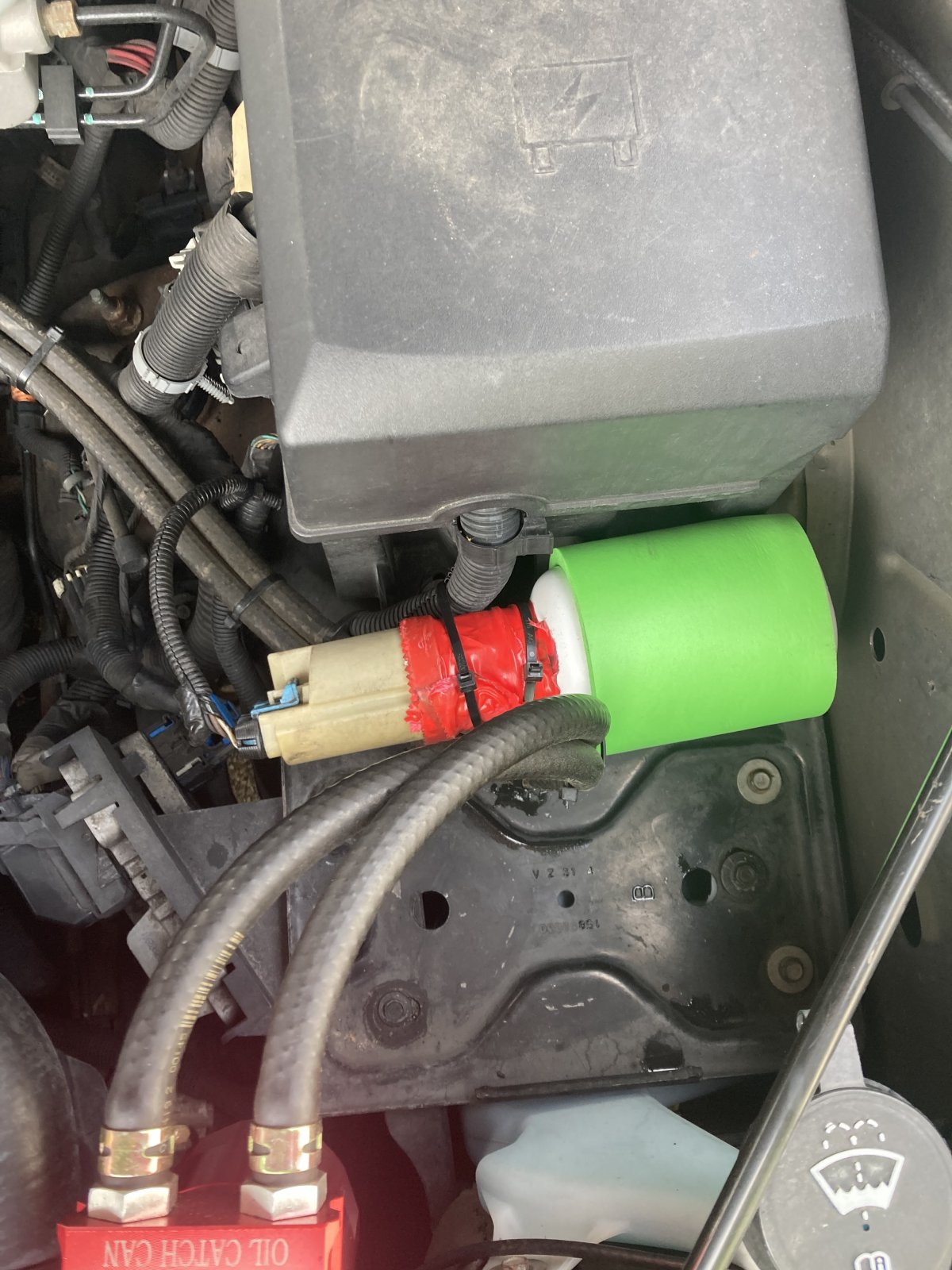

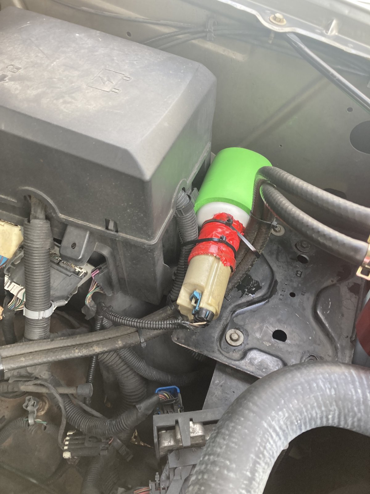

So I pulled mine out Saturday afternoon. Took me about 1 1/2 hours including the driveshaft. (I already had the half shafts removed.) All those inner nuts and bolts come right out, leaving the mounts behind. No need to access the top. Have to drop the crossmember from under the engine too, only 4 bolts. So the diff housing can clear.
There is a boot on the driveshaft connected to the t-case flange. There is a band clamp you need to cut to get the shaft to slide out of the housing. So I am currently running with no front drivetrain at all.
And like I expected there was enough slack in the wire harness to run the diff actuator up into the engine bay and tie up out of the way. I mounted it into a pill bottle with a beer huggie wrapped around it for vibration noise and tied it up to the spare battery tray. This keeps it from throwing any service 4WD codes.
And yes the truck looks worse underneath with oil buildup than this diff does.
View attachment 433555View attachment 433556View attachment 433557
Yeah, when I get some free time I'll pull mine. The half shafts are out, and when I spun the driver's side of the front diff it's gritty/crunchy.
What did you tie the front driveshaft to?
