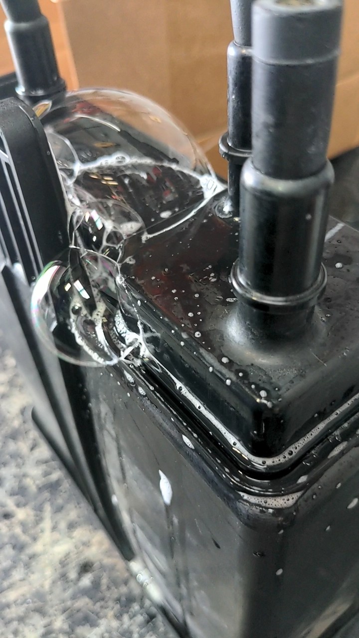

guess at least have pressure tested the new bad canister before buying another one. never even though of it haha. PXL_20240720_173513081_exported_359_1721505440066.jpg
horrible friction welding the top on. I could probably have just melted it together and not needed to by another. guess that's why I was a close out deal. probably a return or just a blem.
the 2nd new one seems to hold air. so that's a good start haha.

....well, i got what I paid for i guess, the "quality" of the bbk shortys leaves a lot to be desired.
the welder was unskilled, or not paid enough, not allotted enough time to do a decent job...
also, theres no "ball" connector on the 3 bolt flange...its just flat... and has extra ports(with block off plates) for the older systems I suppose.

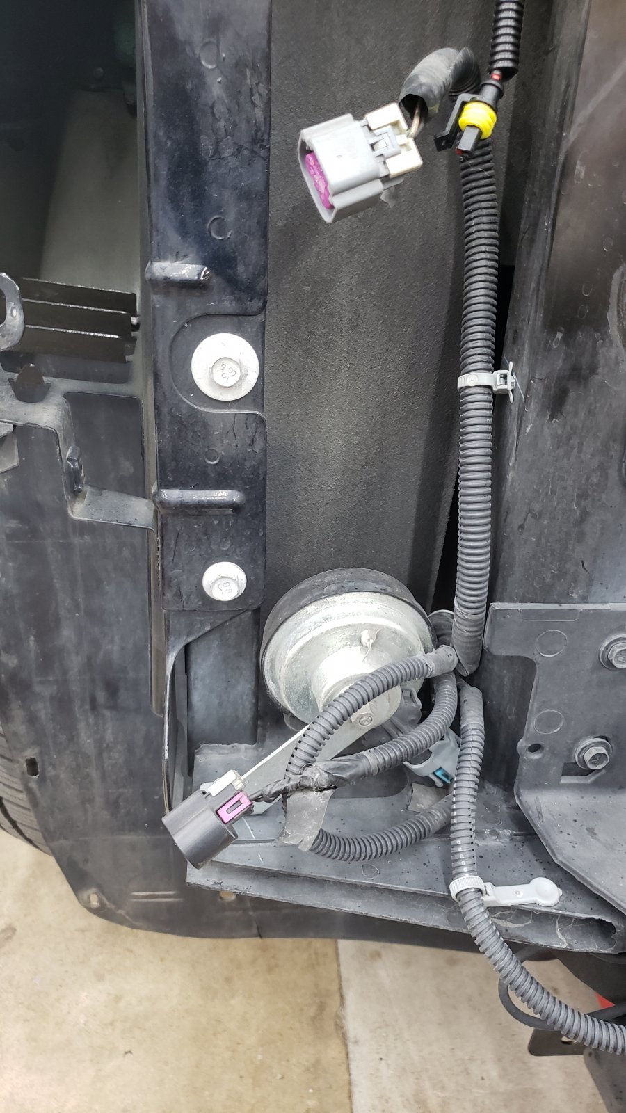

Quick help. I'm swapping out headlights and I can't remember which connector goes to turn/side marker and which goes to hi/low beam. I have an upper Grey connector and a lower black connector. They are both the same shape and match up to both plugs on the back of the light.
@Doubeleive
Figured it out. I looked up the install video on YouTube and watched closely to see which one they plugged into which.
