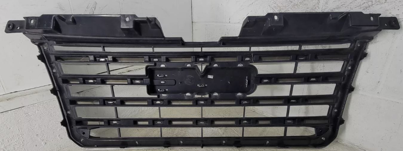

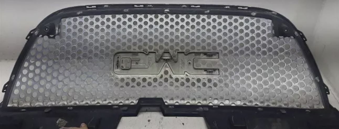

WHICH ONE HAS MORE AIR FLOW?

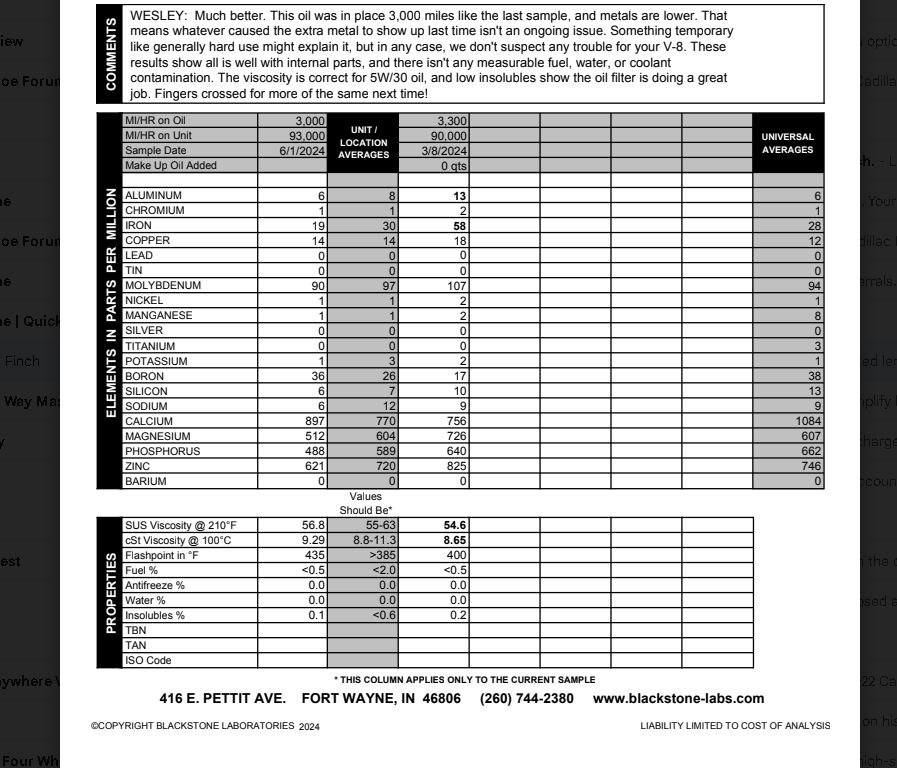

got my most recent oil analysis back, I think the last one they handed me a sample from someone elses vehicle because they said it looked like a 6000 mile oil change and the viscosity was off.
hopefully this means my cam is probably ok

think so? just doesn't seem like it to me, too bad there isn't a way to test this theory easily. I can get a chrome mesh one without the gmc logo blocking some air
Just a hunch because round holes flow air better. But you could do it by counting the holes, measuring their area and making the calculations.
yes that is comparing small squares, not big rectangles.
I suppose math would determine just as well but too lazy lol

I would have to build a cardboard funnel behind it to get a accurate reading. i haven't bought one yet either just thinking,,,,,,,,
Why a cardboard funnel? You don't drive down the road with a cardboard funnel taped to the front of the truck do you?
Simulate driving down the highway.
Box fan set to same speed during both tests. Place grill like a foot away during each test and take reading like a foot behind the grill.
Blackstone sells a nice little hand pump that goes down the dip stick to get a sample. we have one at work, it might be worth while if you're not sure the guys at the shop are doing it right. it really show be taken while up to temp and from mid drain.

I think there's more than just the surface area of the holes involved in the match when air flow modeling is involved. something like the faster air flow, the more it can shroud itself.
something I read years about about a 2 valve head vs a 4 valve head. the 2 smaller valves have much more surface area for flow at lower speeds and lifts, but once the air speed gets up for high rpm, the center of the valves the air flow shrouds itself and one large valve can flow just as much air.
they had graphs and all to show it on a flow bench. not that I can say they were telling the truth or not. I have a 4 valve engine that shifts at 14k. but just what I read. I can imagine at high speeds, say 70mph the small hole grill flowing much less than the wider slats. at least in my head. especially if the slat angle is correct where the small hole grill lays back more, the slates form a air dam on the way up and over the hood.
No math needed, except for a ruler (not your wife kind of ruler...). See @Geotrash's post. Apples-to-apples comparison. EZPZ
because i may be placing the meter in a sweet spot with the open slats, a better test would involve a more controlled environment. If i build a funnel to about a 4" hole then I can get a reading for either one more accurately. I have plenty of cardboard and tape.
I personally think the slots will catch more air but that's just my brain seeing big open slots versus small holes
