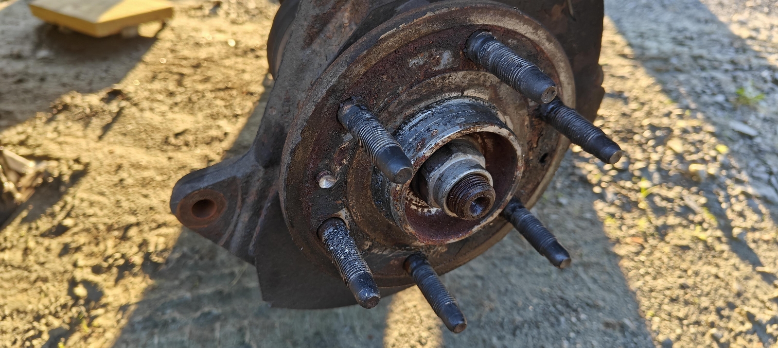

Front brakes pads and rotors. Should be a simple job. Then life punches you in the diggler for no reason.
Driver's side caliper boots didn't want to fold up properly when pressing them back, so that was a fun time.
Then the passenger side rotor bolt decides to be frozen & strip.
It's funny how an hour can turn into two.
I rebought Raybestos Element3 pads/rotors from RockAuto. I will say, I was happy with the braking performance throughout the 2+ years of service, and especially how the rotors didn't rust, so whatever that light paint/coating is that they cover the rotors in is pretty good against road salt/brine spray.

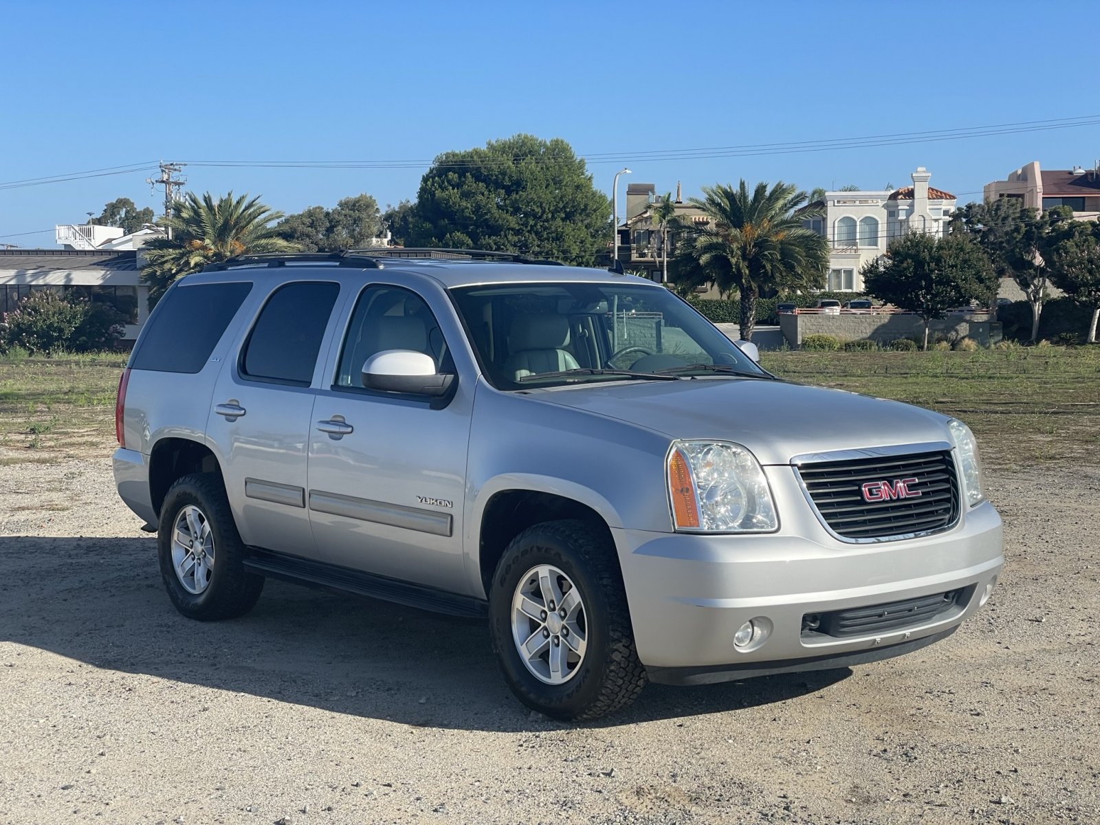

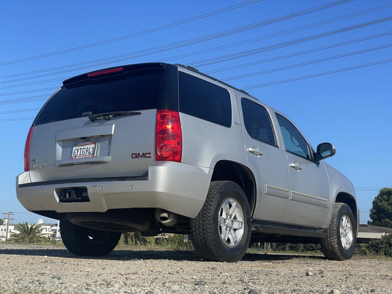

New headlights in the '07. The old ones were yellow and embarrassing. Got a guys weekend coming up starting tomorrow and we're taking the Yukon to the Commanders game on Sunday. I can't show up with my rig looking like a hooptie with yellow headlights.

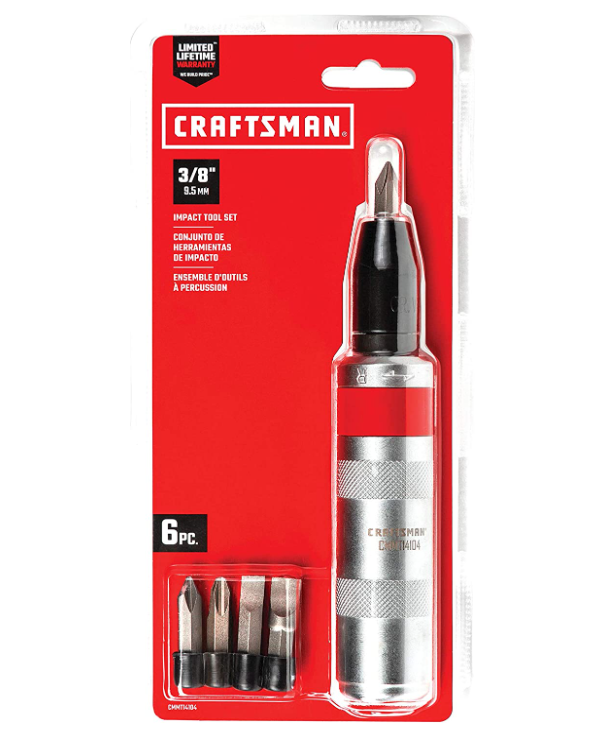

For those I use one of these, actually the older version, you just smack it with a hammer and it "hopefully" breaks it loose. always has worked for me
Yeah, I need to get one of those, in general.
Not sure it would have helped this time... I did set the T30 bit in the screw head, and whacked it with a hammer a few times. Driver's side came out with zero issues.
I probably forgot to add some anti-sieze on the passenger side when I first did the brakes.

I have had that tool for years, pretty sure it has saved me a few headaches
I believe mine is the more beefy 1/2" version though

I never use the screw. The lug nuts sandwich the rotor hat between the wheel and the hub.
