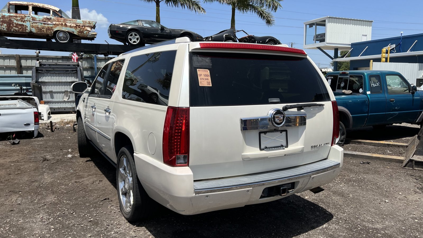

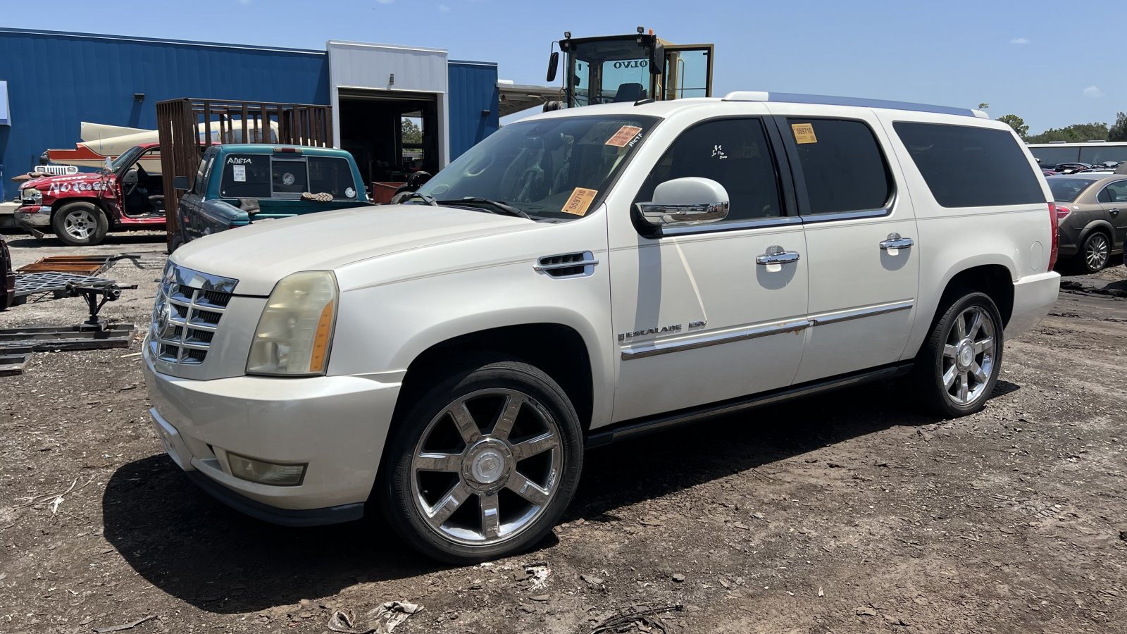

Maybe a 2/3 drop, upgrade the stock speakers and a nice drop down screen for my kid. I was told it was 2wd so I was going to bag it on 28’s but it’s awd and that’s a mess I just don’t want to even begin to get into

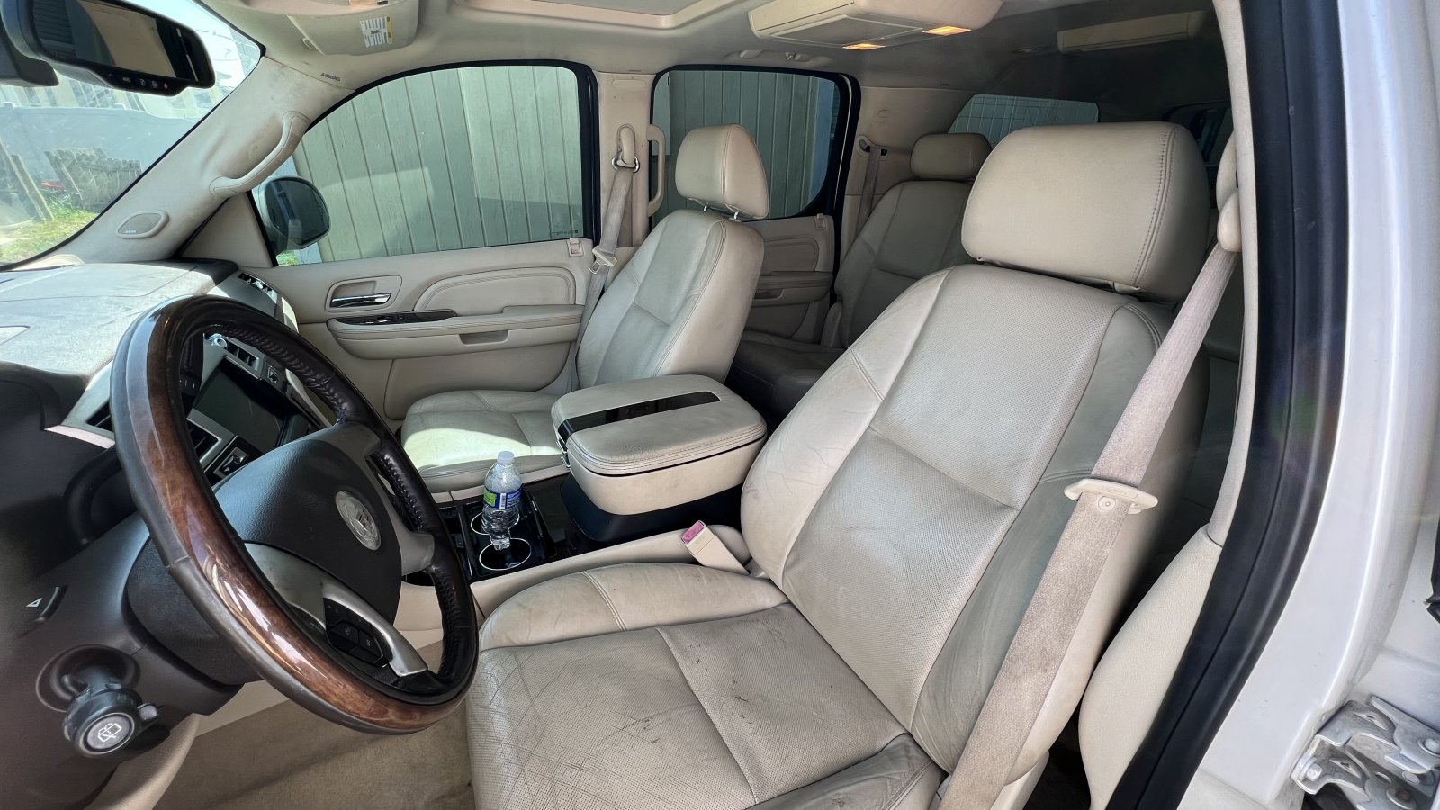

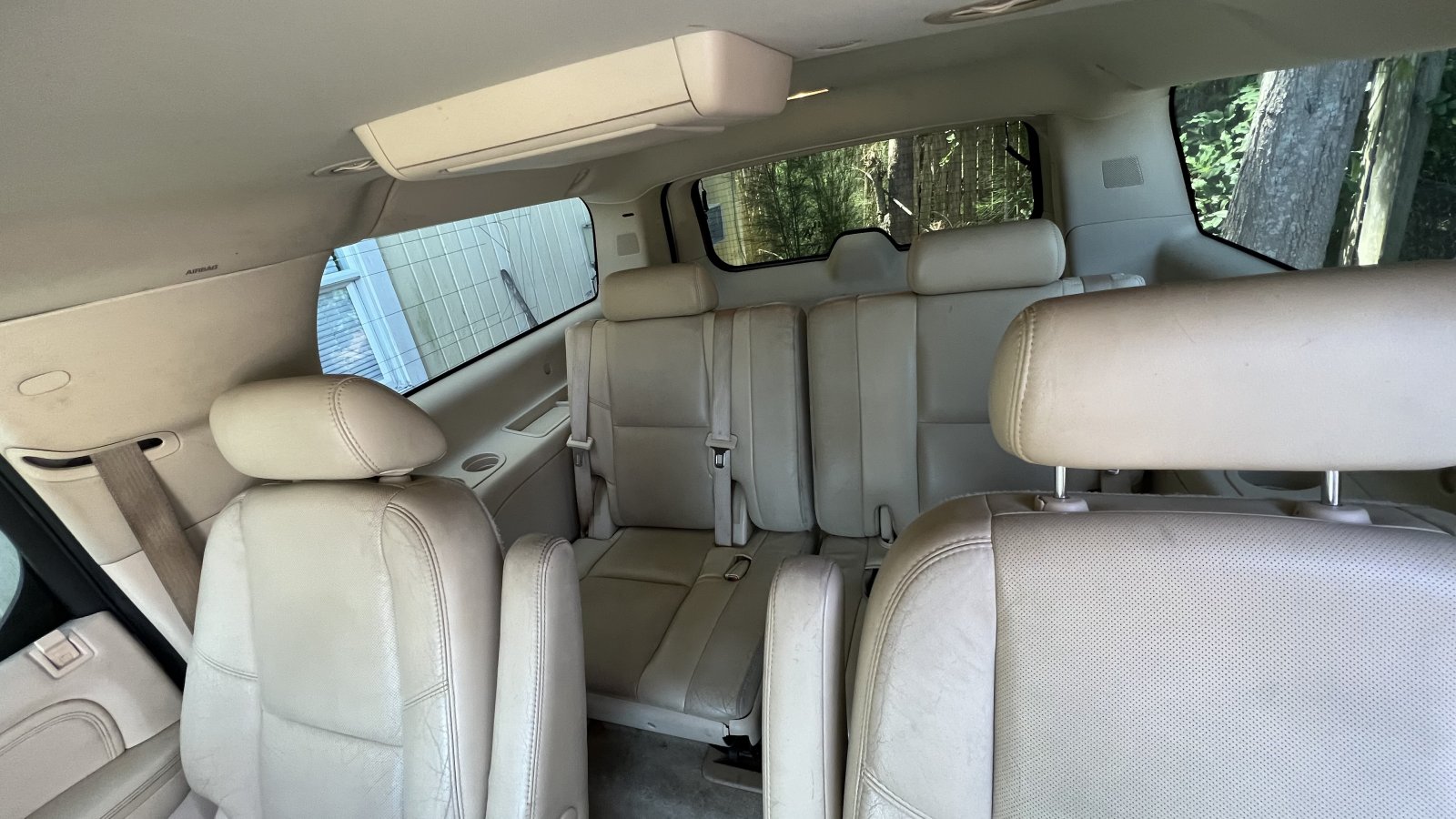

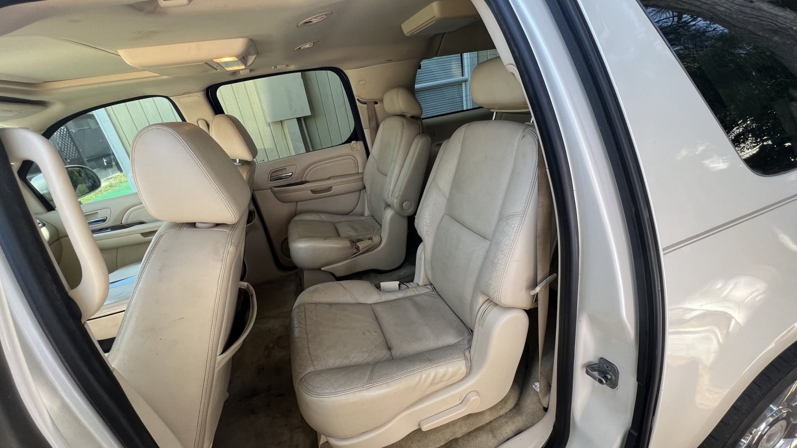

Whats the interior look like?
Filthy but no issues. Everything works

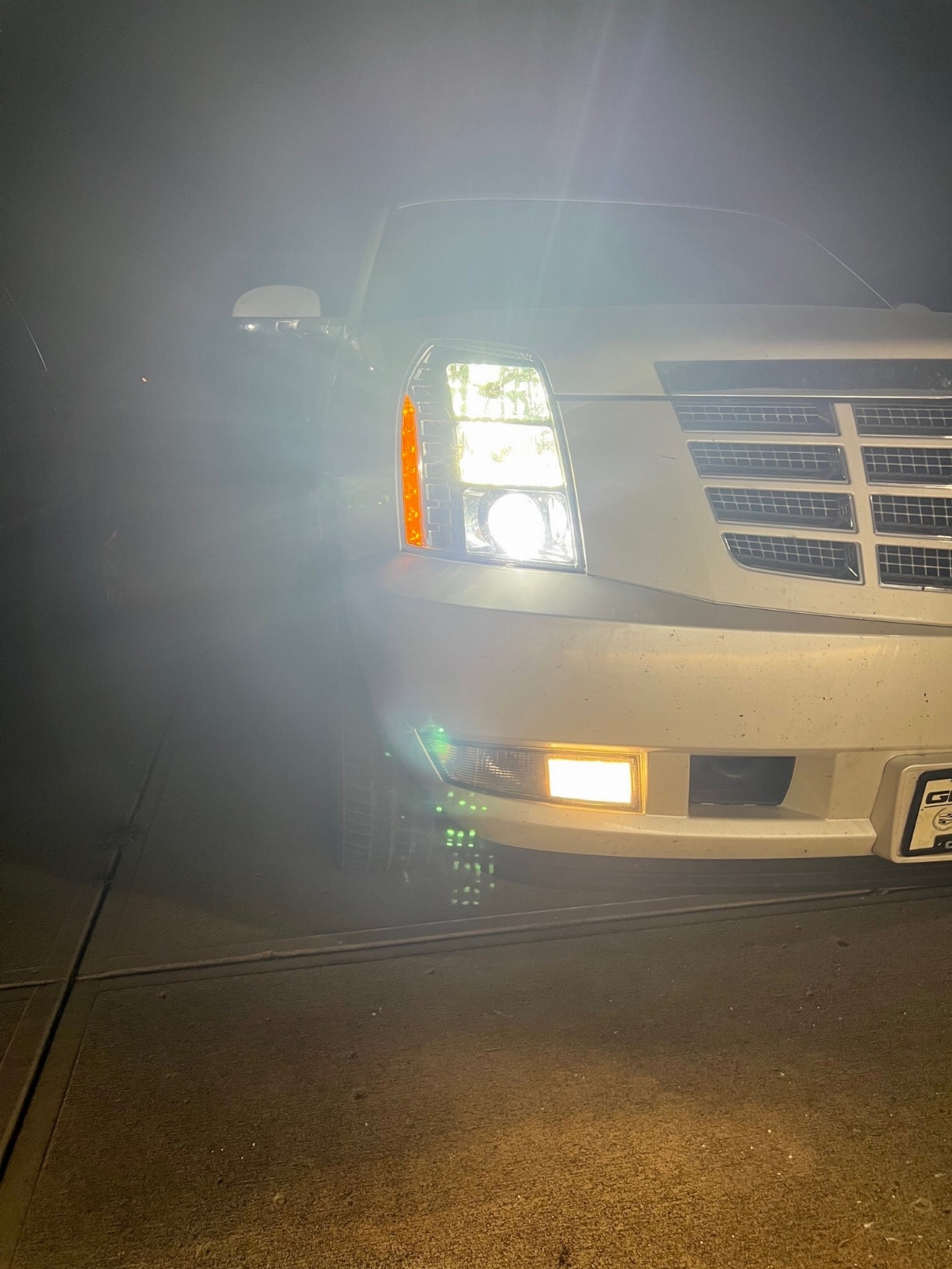

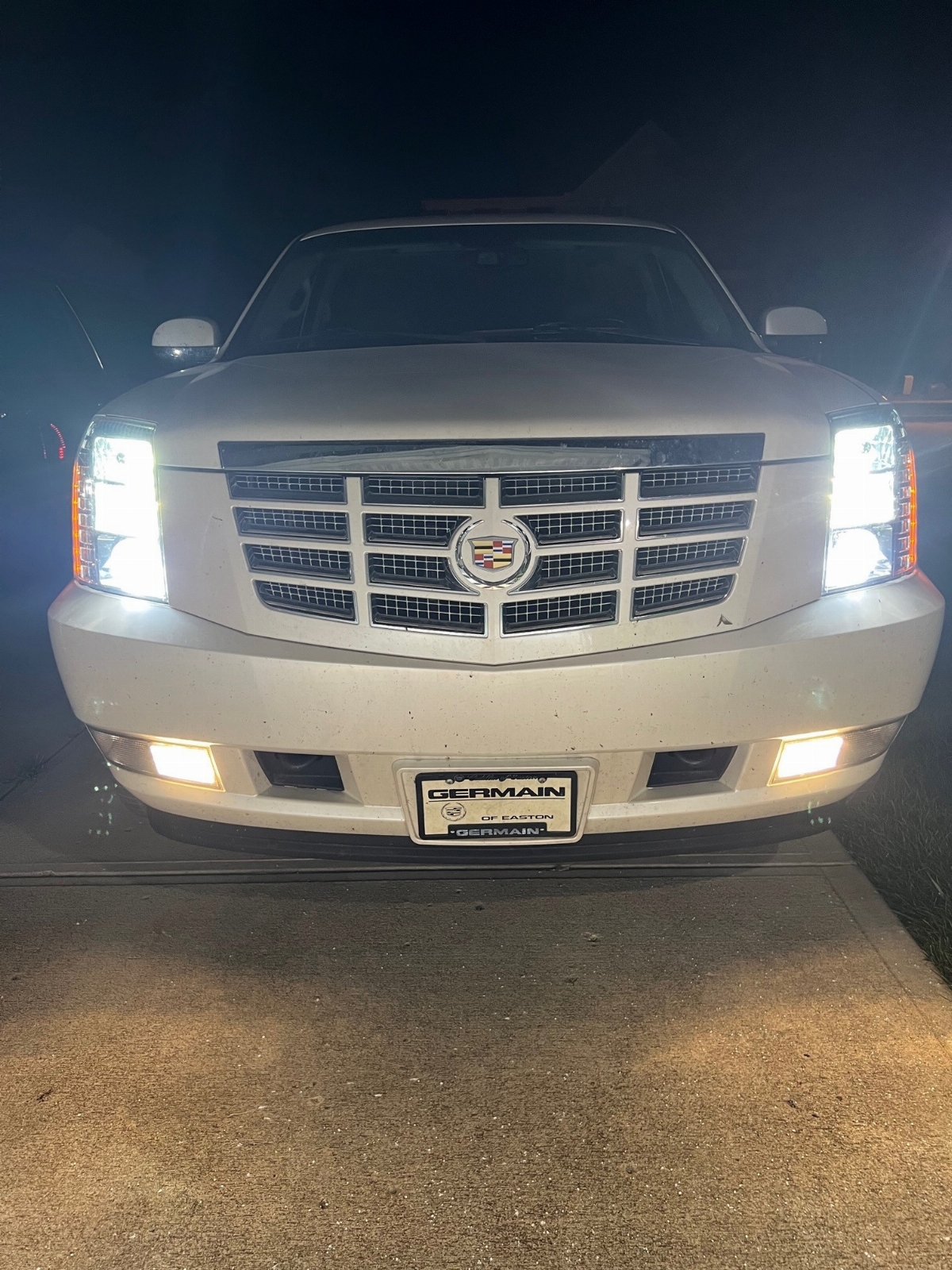

Been slowly doing some upgrades to the '13 ESV since that has now become my daily.
Did the diode mod in the fuse box so my DRL's stay on with my low beams and illuminate the entire headlight housing.
I've got 5000K LEDs in the DRL and parking light up top, and my OSRAM CBB HID bulbs are closer to 6K.
In the first pic you can see the difference in the light color, but in the last 2 they look closer to matching.
Contemplating swapping the parking and DRL LEDs out for 6K due to my OCD.
(I know my fogs are still stock halogens, that's changing soon...)
