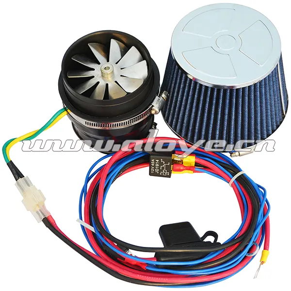

you laugh but I literally follow a electric supercharger message board lol.. guy has run 9s in a Ford LTD off one. things make crazy power per pound of boost because it's not run off the engine or restrict the exhaust.
the tech is catching up.

I think having a stand alone battery pack powering an electric blower for WOT scenarios makes total sense.

thats what they did.. it's a used vortec supercharger taken apart with an electric motor mounted to the impeller, a bank of LTO cells and it turns on at wide open throttle. but version 2 was going to use more common motors and stuff, Arduino controller for boost curve but he like everyone else decided tx was a good place to move to,has been completely robbed by contractor's trying to get a building built. there's basically no rules here and when they take your money and do crappy work, they just go out of business and change names. nothing you can do about it. so he's eaten about 100k in fixes out of pocket and set the project back 2 years. my wife's parents said it best when they moved here to be close to the grand kids, it's just feels like everyone here has their hand out taking your money for reasons you've never had to deal with before lol. it's definitely the wild wild west, as in your the stage coach getting robbed.

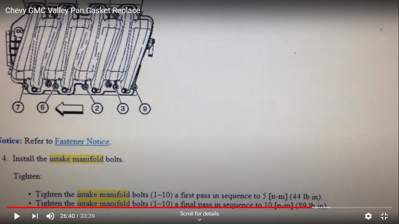

Out of curiosity, is there a replacement VLOM (valley lifter oil manifold) gasket, or does the entire part need to be replaced?
I'm still in "oil leak investigation" mode, and figure since I just replaced the intake manifold gaskets, and had it all apart, I should think about replacing the other parts .... Now that it's all back together.
:rolleyes:
I can't believe you left that VLOM in there. Did you at least snug up the loose bolts? See the red circles in this picture? They are some of the rivets that hold the solenoid carriage to the cover. The gasket is sandwiched between them. You will not be able to replace that gasket. Will need a new complete assembly.

Node of the bolts were loose. As far as I could tell the oil pressure sensor was leaking oil. I'm sure I couldn't get enough torque on it just reaching back there with no leverage when I swapped it out a little while ago. I stuck a camera back there the other day after driving it for a while and the back of the engine looked dry, so fingers crossed that's all it was.
